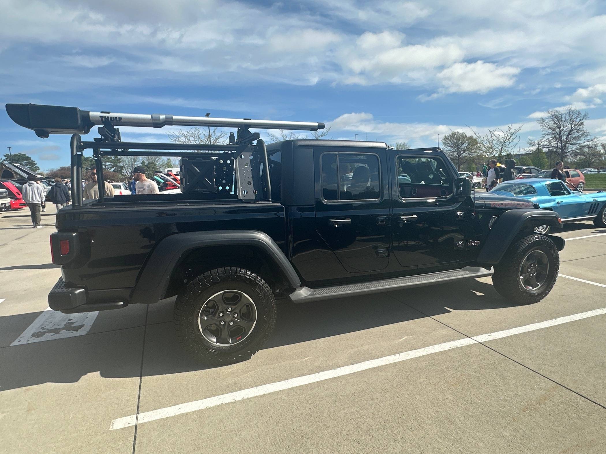

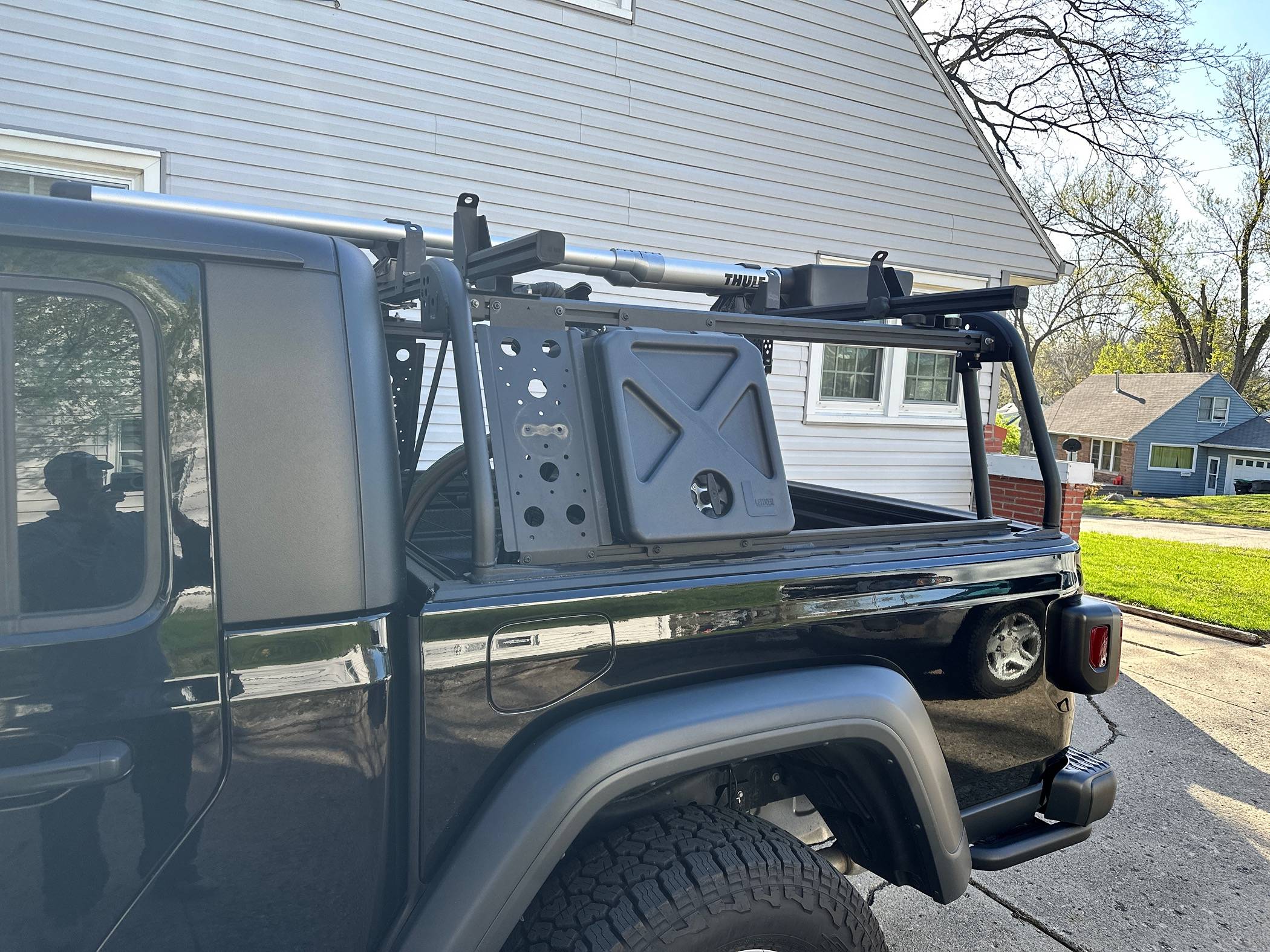

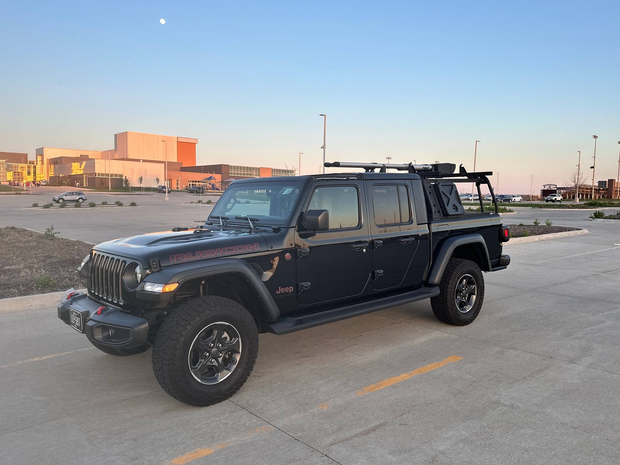

I have the original Leitner Designs (newer is the forged). I found it for $500 with the cans and the waterproof box used. It’s very solid, good finish. It’s not too tacticheezy. Pretty easy to remove once you know how. I have a fishing rod vault on it and it’s great for securing a bike.
This is fine for now for what I paid. Ultimately I want something that works with a bed cover but I’m not spending $4000. Many that work with bed covers look too tactical and cheapy or are much lower and I want a cab height rack. What I REALLY want is a bed cover and a roll/chase bar rack just up by the cab, but I haven’t found a solution for that yet.
Jeep Gladiator How good is your roof rack? IMG_9865
Jeep Gladiator How good is your roof rack? IMG_9802
Jeep Gladiator How good is your roof rack? IMG_9800
