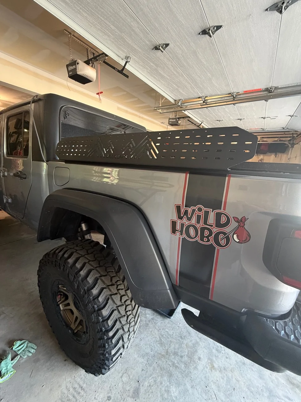

I don’t have my new to me beadlocks on yet, but I guess I can answer the -12 question. I have teralfex nomads currently at -12 and 4.25 backspacing. 8.5” wide. I have upgraded ball joints, but have for so long it would be tough to say. I replaced my unit bearings last year and they were toast. But I’m pretty sure they would have been anyway with 37’s and a decent lift. I don’t think -12 is that extreme.

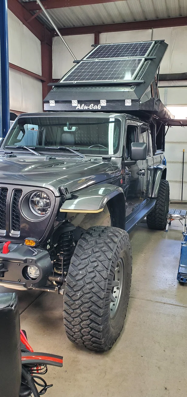

Sitting on Icon pro -6 no issues whatsoever stock on the bearing and ball joints. Not running big ass tires.
