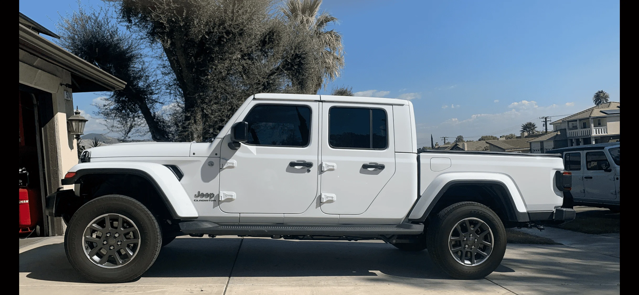

Jeep Gladiator How much needed to level front? 2022 JTR 6A37E837-B897-422C-843C-D25771070FFE
2.5” spacer up front, nothing in the rear. I bought the 3/4” spacer for the rear but did not use it. Once you add your winch and whatnot up front you’ll likely be right around half inch of rake. The 2.5” was pretty level but you’ve got taller fenders than my overland so it may appear to be higher.
