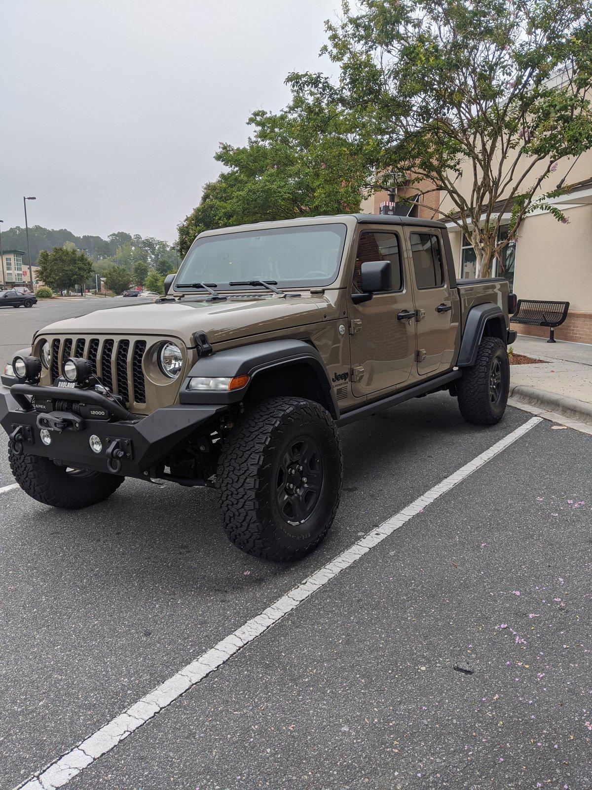

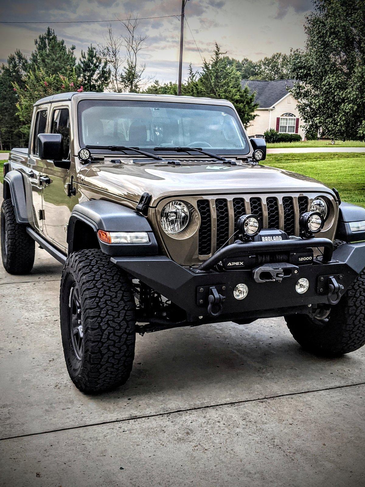

I'm running ReadyLift SST 2.5" kit which gave me 2.5" in the front and 2" I'm the rear. I got a Max tow so I got the stouter springs in the rear. I added Rubicon springs to the front which took all but a 1/4" of rack out of it so it sits 1/4" higher in the rear. Also added Rubicon take off Fox shocks. To me that's the best way to do it. Rides better than stock and still gives you the stiffness you need in the rear to keep it from squatting
