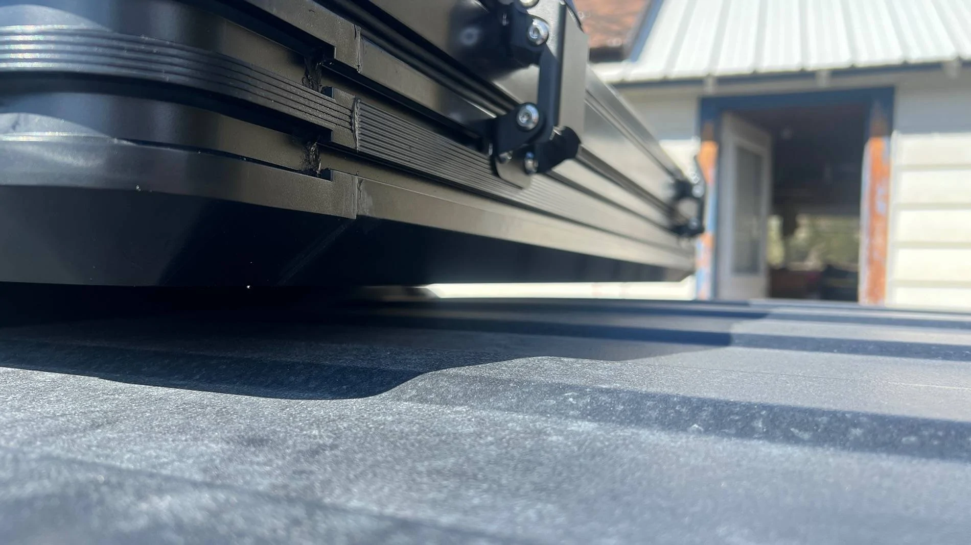

I had about 3/4 of an inch on mine and never had any contact.
