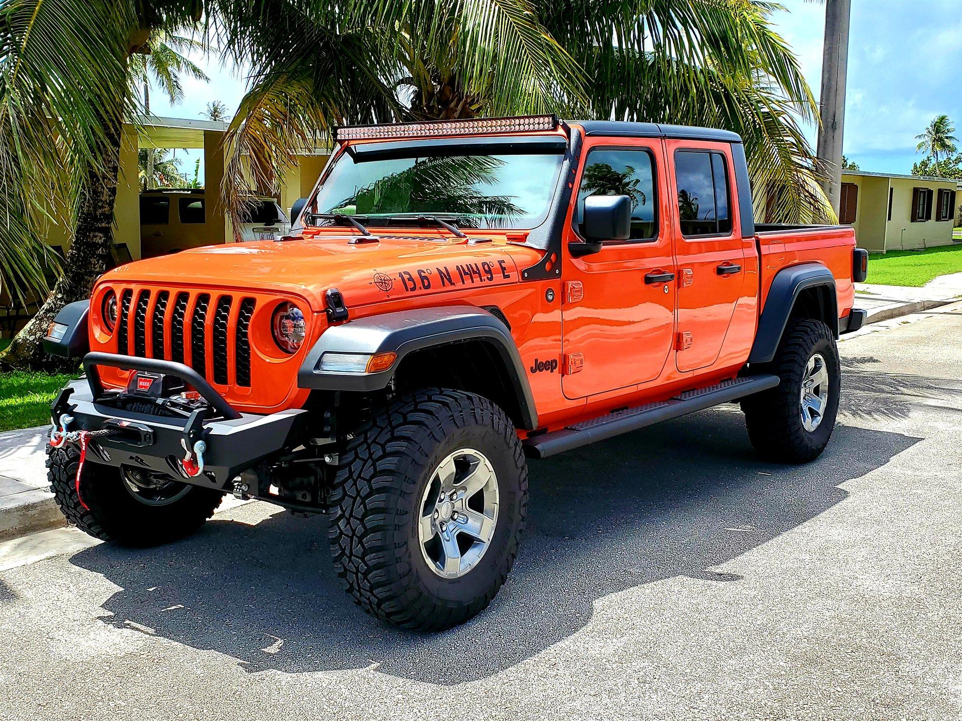

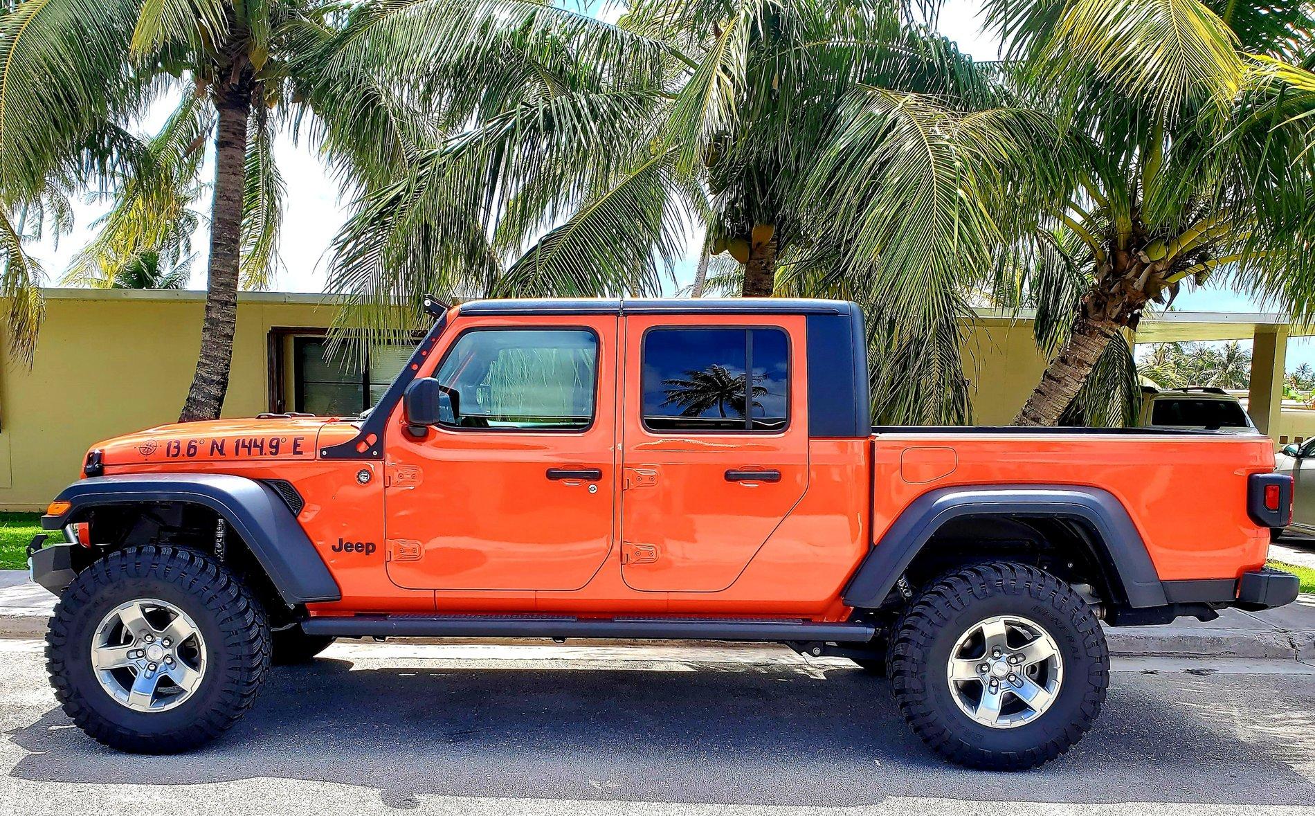

My sport got 2.5 inches from the mopar but settled down to 2.25. I added a 3/4 inch daystar spacer to bring it back level. So I esentially have a 3 inch lift kit.
