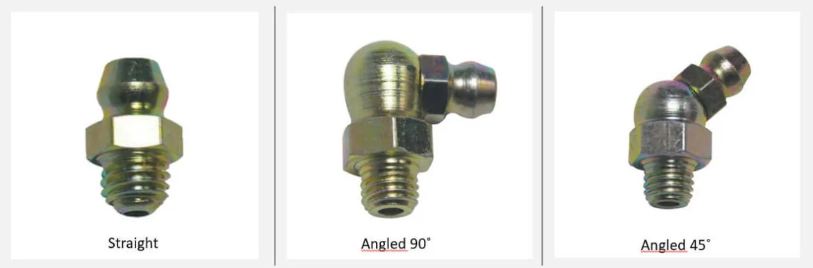

I’ve got the RPM 2.5 ton drag link/tie-rod and went to grease today and am at a loss for how to grease the drag link boot. It’s directly above the tie-rod end and my 90* grease gun fitting doesn’t fit.
I found the boot has 2 holes and I’ve ordered a new one but for future reference

As suggested, remove the straight grease fitting and screw in a 90° or 45° angled fitting.

Awesome! Thanks guys. I did not know those existed. Learning a TON by doing mostly my own work on my first Jeep. This forum is a god send
