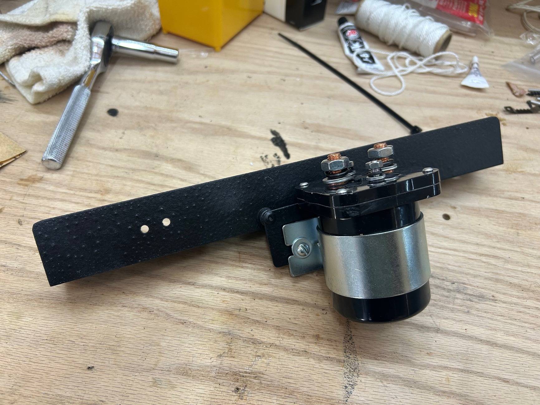

Completed the under hood electric prep for the new winch and thought I'd share my installation for others. I wasn't at all interested in a manual rotary switch that would require me to unlock and open the hood so I decided to go this route using a 500 amp relay and one of the factory aux switches. The 500A relay was purchased on Amazon and there were several options under $40.

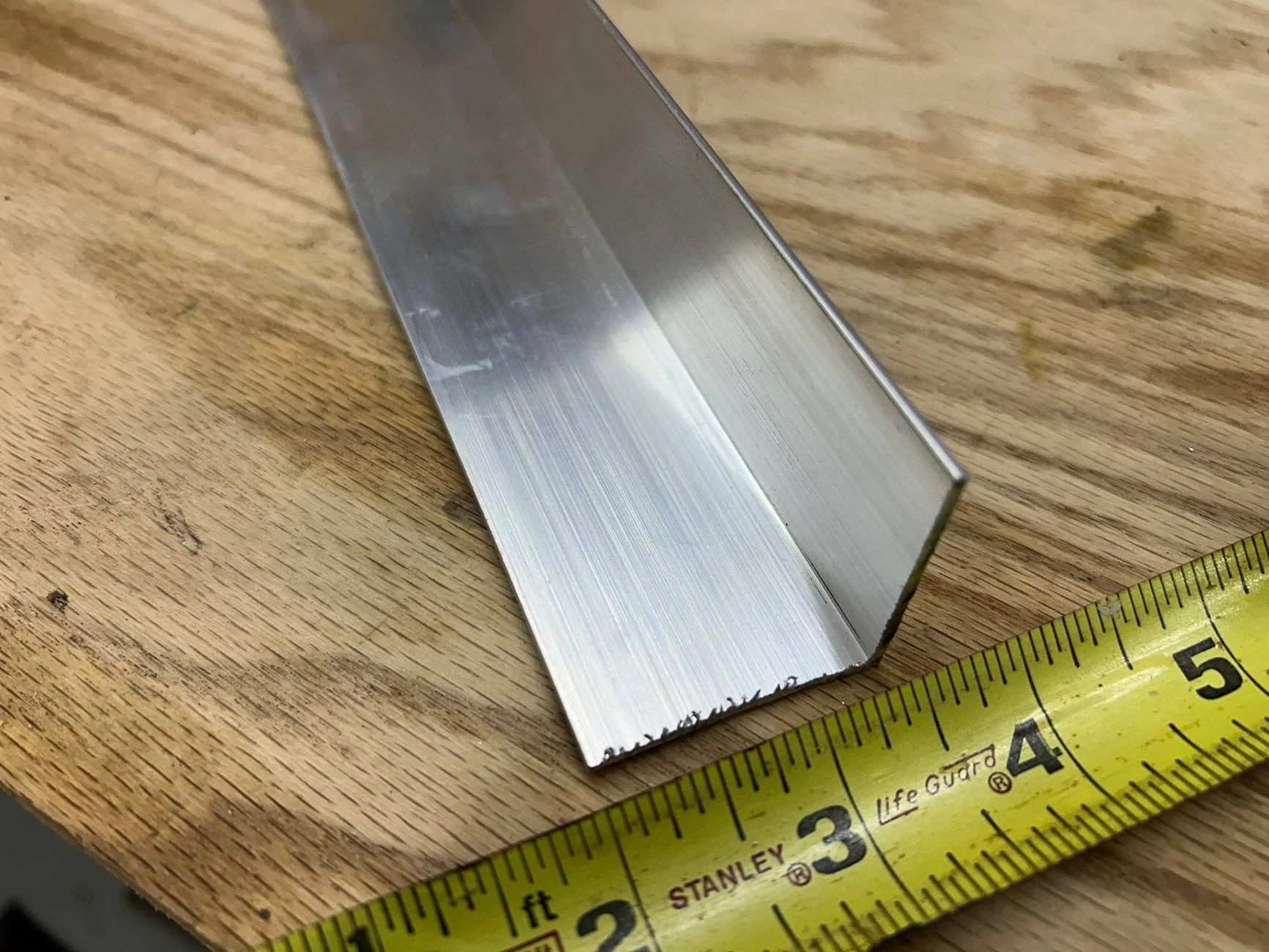

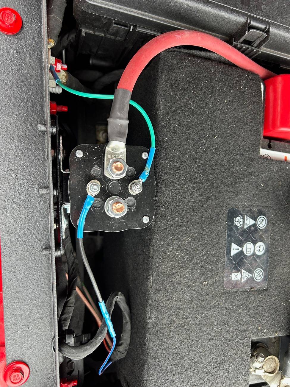

I began with a piece of 1-1/2" aluminum angle from Lowes that was made into a bracket using some rivets and washers. After getting the shape I wanted it was sprayed with some black Flex Seal I had in the shop giving it a finished look. It was sized to fit next to the main battery and is secured using the two factory bolts shown. The relay is shown bolted to a small drop down off the main bracket so that it is positioned a little lower in the engine compartment ensuring that the hood would close without any clearance issues. The relay was connected to the main battery with an 18" #2AWG preassembled cable also sourced on Amazon. The 2 drilled holes left of the relay are used to secure the four aux switch leads with a cable tie.

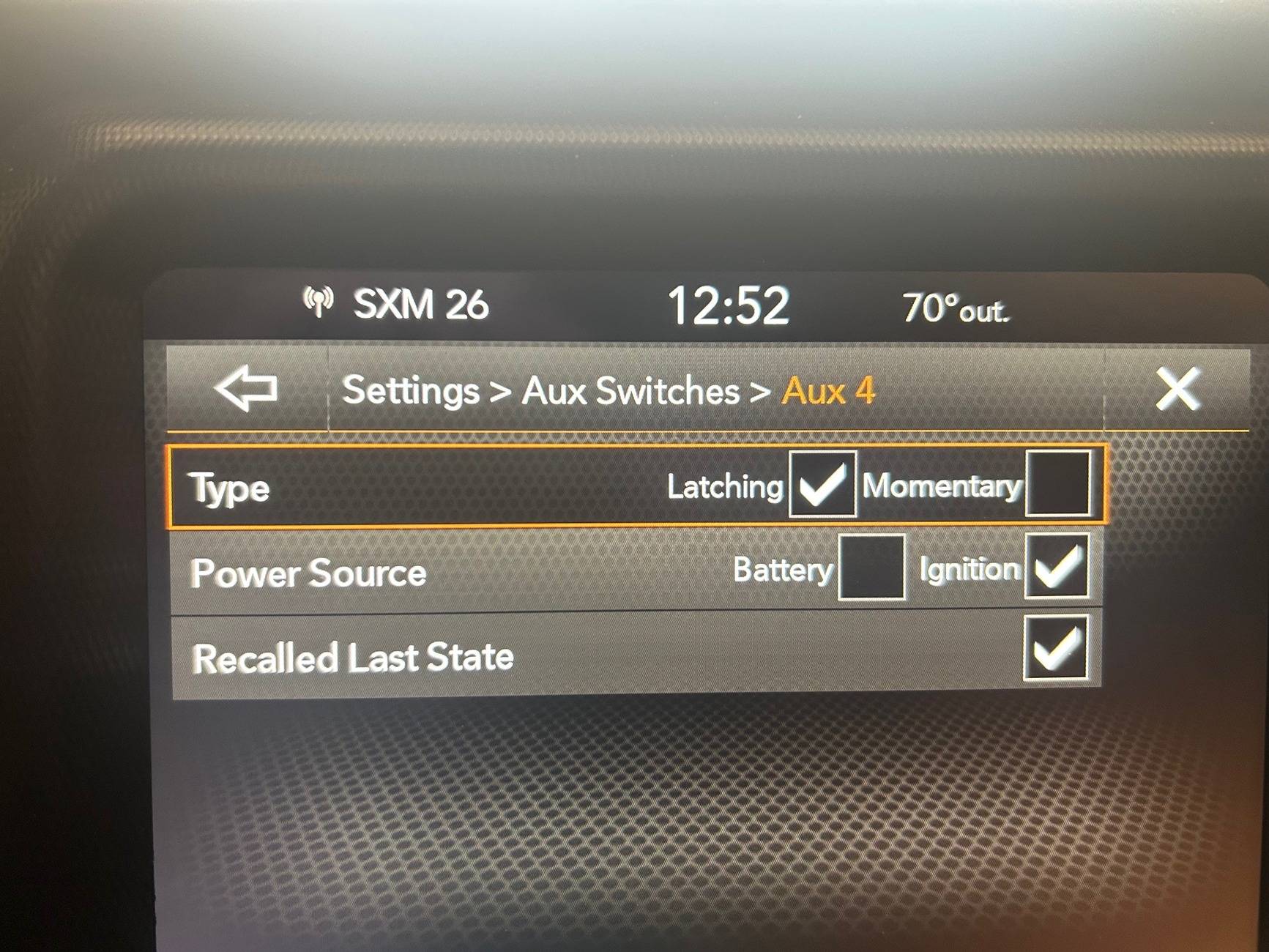

It's connected it to the #4 aux switch. The relay is "electrically held" (ie: latched) meaning as long as the aux switch is "on" the coil in the relay is energized and closes the relay thus allowing power to flow through the device. When you are done operating the winch the aux switch should then be turned off. Switch settings are shown.

Jeep Gladiator How To Install A Battery Relay Switch Alum angl
Jeep Gladiator How To Install A Battery Relay Switch Completed bracket
Jeep Gladiator How To Install A Battery Relay Switch Installed bracket
Jeep Gladiator How To Install A Battery Relay Switch Switch settin

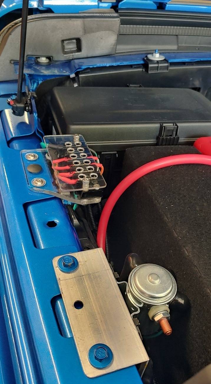

Very nice work! I was thinking of doing something similar but I have my Voswitch box where you mounted the relay. Thanks for all the details!

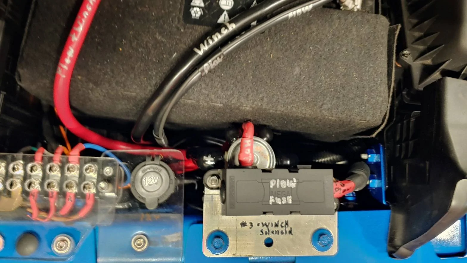

Well done. Similar to how I did mine with the Warn solenoid switch. Also run by aux switch. And my switch settings match yours.
Which solenoid switch did you go with? Considering upgrading since I would be stripping my 2022 and starting all over with a 2025. I tend to keep making changes and improvements as I go - always have done things that way. I keep seeing ideas (like yours) and things I could do better "next time".
Anyway - nice.

Yes, mine is similar to yours. I placed it about 4" closer to the cab on the same type of fender mount.

Blade1668
Darrell
Jan 7, 2020
3,275
3,162
N. AL.
The Warn relays last a long time too even in harsh use. One that was in my XJ worked for about 15 years or so. It was exposed to swamp water brackish water, and snow and ice too. But did give up due to corrosion. I replaced with another one and used same type in my JT and aux switched. Same mounting method as you and "ShadowPapa"
