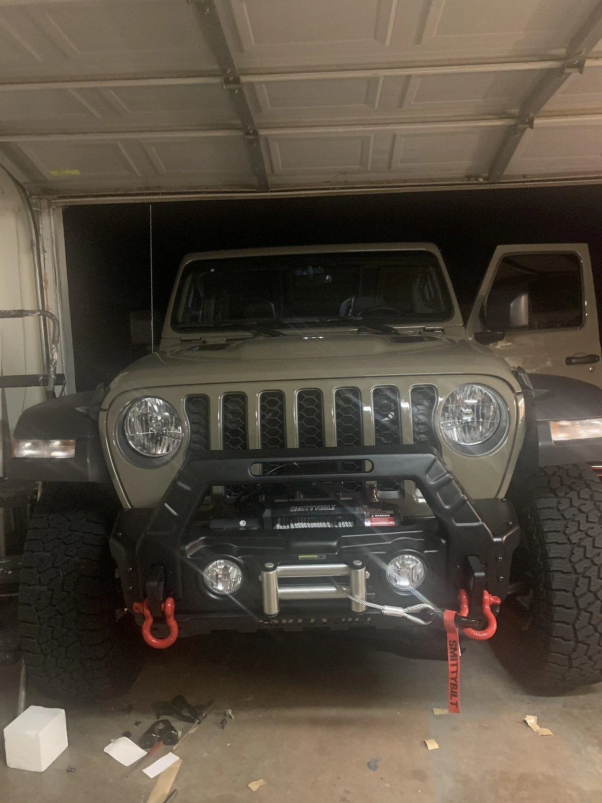

Winch took about an hour for me, the bumper on the other hand took 6.....Smittybilt decided I didn’t need instructions with my bumper that has a bag full of different length hardware and random brackets.....

That's about how much total time I spent installing mine. It was also the first winch I'd done solo but on an aftermarket winch ready bumper. Mine was 4 to 5 hours for the initial install then a couple of hours a month later to clean up the wiring.
