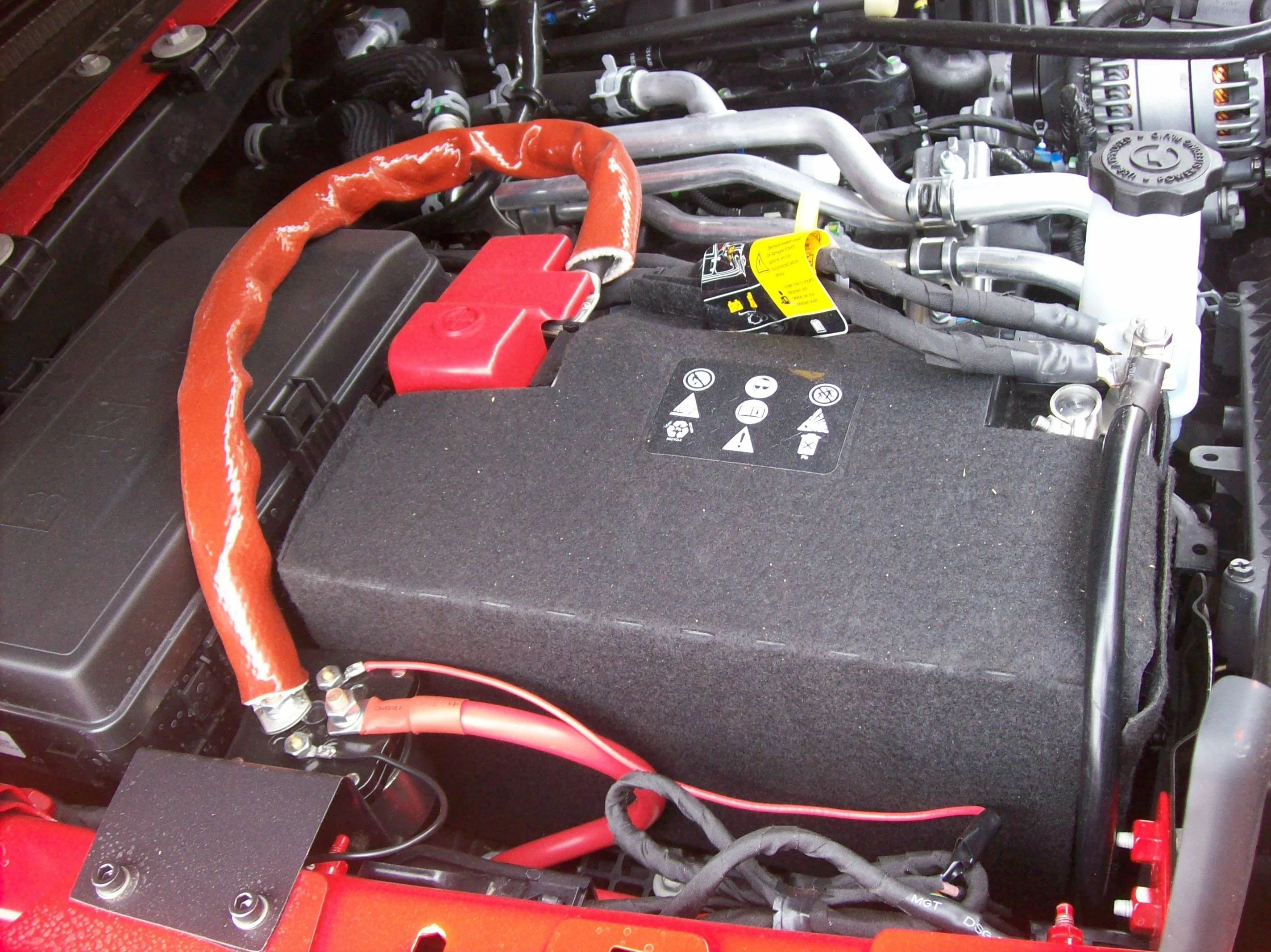

So, maybe I have a bit of another perspective on this one with WHY I did mine the way it is. First, I have a good bit of experience in DC wiring and high amp draw from marine and RV diesel work- as well as more sensitive electronic harness design etc. I actually own the Warn kit and think it is great quality, and I have an available circuit on my OEM aux switches to activate it... But I am wired straight to the battery. Why? The OEM install instructions shows it what way, and is the official process approved by them- in the event of any problems while I am under warranty for the vehicle is not a factor in their dispute of warranty claims. I did however put an additional shield over the Warn cables with aircraft fire sleeve to ensure it would never chafe or get pinched in an accident. Pretty easy to do and inexpensive. Aircraftspruce.com But- once my warranty is up, I may install a disconnect or a high amp marine breaker.

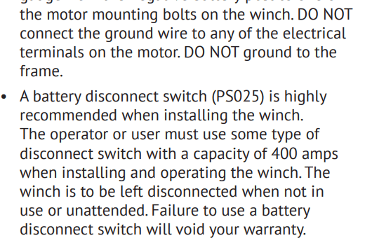

I just prefer the peace of mind, the safety, of having no power up there. Too many Jeeps have burned as it is, and in event of an accident, unless you have a cable in steel, the forces making things go crunch, jam against each other, the edges of steel bumpers and other things, some of the stuff that got towed into the shop where I worked, and the vehicles where I had to repair burned wiring, and the fact Warn sells solenoids......... and then there's this tidbit I found for a truck winch -
Jeep Gladiator Winch battery disconnect switch, to install it, or not to install it... winch-warranty

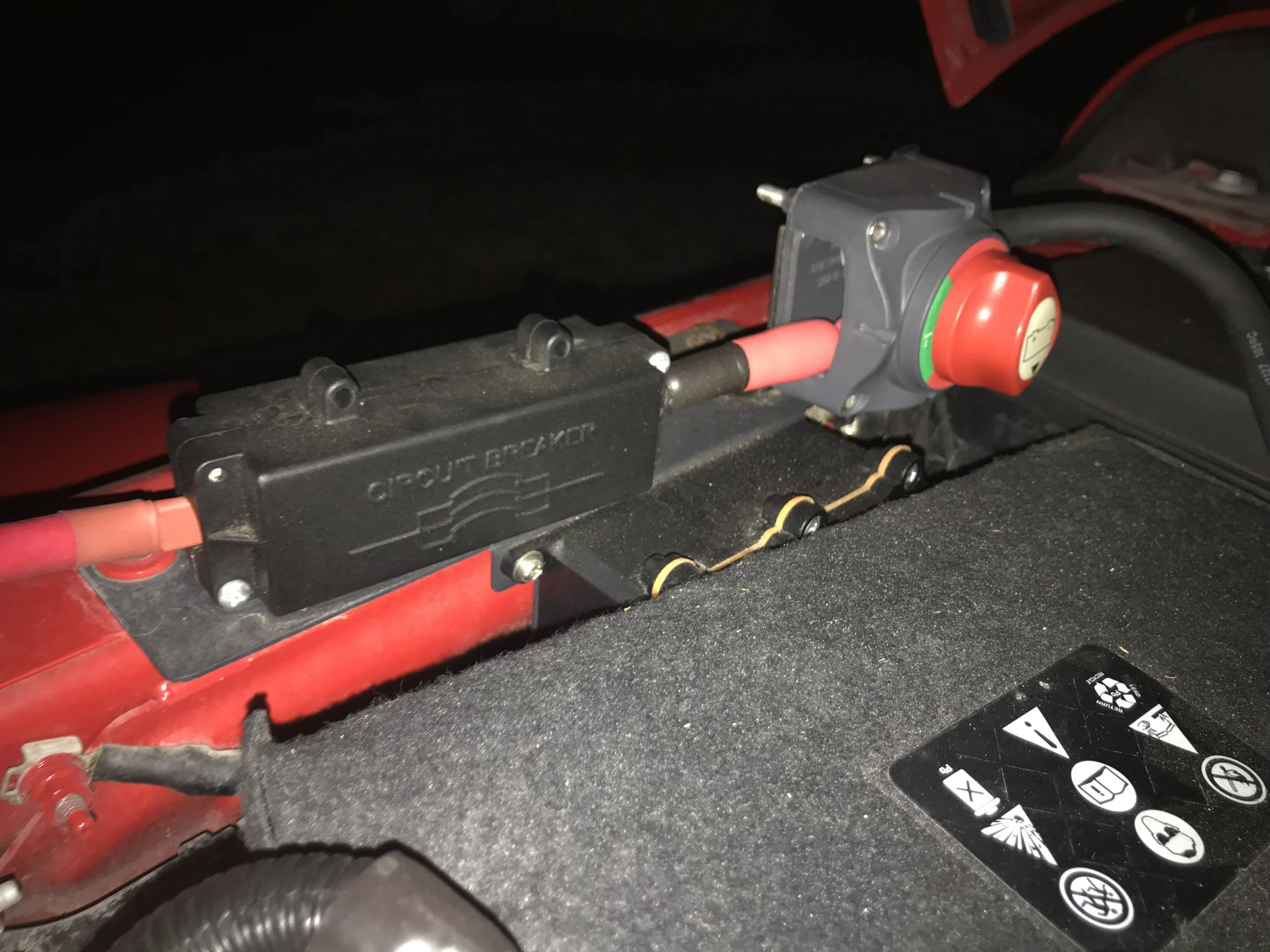

Mine has a disconnect AND circuit breaker. With a circuit breaker close to the battery you could put the disconnect on the bumper I would think.
Jeep Gladiator Winch battery disconnect switch, to install it, or not to install it... 28C13EE4-5954-4499-8ED5-9C5D17537EF4
Nice, what are the specs on the circuit breaker and any links to it?
