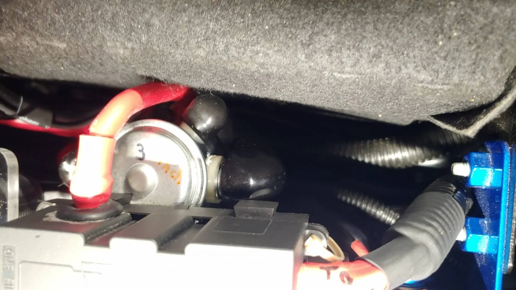

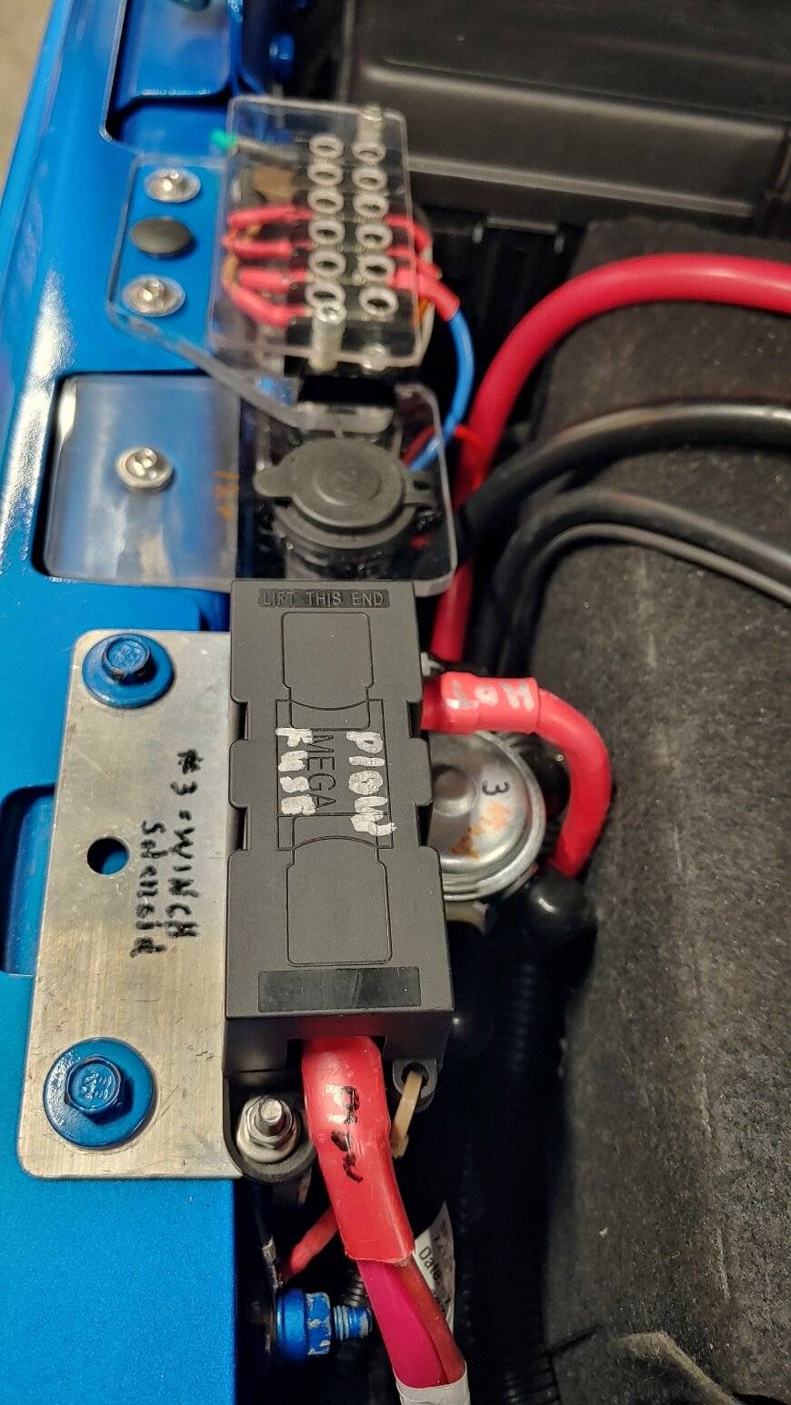

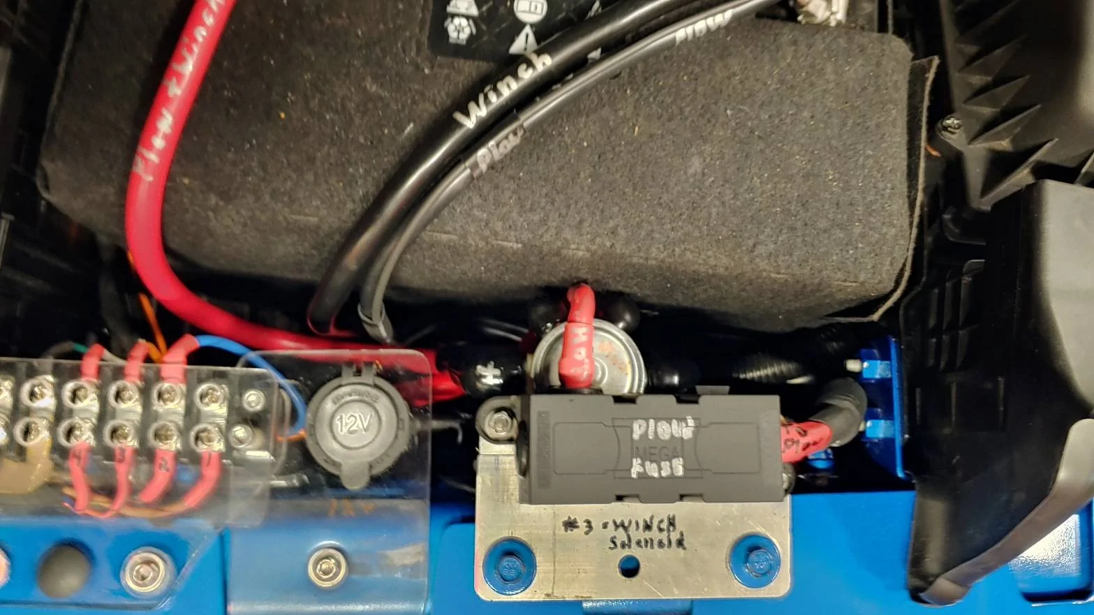

Yeah, I know exactly what it is and how it works - already "got the point" as to what it was and how it worked (electric is my thing) - I was just wondering why such a complex device when all you need to do is break the hot cable to the winch up front.
So you'll only use two of the posts - one from battery to that device, another post for from that device to the winch. 0 need to break ground. Besides, some winches ground through the winch body so you technically can't break the ground.
That's basically just an electric switch that reverses polarity coming out to reverse the winch motor if it was installed for winch control.
So it can still be a simple "on/off" switch, but when "off" in your case, the other terminal will be hot.
I am not sure what you are trying to say here. There are similar solenoids that only have a single polarity. When using this in a single polarity configuration, only the input positive connection will be hot, until whatever connected switch is placed in the on position. When switched to on, the positive input will short to one of two posts, depending on whether it is the "in" or "out" switch post that is activated. When the switch is off, no post other then the input from the battery will be hot.
Because I plan to isolate the battery completely(positive and negative) two of the posts will never see positive at all. This is accomplished by simply using only one switch post on the solenoid. This doesn't work as a toggle. You have to activate "in" or "out" using separate switch posts on the solenoid. If nether is active, the battery is isolated from the output of the solenoid.

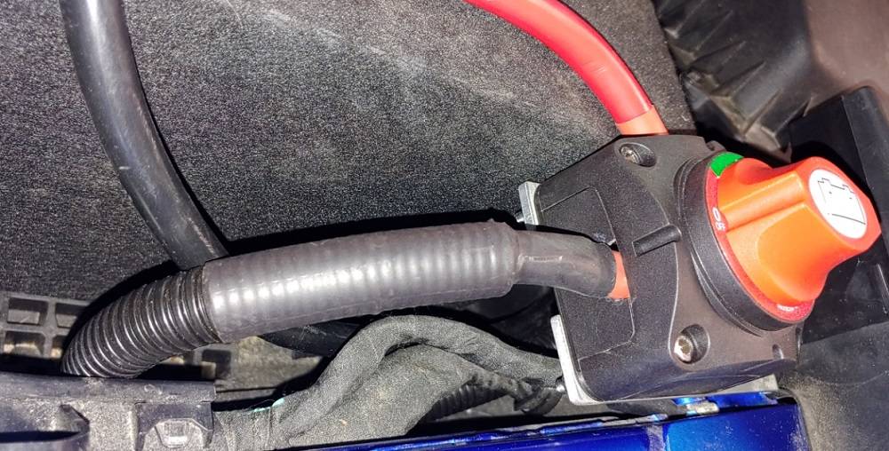

Where are you mounting the switch, just curious ?
BringTheLightnin
BringTheLightnin
Logan
Jan 6, 2023
183
129
Greensboro, NC
Jeep Gladiator Sport
When you say standard, you must understand that we had glass fuses as a standard then smaller glass fuses, then ATC, mini and micro. European standard had ceramic inserts before the glass type. I know there is an old guy watching who can give more details than I.
Lol yes I know but as far as I remember there were mini. I didn't know micro 2 was actually a thing until today. I've looked in that box plenty of times and never even noticed they were smaller.
I did a temporary solution. I slid it under a screw on the airbox for now until I get some mounting brackets. I didn't even think of it at the time.
