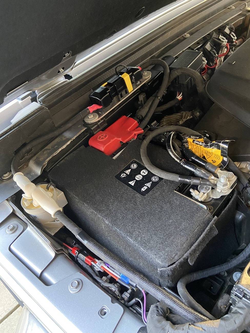

A disconnecting mean isn't required. Factory installed winches utilize conductor sizing as a short/overcurrent protections hence most comes with #2 conductor. Also a cost saving move as well as a high quality 500a contactor can cost up to $150.
Switched contactor is a convenient feature for me, as I'm using a single Aux switch and contactor to provides power to the winch and a #8 circuit SAE outlet at the front bumper to run a portable air compressor. I also charge my batteries via that same SAE port. With the Tire Fill Alert feature, i can also switch on/off my compressor from inside the cab, all without having to open the hood.
Old photo below is before i added an SAE oulet to the contactor. A waterproof 500A fuse block to a TE 500A (continuous) contactor, than to winch.
