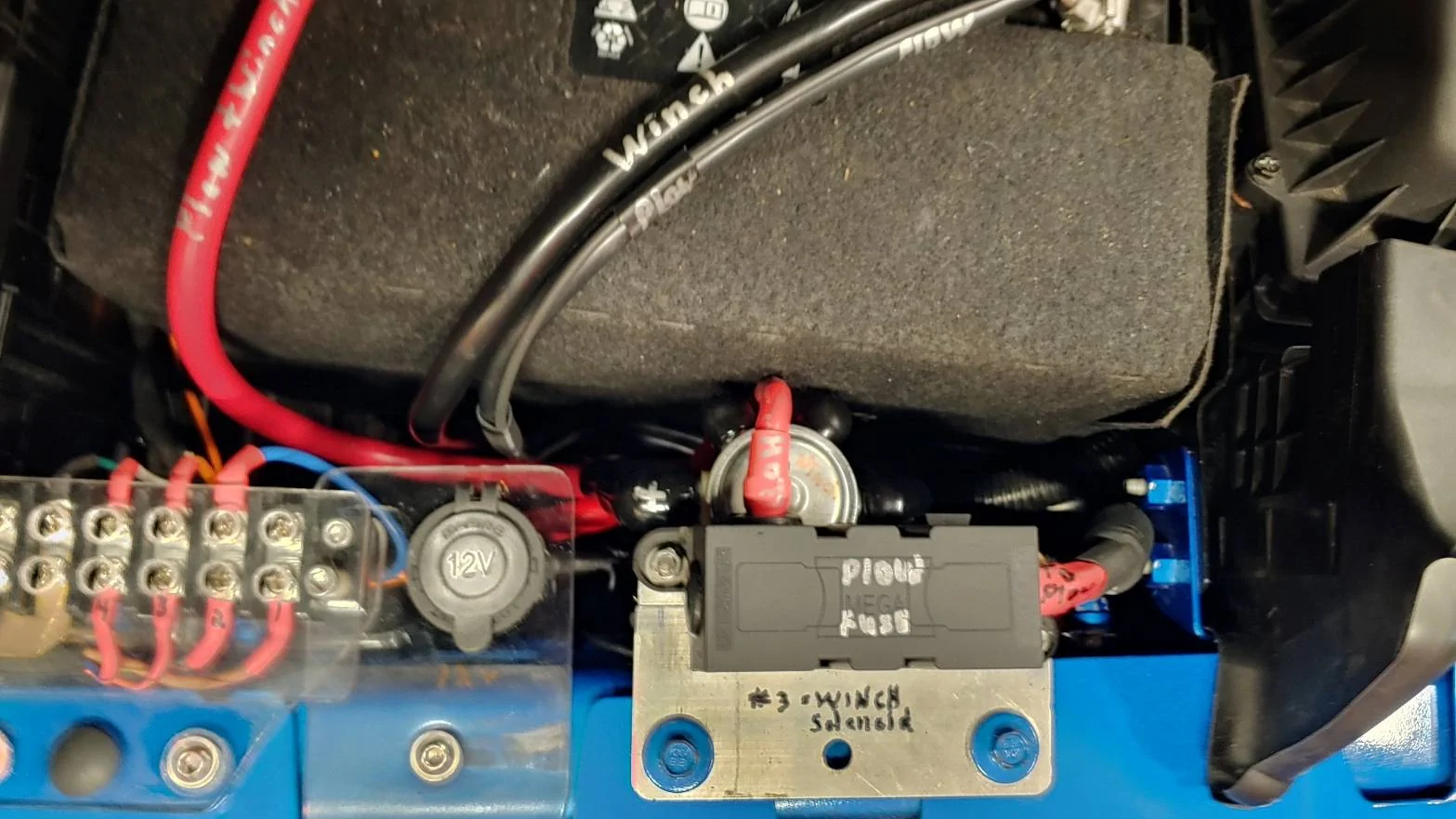

Jeep Gladiator Winch battery disconnect and circuit breaker? 20221109_160554_HDR
There's a lot of impact and accident types. Nothing will ever be 100%, but if it handles even some of the possibilities............

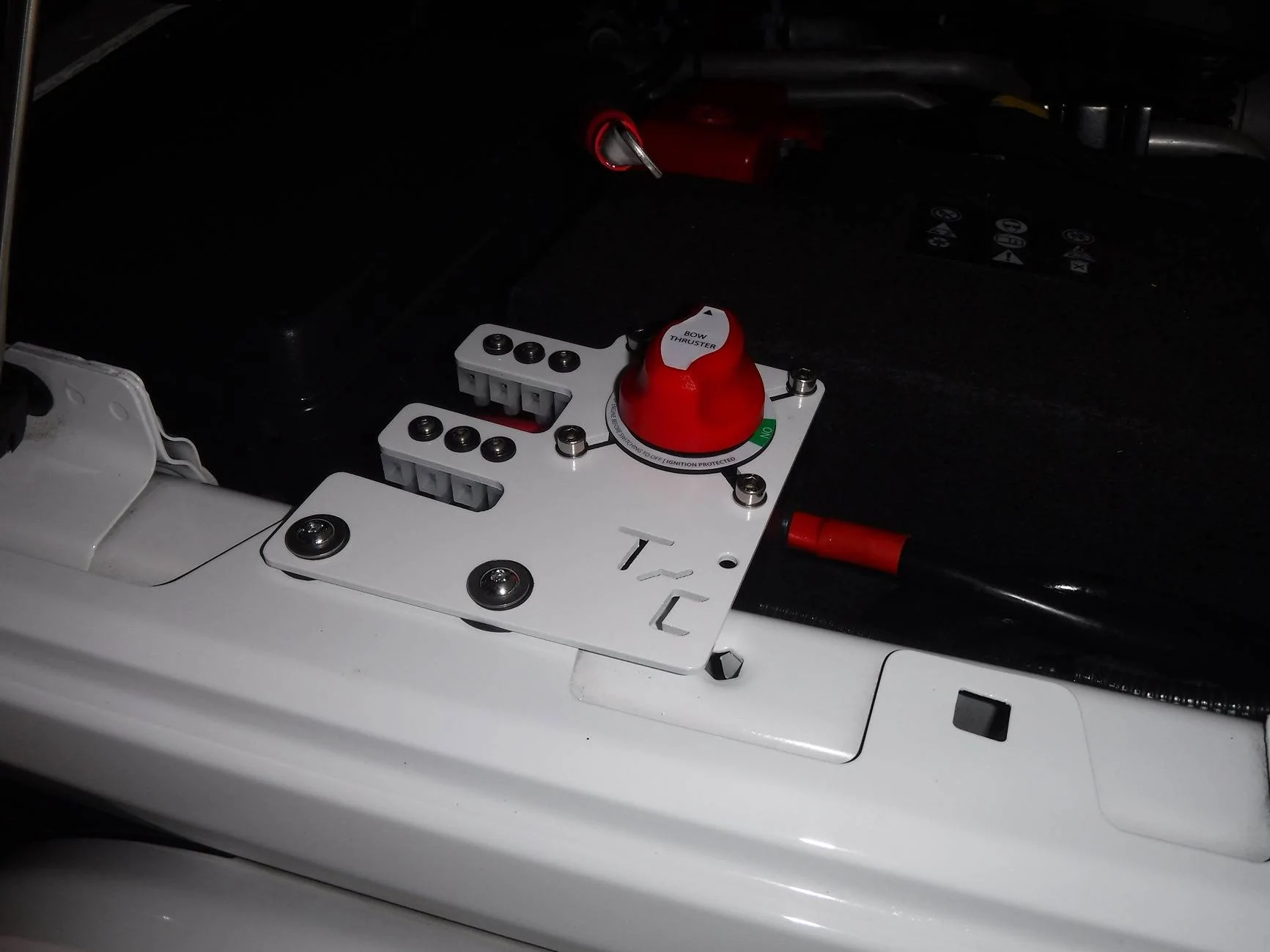

That looks great. Would you mind sharing the source for the mounting plate and parts? I appreciate it. That’s exactly what I am looking for.
Thanks. I purchased the switch and terminals on Amazon. Search for "Battery Disconnect Master Cutoff Switch" to get several similar switches (about $15 ea.). The breaker was included with my winch. I fabricated the mounting plate from some scraps cut from a plastic bumper. I've seen several online; Google search for "jeep jl winch disconnect switch mounting bracket".
Also, (for anyone questioning the double protection) another reason, beyond safety for the cutoff switch is battery drain. My which has a wireless controller, so it always (when connected) is using some power listening for the controller.

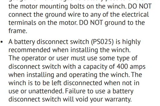

And yet there are winch makers who say you must use a switch, and several not only sell them, but some include them.
Wow. A guy asked about a switch and suddenly he's a bubble boy and doing it all wrong because you don't believe in them.
Since he was asking about a switch, maybe he wants to use one.
Those of us who have, can show solid examples.
And there's no real downside to a switch. Point of failure? The whole truck is full of points of failure.
How many reports have there been of their cutoff switch failing?
I'll repost for a point - apparently at least one winch company is run by bubble boys -
That clearly says recommended not required, and calling hard wiring winches a "faulty install" is where the insults started? Like I said if it makes you feel better run all the fuses and switches you want. Most don't recommend a disconnect at all and I've yet to see 1 that recommends an ocp device as they all understand that if it will flow enough current for a 400A+ hard pull it will flow the max CCA long enough that it isn't actually protecting anything.
Thanks!
