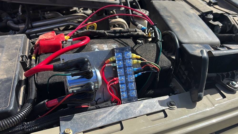

I run a similar set up to others using the Warn Isolator (on the left in foreground):
Jeep Gladiator Winch battery disconnect switch, to install it, or not to install it... 02_UnderHoodAuxSwitchTerminals.JPG

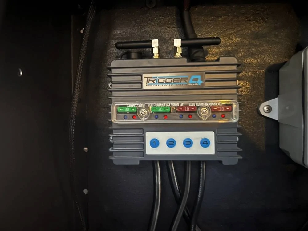

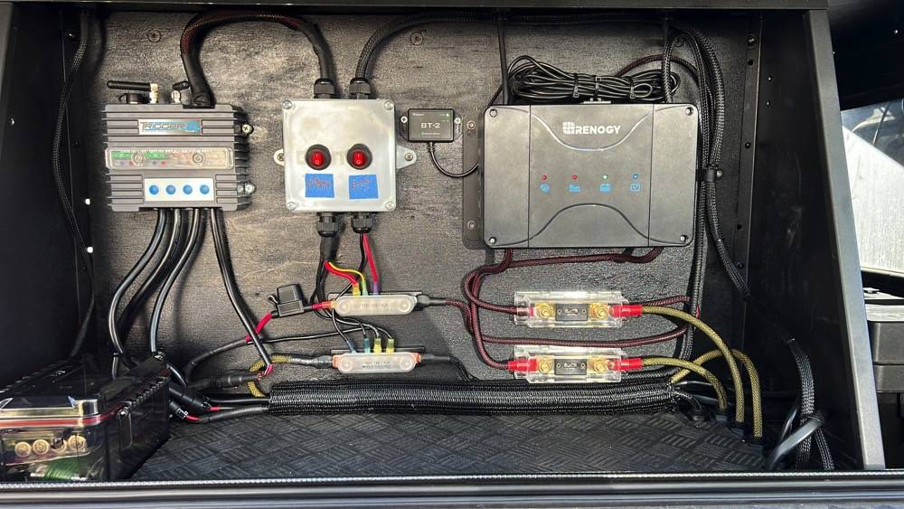

Lot's of good switch boxes out there. I use the Trigger 4Plus Controller on one of my JKUR's for the winch, light bar, rock lights and under hood lights. My JTR has the factory Aux Switches but I DO use a Trigger 4Plus Controller to run the house loads in the bed (left side of pic):
Jeep Gladiator Winch battery disconnect switch, to install it, or not to install it... 15_HouseElectricalPanel_1
Jeep Gladiator Winch battery disconnect switch, to install it, or not to install it... 16_Trigger4PlusController
What I really like about these units (and others may be this way but I don't own "others"), is that there are 3 ways to activate an accessory that is connected to it:
1) Push the blue 1, 2, 3, 4 button on the front of the controller
2) Use the RF remote that comes with the Trigger Controller

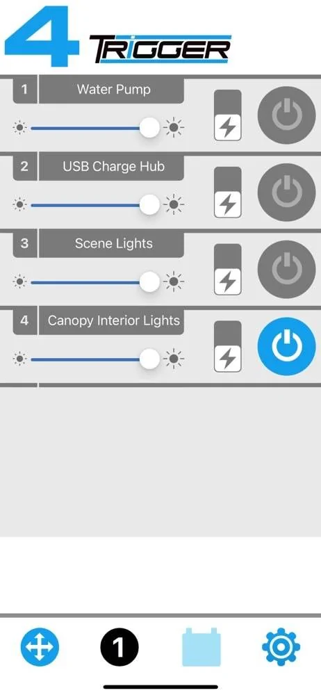

3) Use the App on my smartphone:
Jeep Gladiator Winch battery disconnect switch, to install it, or not to install it... TriggerPhoneA
Lots of options out there, but take a moment now and see if you can future proof some of your spending (i.e. avoid buying a disconnect now only to buy a solenoid isolator later). Food for thought.

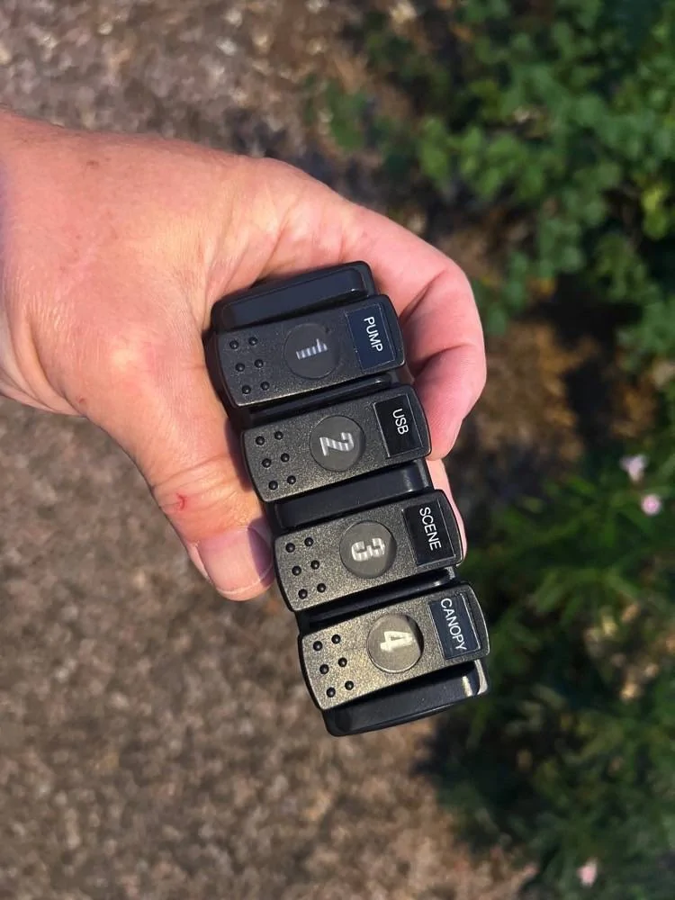

I connected it to Aux 1. It was the first thing I connected to the Aux switches, so I chose it because it was easy to remember.

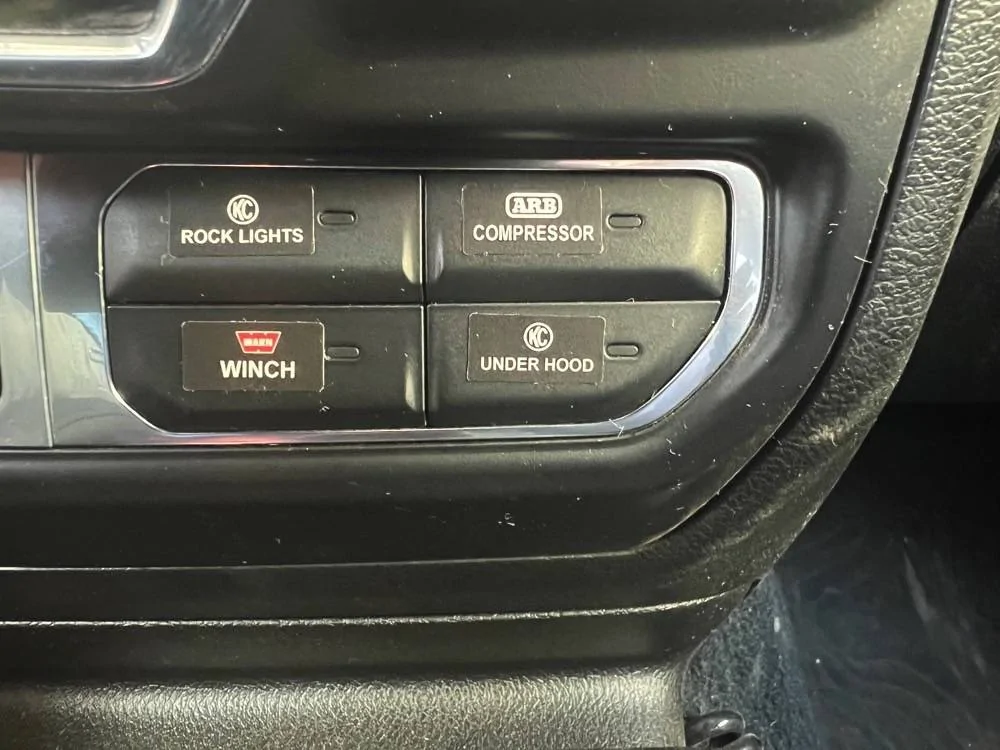

I struggled with remembering what was on each Aux Switch but @pixeldecals had a nice solution:
Jeep Gladiator Winch battery disconnect switch, to install it, or not to install it... 03_DashAccessories_3

I totally agree with the sentiment about safety. As @ShadowsPapa called out, your real risk is having live full battery voltage at the bumper. Hit a deer just right and watch the truck burn :crying:

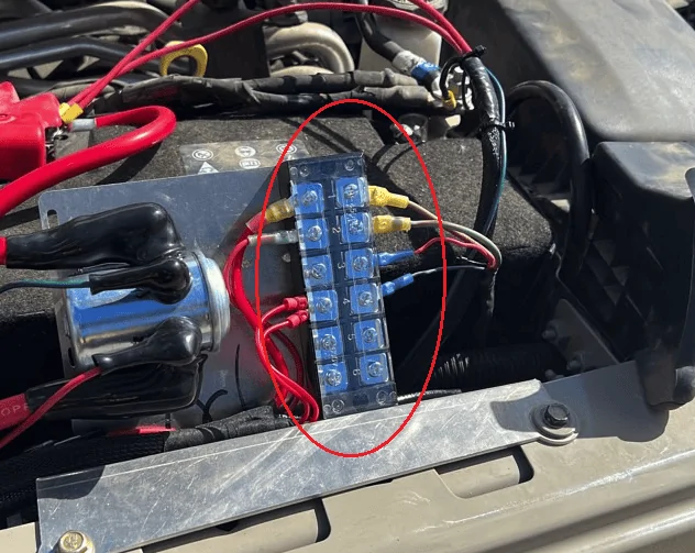

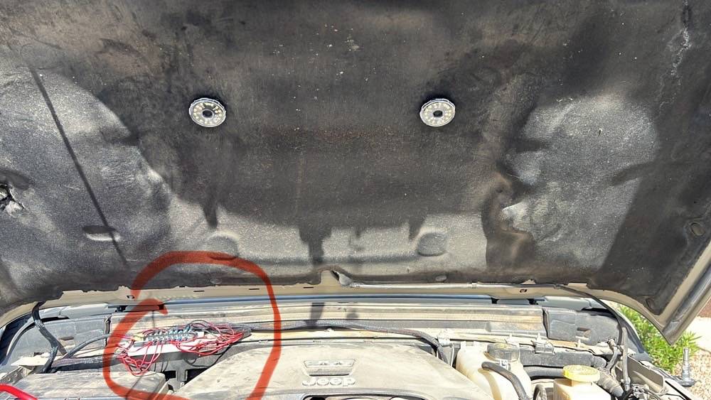

I'm looking for one of those simple distribution blocks you have shown there.
I have it circled in the pic below.
Where did you get that one?
Jeep Gladiator Winch battery disconnect switch, to install it, or not to install it... 1705949055474

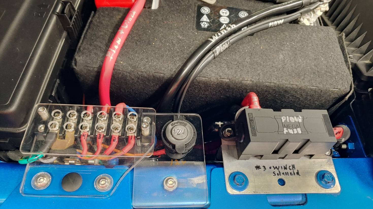

Go to Menards or similar - I mounted mine on acrylic and made a cover for it with holes to allow access with a screwdriver if needed to add or remove wires.
Jeep Gladiator Winch battery disconnect switch, to install it, or not to install it... 20221109_160600_HDR
Jeep Gladiator Winch battery disconnect switch, to install it, or not to install it... 1705950078053
What you have circled is called a terminal strip. That particular one is made by Blue Sea and you should be able to find it on Amazon.
Blue Sea 2406 Terminal Block 20 Ampere 6 Circuit 2406 https://a.co/d/bISrTBo
However, based on what you are describing that you want to do, you should be looking for a dual bus bar:
Blue Sea Systems 2701 Blue Sea Dual Bus 100 Ampere Common BusBars 5 x 8-32 Screw Terminal https://a.co/d/2tX3k2g
The difference between the two is that the dual bus bar allows you to hook all the positive leads together and all the negative leads together. A duel bus bar is great for something like rock lights, where you have, say, 6 positive lead and 6 negative leads. You can hook them all onto the appropriate side of the bus bar and then run a single positive and single negative lead off to your switch.
The terminal strip works best in the application I’ve shown where you have 4 discrete and different loads that you need to hook to their own discrete switch. The lug on one side of the strip is connected ONLY to the lug on the opposite side of the strip.
I’ve included a couple of Amazon links to get you pointed in the general direction. Since it looks like you are in SoCal, try looking at boat stores such as West Marine or RV part stores. They typically carry this stuff.

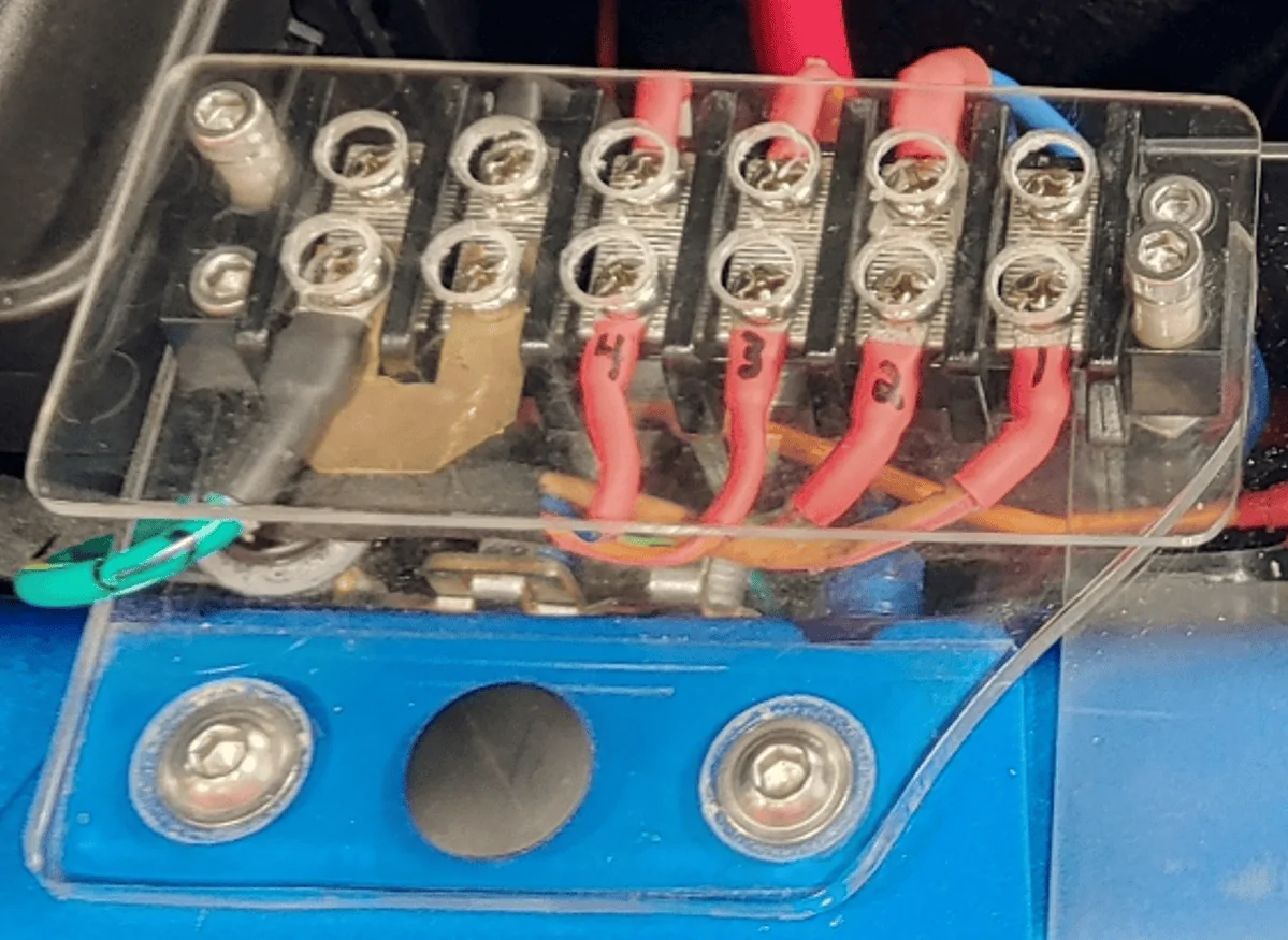

My terminal block is perfect for the aux switches - one for each switch and a couple of extras for grounds (my crude brass ground jumper in the pic)
1-4 for the aux switches 1-4 and then the green wire goes to a ground stud under the terminal block so I can really easily attach a couple of grounds if needed without digging under my other stuff.
Anyway - good call on the buss bar for running several lights through a single power or switch source. Nice looking units, too.
