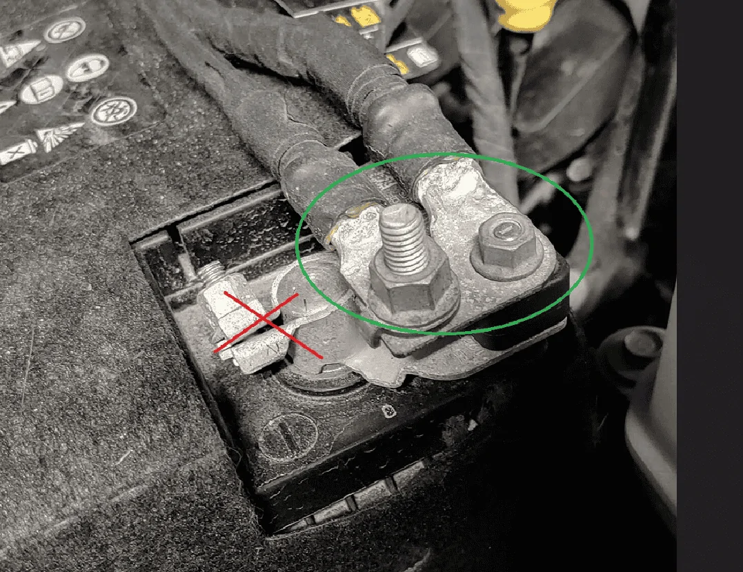

Red cable from battery + terminal to the switch, then another wire from the switch out to the winch power input.
When you connect the winch negative/black cable, make sure to connect it to the top of the IBS (intelligent battery sensor) on the battery negative post and not below the IBS.
Winch ground/black cable in the green area, not the red x area ->

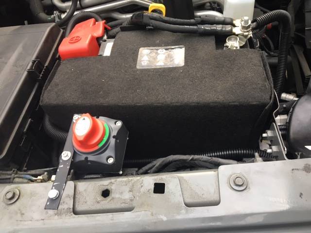

These are what I used for a quick disconnect, works great, fast, easy to use, no worries about draining batteries or shorts.
I used the same on my XJ, 2 reasons I could use winch front or rear and could jump start with them but still had a solenoid with flip up rocker switch in cab. I happen to have one on front of LJ and one at rear of JT too. ;) Easy to jump start other vehicles or rear winch in latter case.

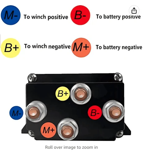

At least their wiring diagram is perfectly not confusing at all.
B- to battery POSITIVE... ok sure. minus to positive why not.
B+ to winch? negative? WTF is going on here
I thought the same. This is a standard relay so it doesn’t matter how they label it. It just matters that the posts are connected correctly. There is plenty of info on these using google. Lol
