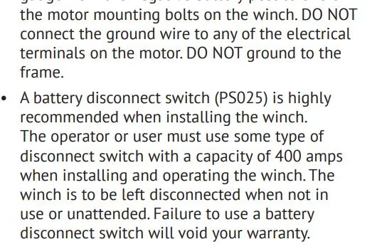

Jeep Gladiator Winch battery disconnect and circuit breaker? 20201017_135923_HDR
I'll repost for a point - apparently at least one winch company is run by bubble boys -
Jeep Gladiator Winch battery disconnect and circuit breaker? winch-disconnect

Did you read the manual for the Gladiator? As ShadowsPapa pointed out. A cutoff switch must be installed or warranty will be voided. So what manual are you talking about? Was it a few decades ago when safety wasn't much of a concern? Come on, it's just a switch and a fuse that will not hinder the operation of a winch.
