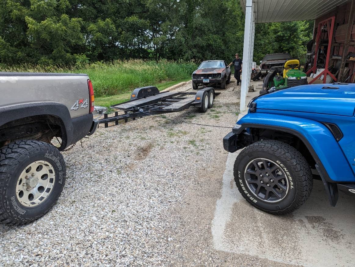

I worked for a shop that ran 2 wreckers and it's amazing what the boss could do - how he could pull, lift, whatever. He towed for regular customers, plus the IHP and Altoona, Iowa police dept - accident calls, impounds, whatever.
And these things can be useful for ordinary tasks, taking the grunt out of a task - snatch block on front of trailer.....he steered the car while I ran the winch and watched the alignment of the car on the ramps and on the trailer via wireless remote.
Jeep Gladiator Question about a winch install? PXL_20230625_191735806.MP
Proof - they aren't just for off-roading ;)

That is an everyday use of something most consider just for off road. I like it!
