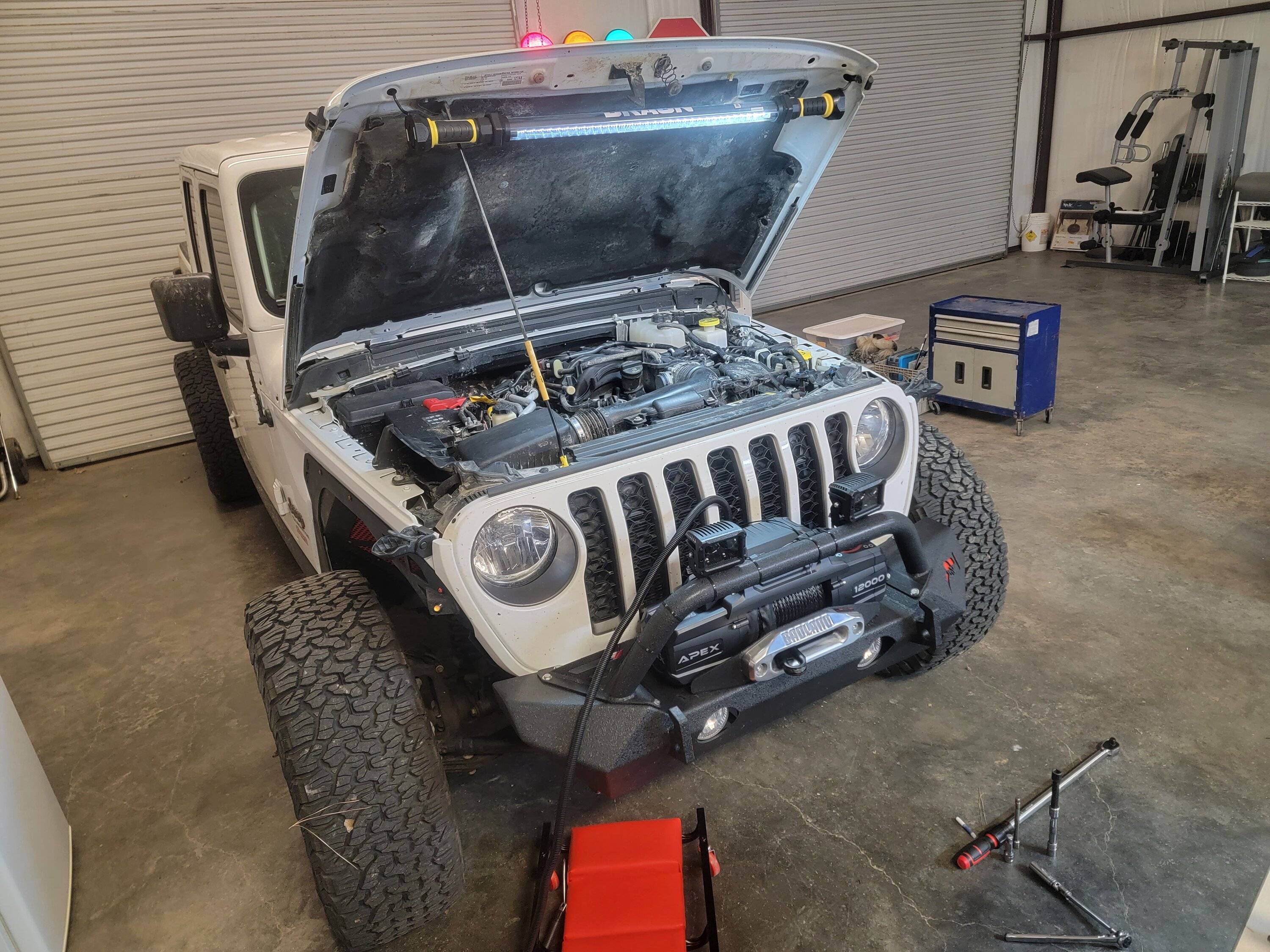

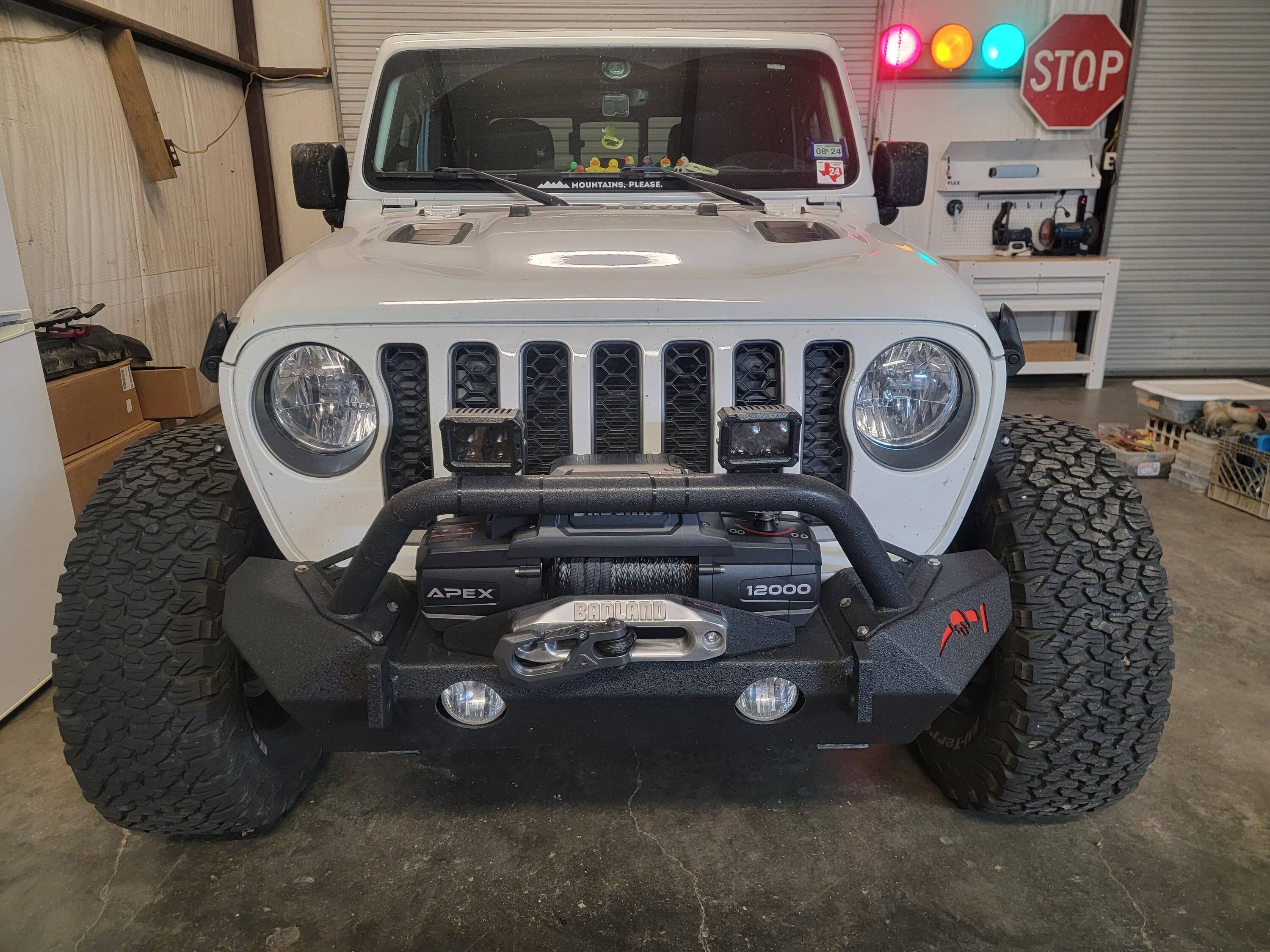

Went with the badlands apex 12k, over all impressed with it so far. Straight forward install, clear instructions. Made it easy for someone who has never installed a winch before. Look forward to seeing how it pulls. Piece of mind allows me to push a little harder and further than I have been able to.
Jeep Gladiator Winch install! 20231129_183159
Jeep Gladiator Winch install! 20231129_191520
Jeep Gladiator Winch install! 20231129_202151
Jeep Gladiator Winch install! 20231129_210031
Jeep Gladiator Winch install! 20231129_213031
Jeep Gladiator Winch install! 20231129_222631

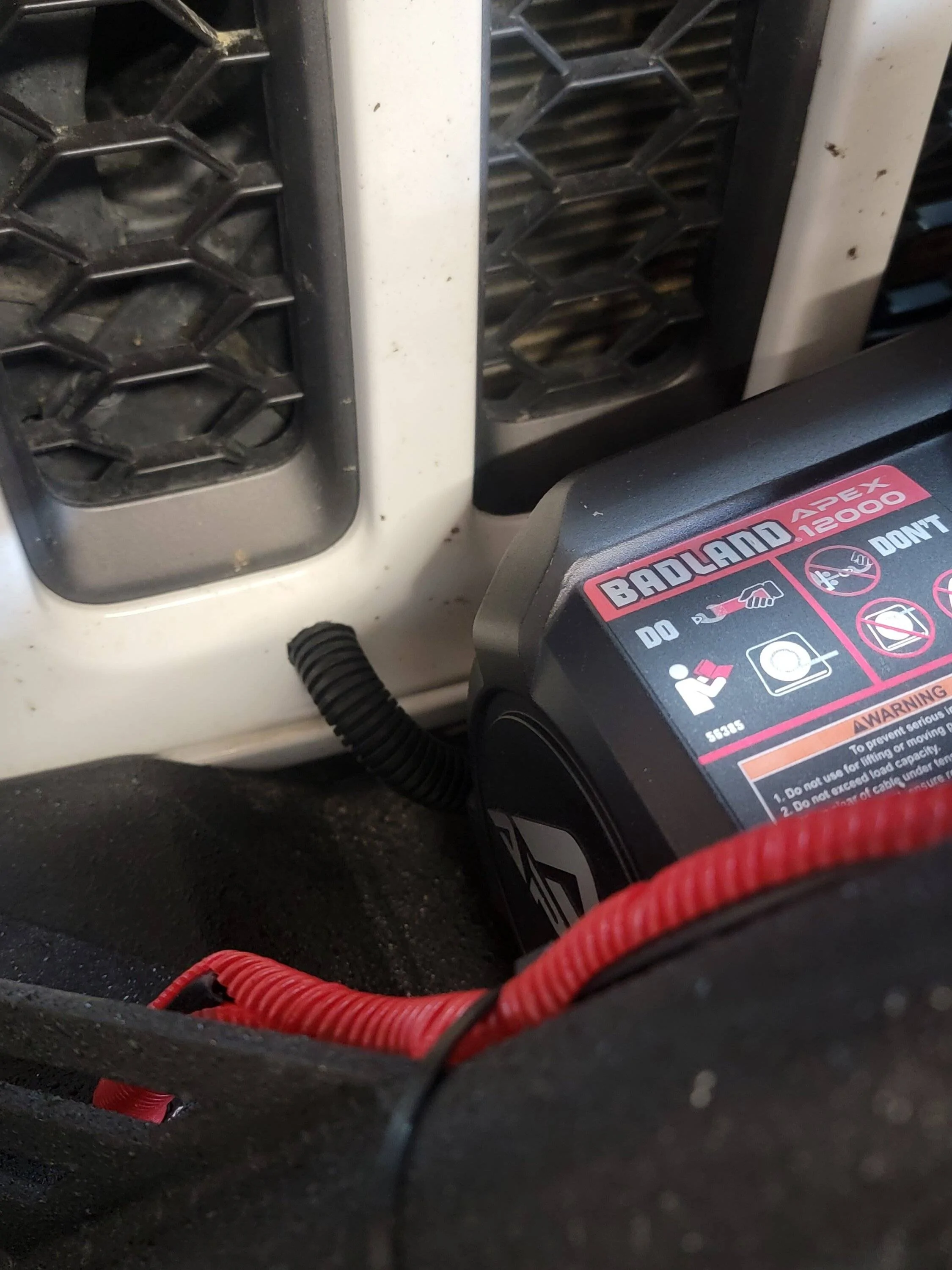

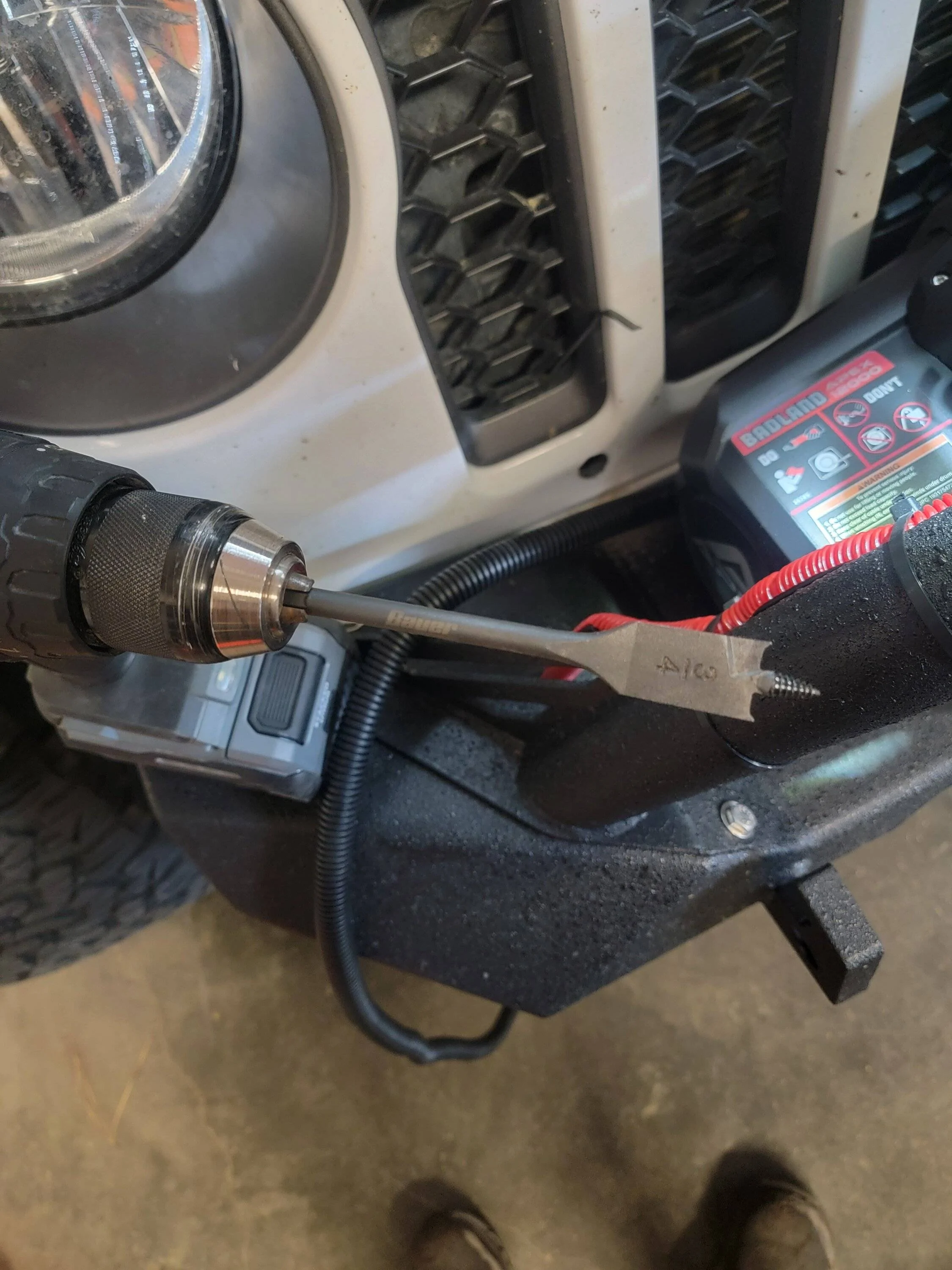

i got a warn from northridge during blackfriday. did you drill through grille bc you liked that solution or was there not enough room for the wiring?
Doofus
Doofus
Joshua
Nov 13, 2023
56
Chester Tx
2022 JTR
Knife Grinder, Georgia Pacific

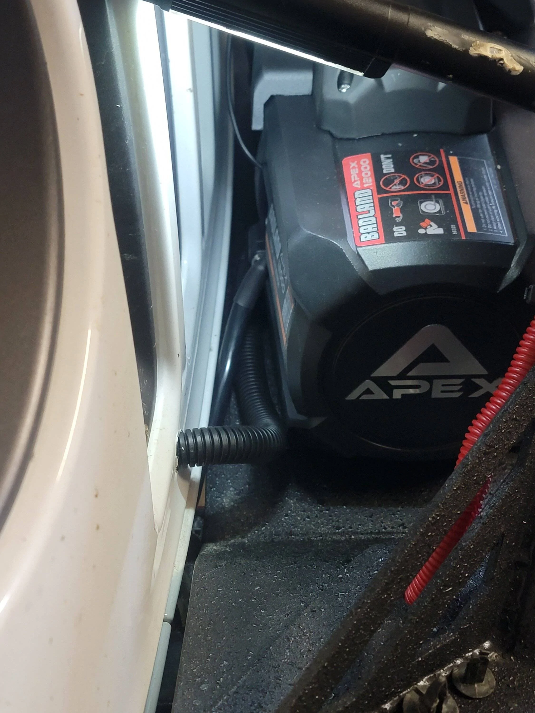

The bumper I have sits tight against the grille, so close that I can't pull the grill off without taking the bumper loose at the very least.
I put the hole in it instead of just having the wire run through the grille itself, not a fan of wires flopping around. The hole is 3/4 in and the corrugated plastic is also 3/4 in. Fits nice and snug
Okay at first I was did you really just drill through the grill... but that fits so snug with that corrugated tube. That I was was like huh that's actually slick idea for wire management. Wouldn't have thought to have done that, or rather been too hesitant to do it.
Oh I was hesitant ? was hard to do buy I think it turned out pretty good.

As long as you don't need to pull the grille for any reason, you can route the wires any way you want to. it looks good and if you are happy with it, that's all that matters.
I wouldn't have done it that way (and didn't on my Gladiator) simply because I learned from my JK that small issue with grille removal. Tie wraps took care of the flopping wire issue.
