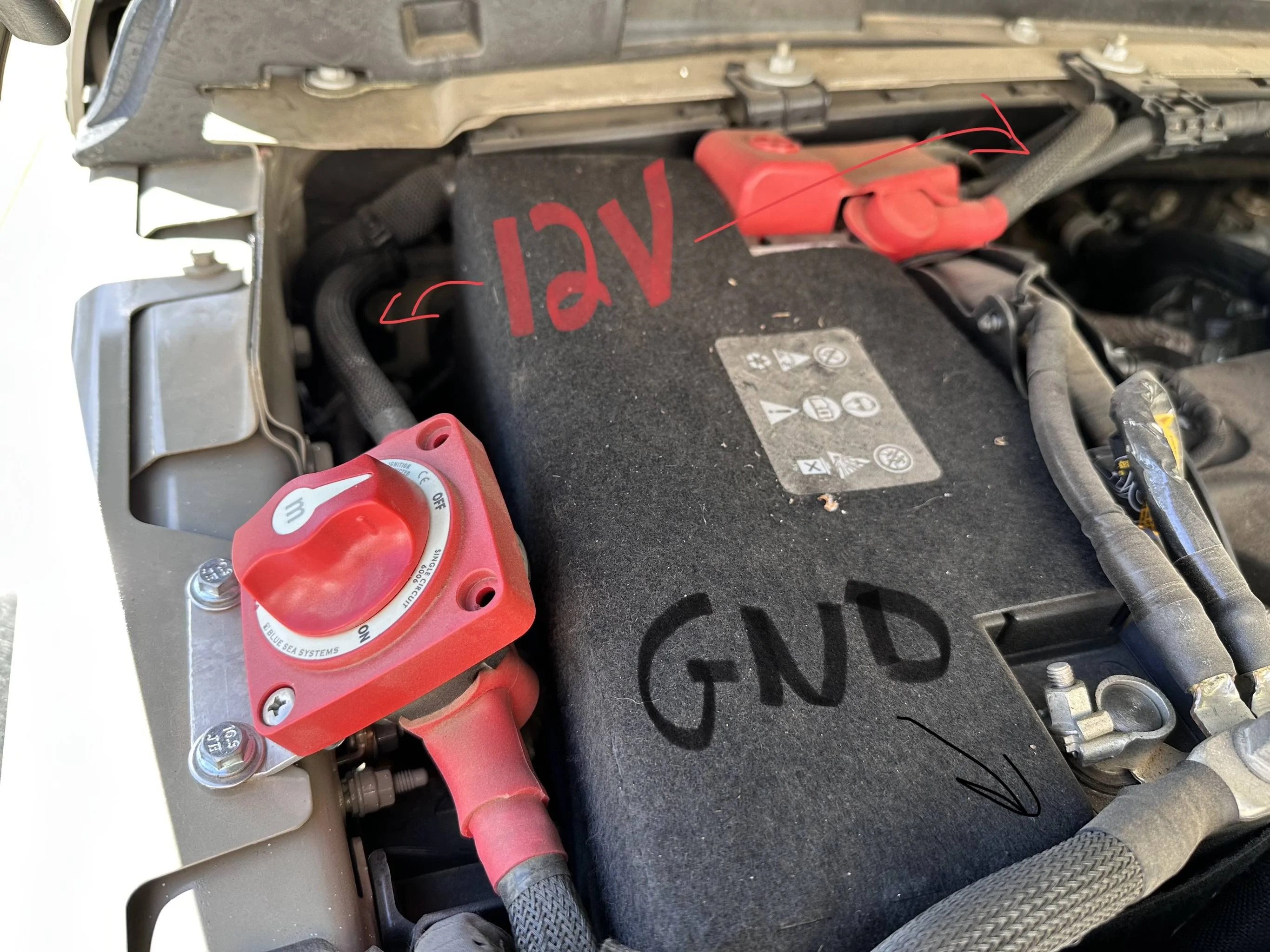

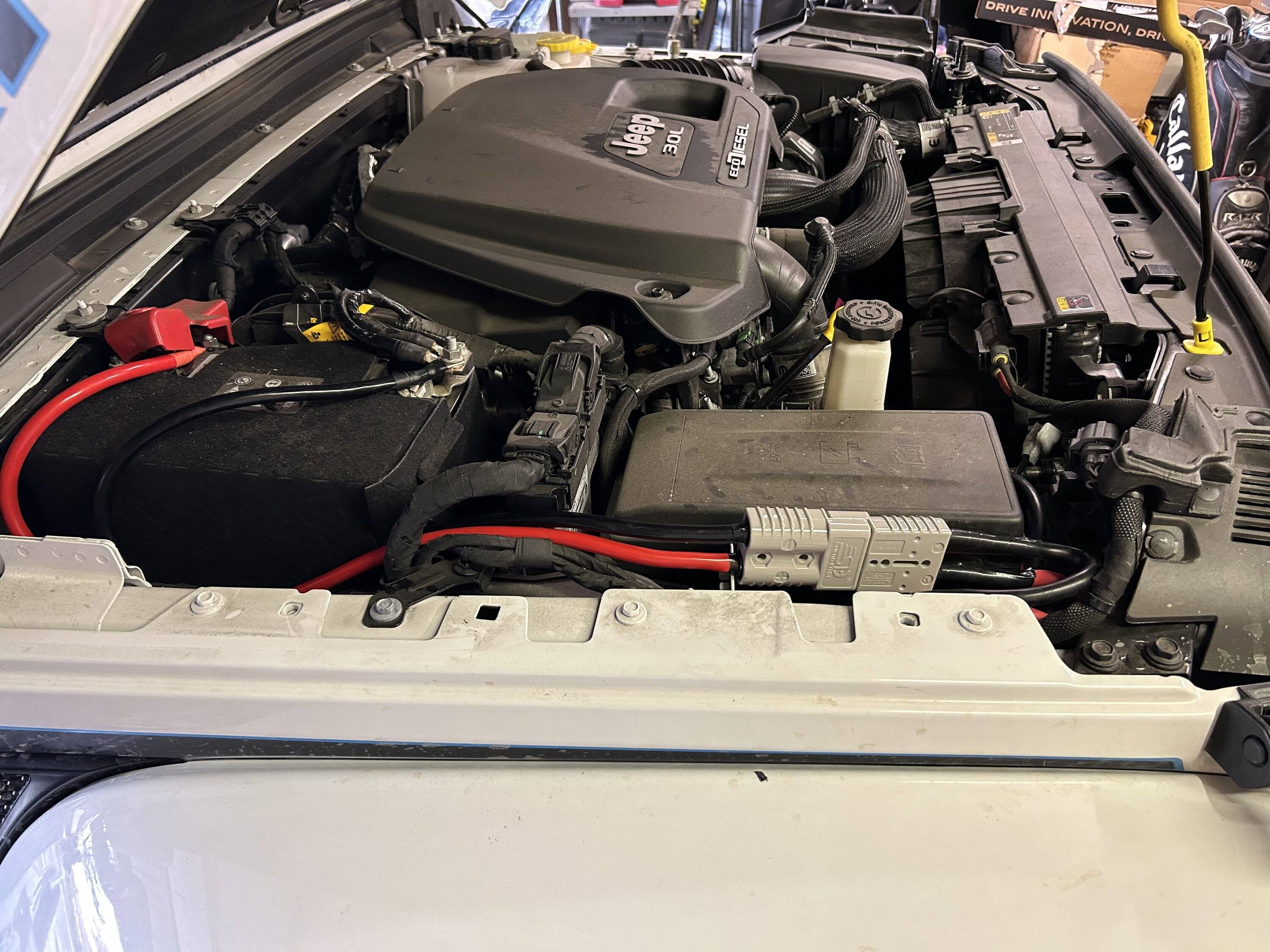

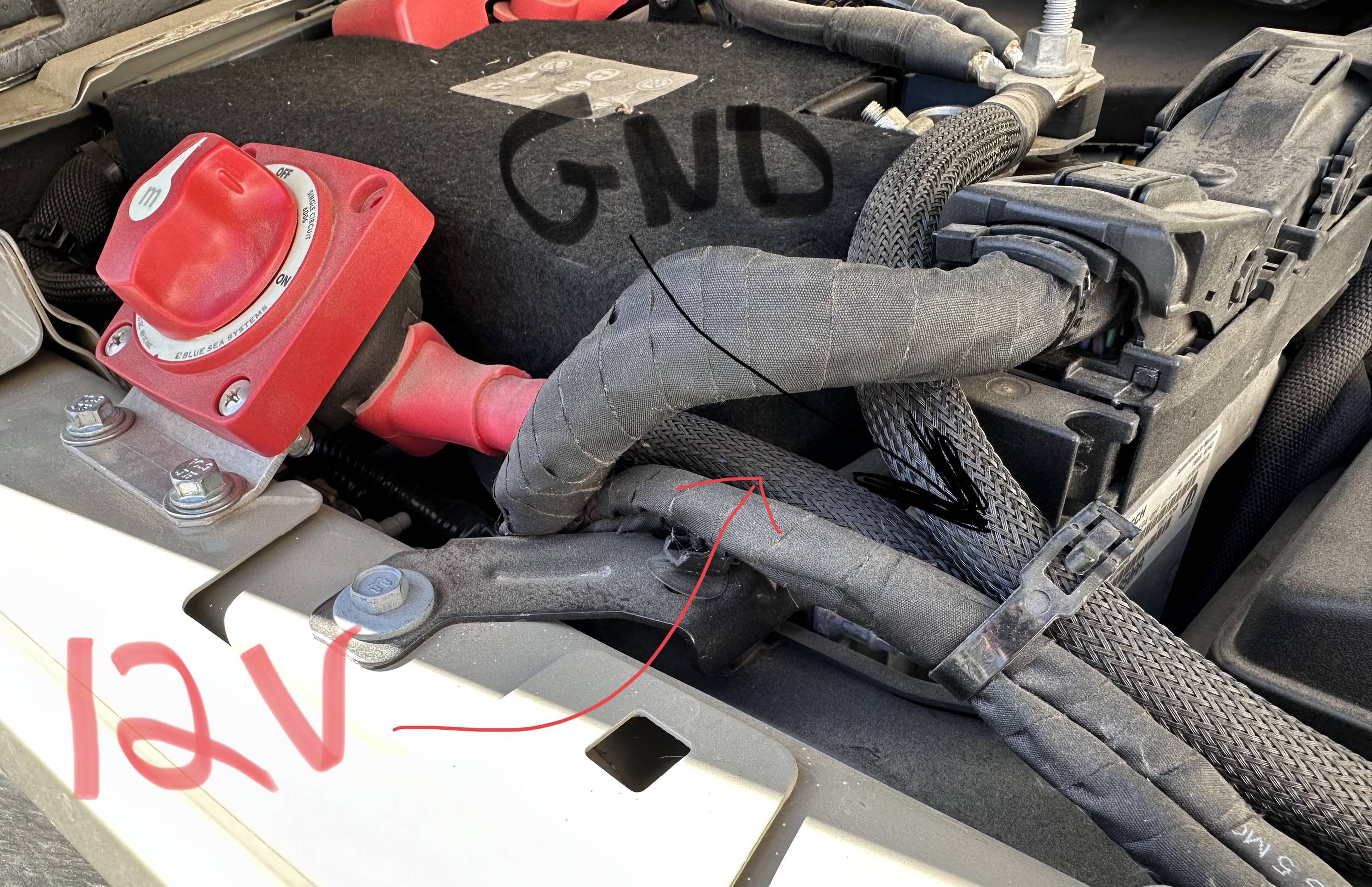

Kinda top view of the battery. A lot of people go over the battery, making it harder to take the batt in and out if needed - I went around the back of the engine bay following the electrical raceway that’s already there. I used woven loom, taped down with electrical tape, and properly sized terminal covers so there’s no exposed +12V anywhere. You’ll also see my winch disconnect switch (BlueSea 6006) but that’s optional
Jeep Gladiator Winch install on Ecodiesel - cables? ADB005D5-5BB5-4A70-9B44-DEFE6983251A

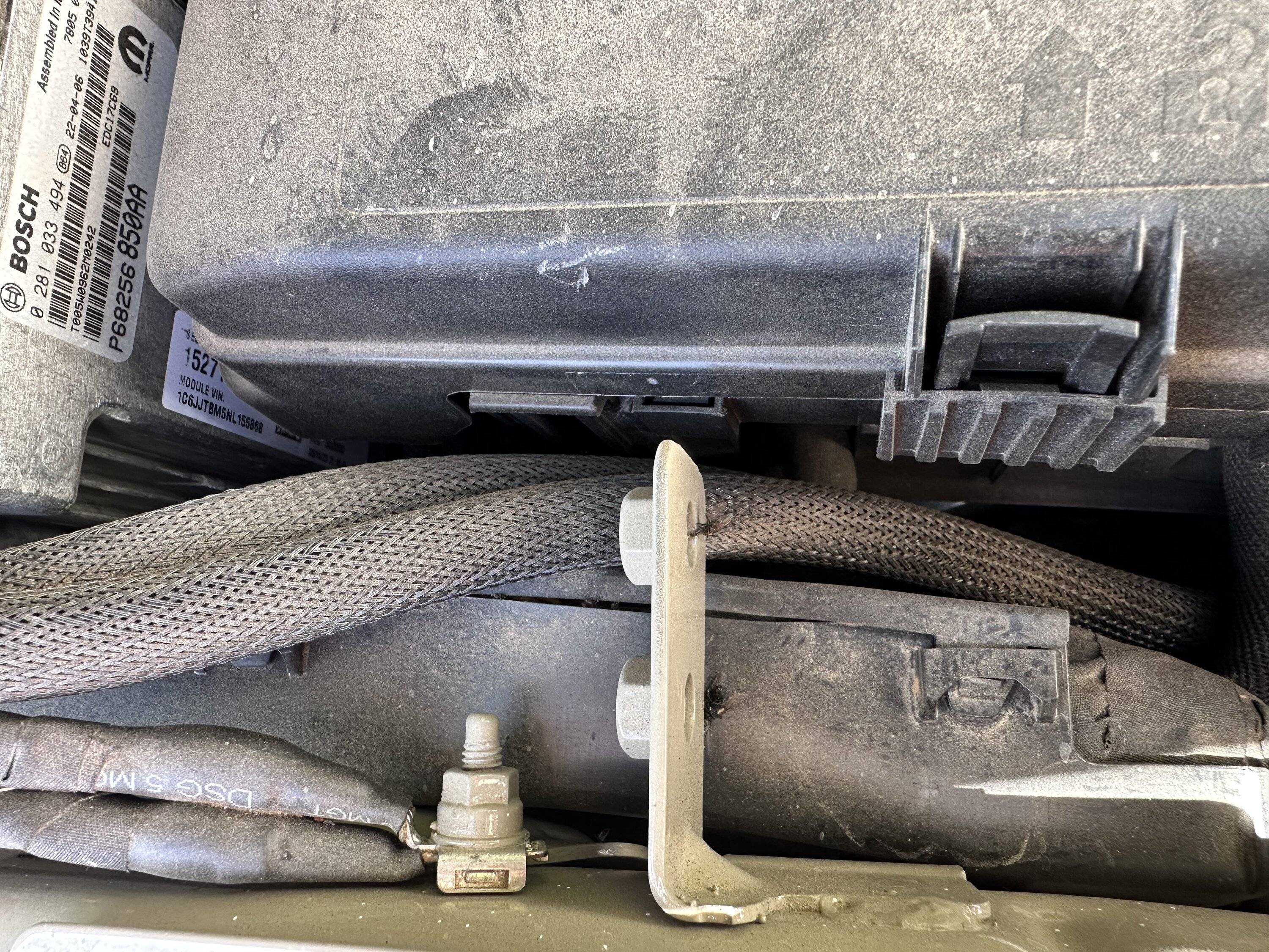

Here the +12 and GND join a bunch of other wiring harnesses as they go forward along the passenger side edge of the engine bay

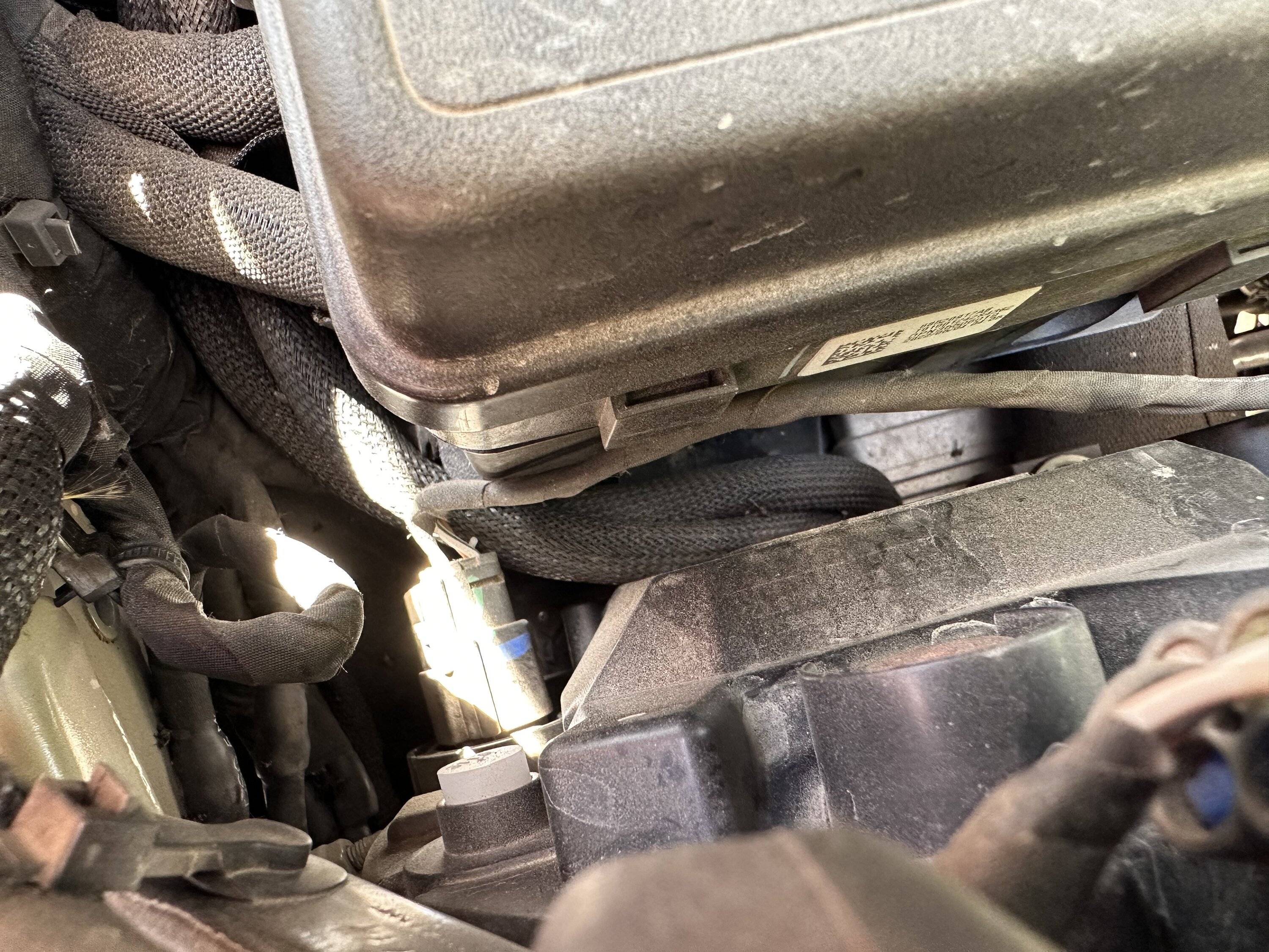

Here’s where those fat 1/0g wires drop down between the fuse box and fender

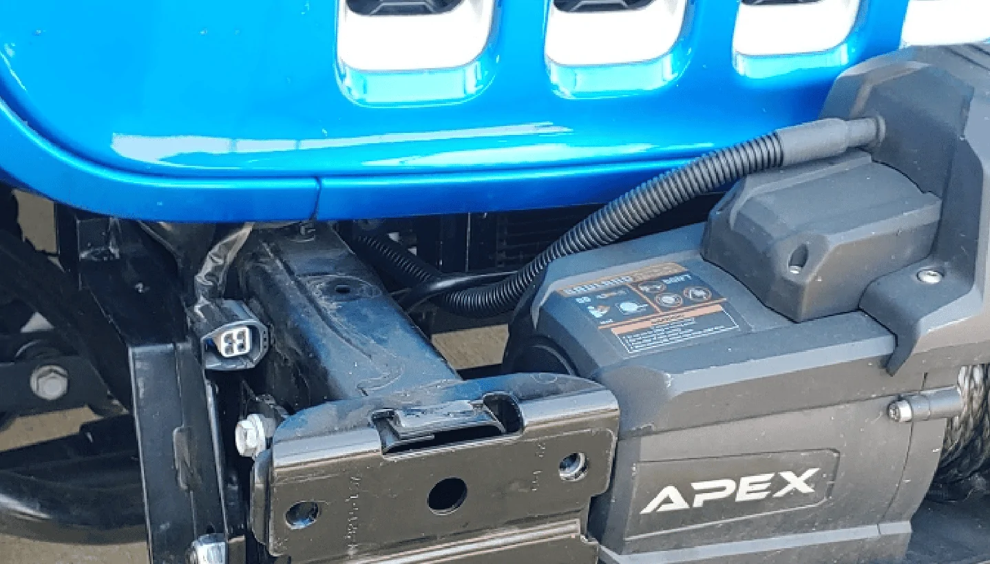

And where they drop under the corner of the fusebox and turn forward, to emerge under the grille

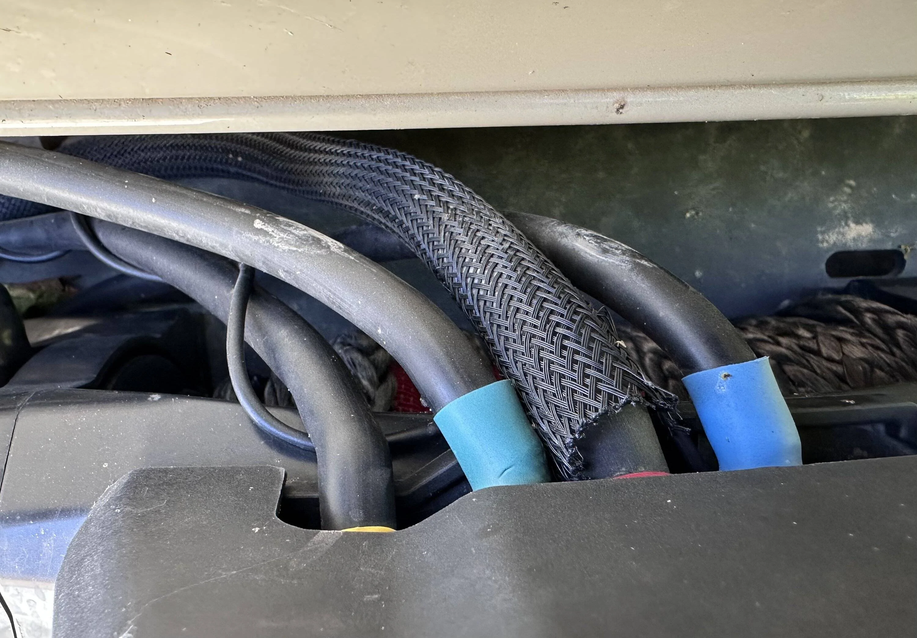

Do yourself a favor, add woven loom to everything coming out of the winch for abrasion resistance. Here you can see my +12V main (tiny bit of red visible) with loom on it. I skipped it on the blue, green, and yellow short lines from the contactor to the motor, and they’ve been rubbing on the bottom edge of the grille surround. There‘s a gap currently, because I bent the damned winch plate last week, but normally these rub a bit on the grille frame (and will again when I fix the plate - going to add loom when I repair)

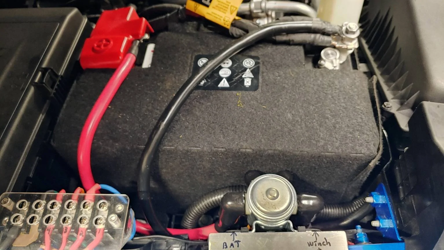

My winch cables were too short to reach the battery in the back, so I ordered some extra cable on Amazon as well as an Anderson connection to lengthen the cables. I went up behind the radiator to get what I needed.

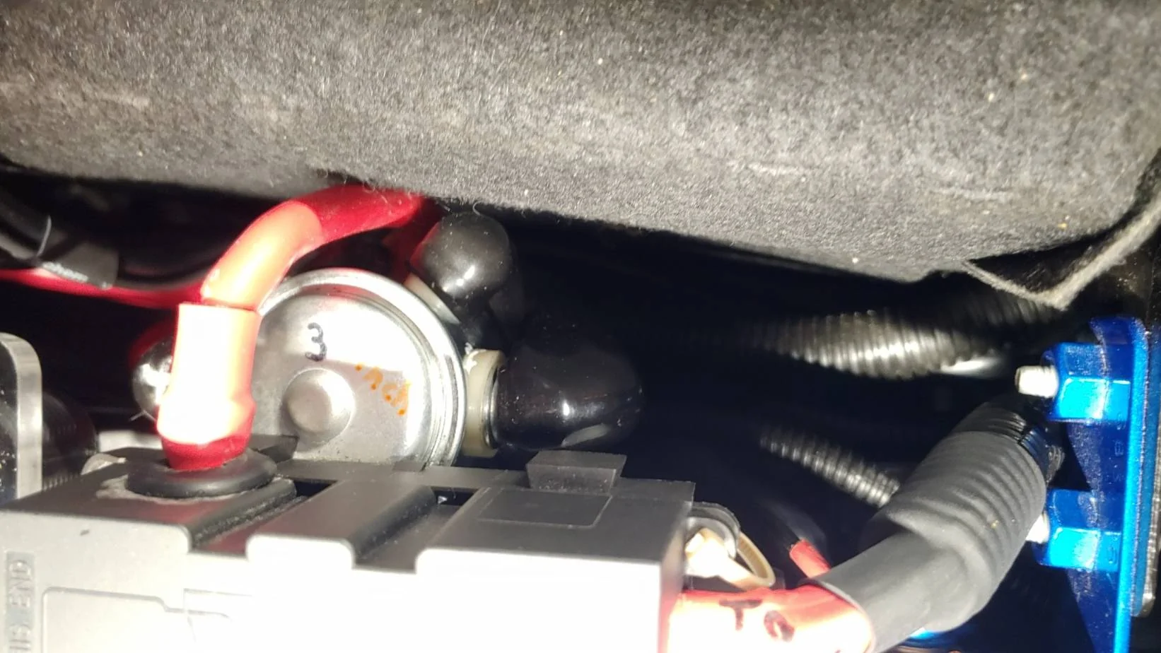

Always mount the ground cable either to the body/chassis ground, or to the top of the IBS on the main battery negative terminal. Never directly to the terminal itself, always on top of the Intelligent Battery Sensor.
You really really should run a switch or other disconnect of some sort. Either a big manual disconnect switch, or a solenoid rated for winches or manually disconnect it at the battery area.
This way you won't have full battery power to the front of the vehicle.
This is a simple switch - off, there's no power to the front bumper or winch. Reduced risk of fire from a short/ground.
