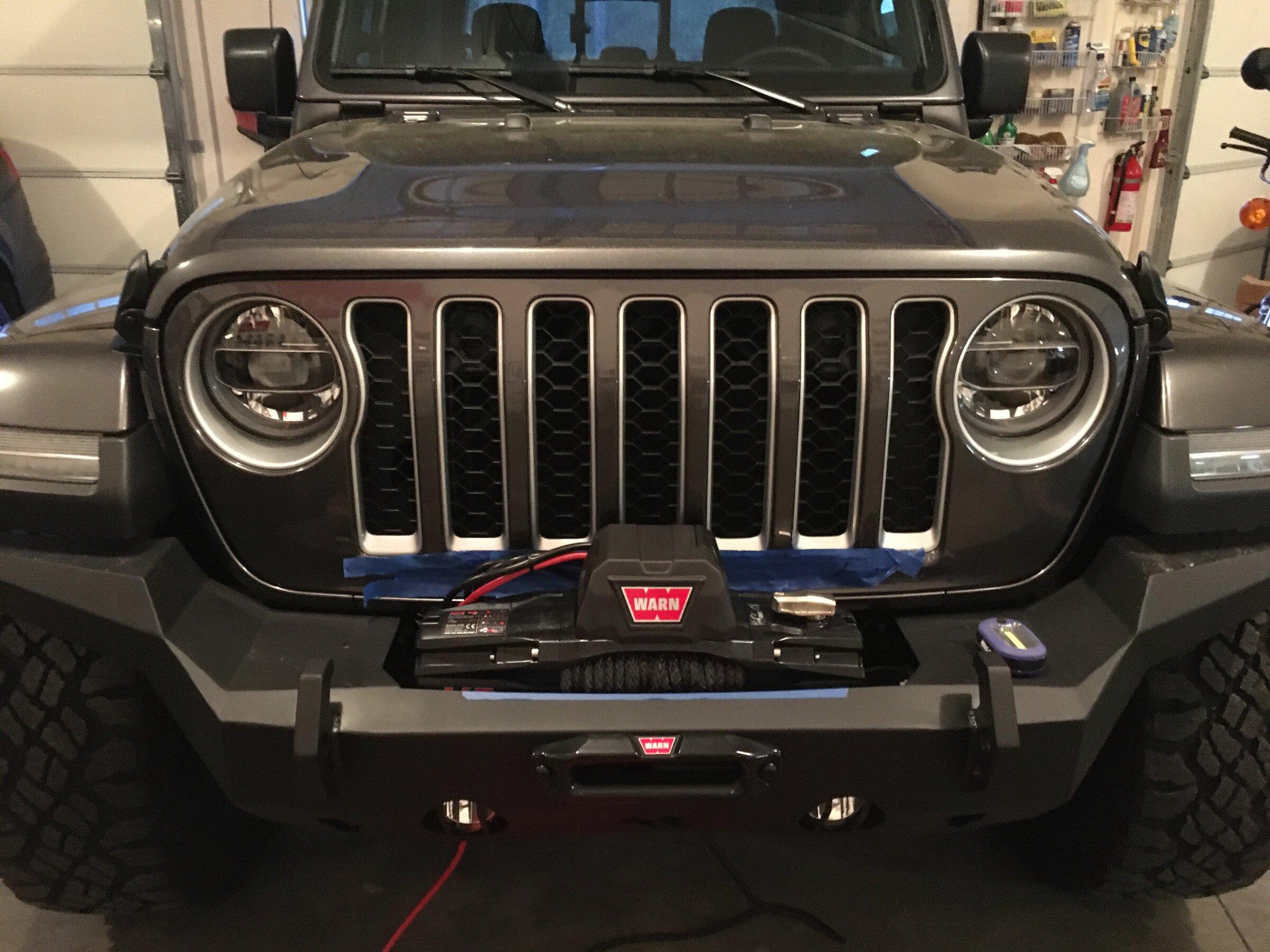

Warn Winch VR10s install, anyone done one?
Buzzlb
James
Nov 13, 2019
412
774
Atlanta
Gladiator Overland: The Overcon ‘82 CJ-7

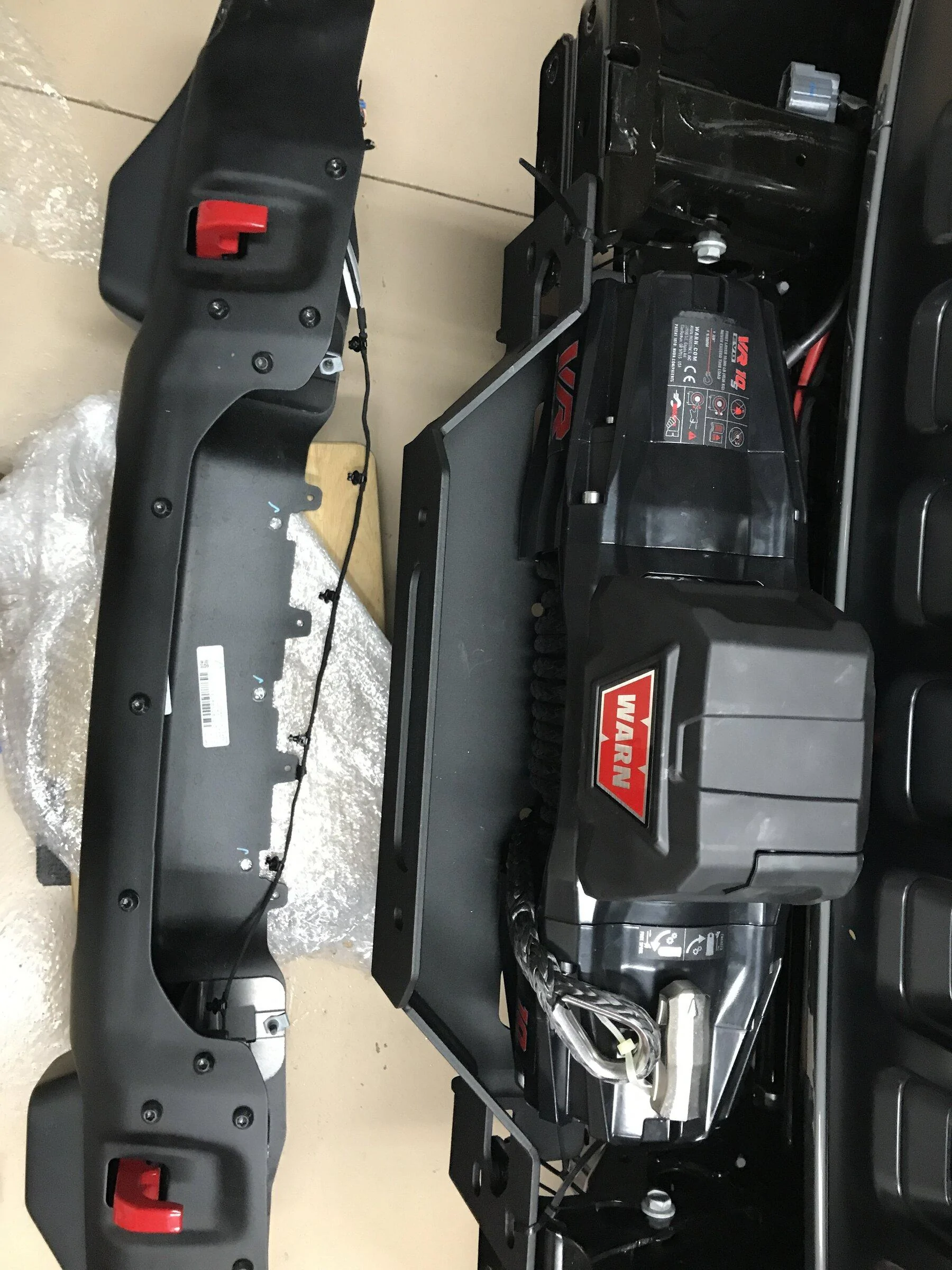

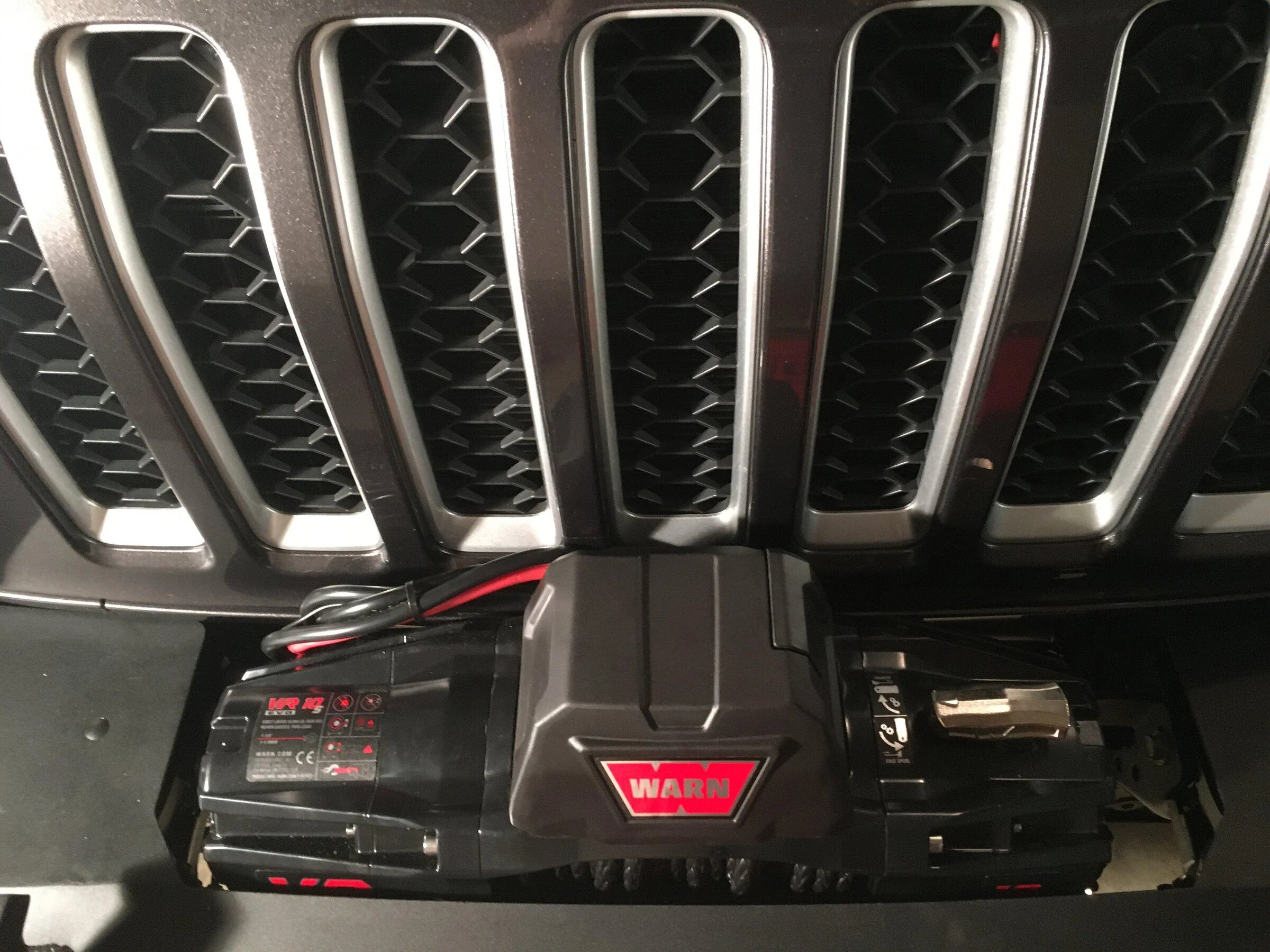

12s on RR HD. Vary tight fit.
You can adjust the wires for better routing.

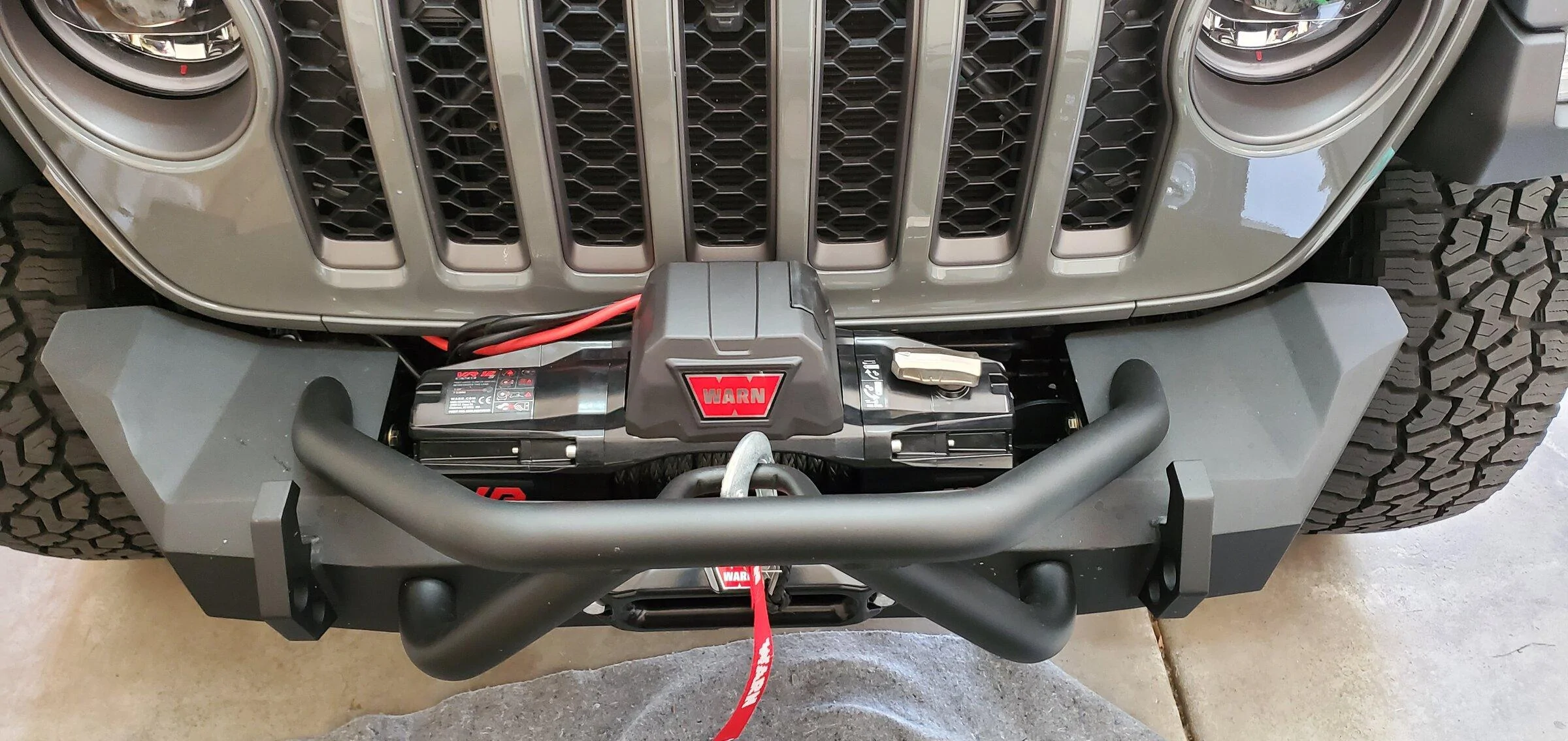

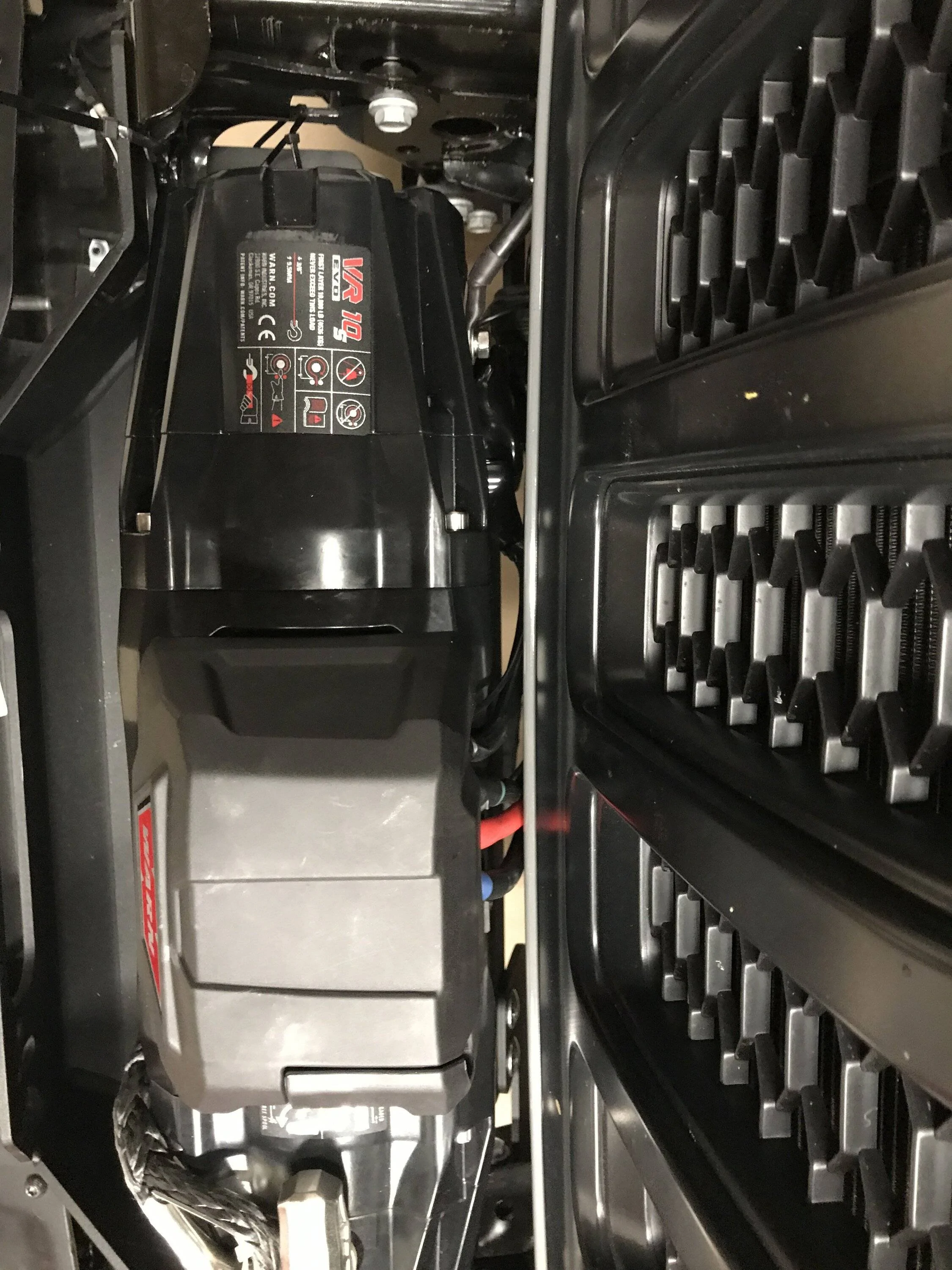

I installed a 12S that I got for a really good deal ($575)on the RR stubby. Just like buzzlb, it's a very tight fit even with the 1/4 bumper spacers from a member on here, but still fits.

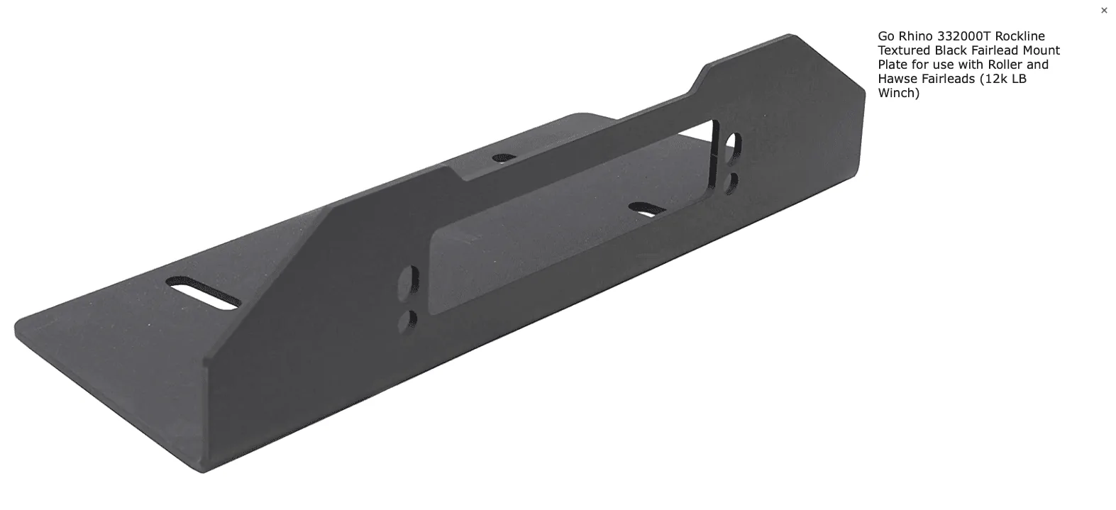

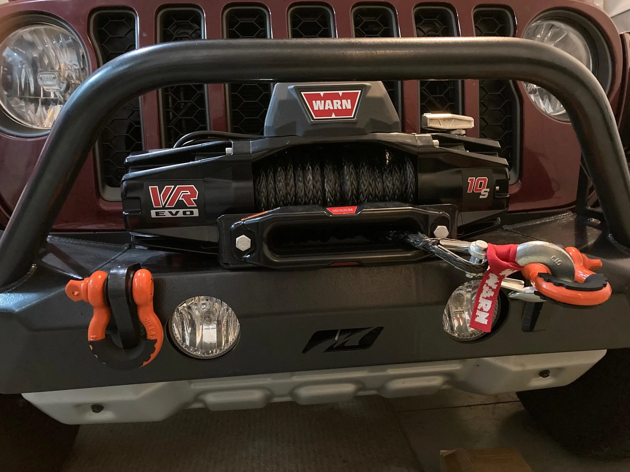

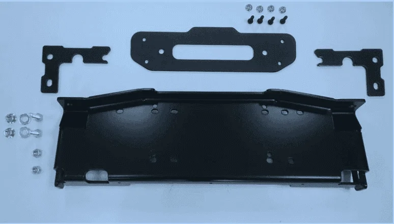

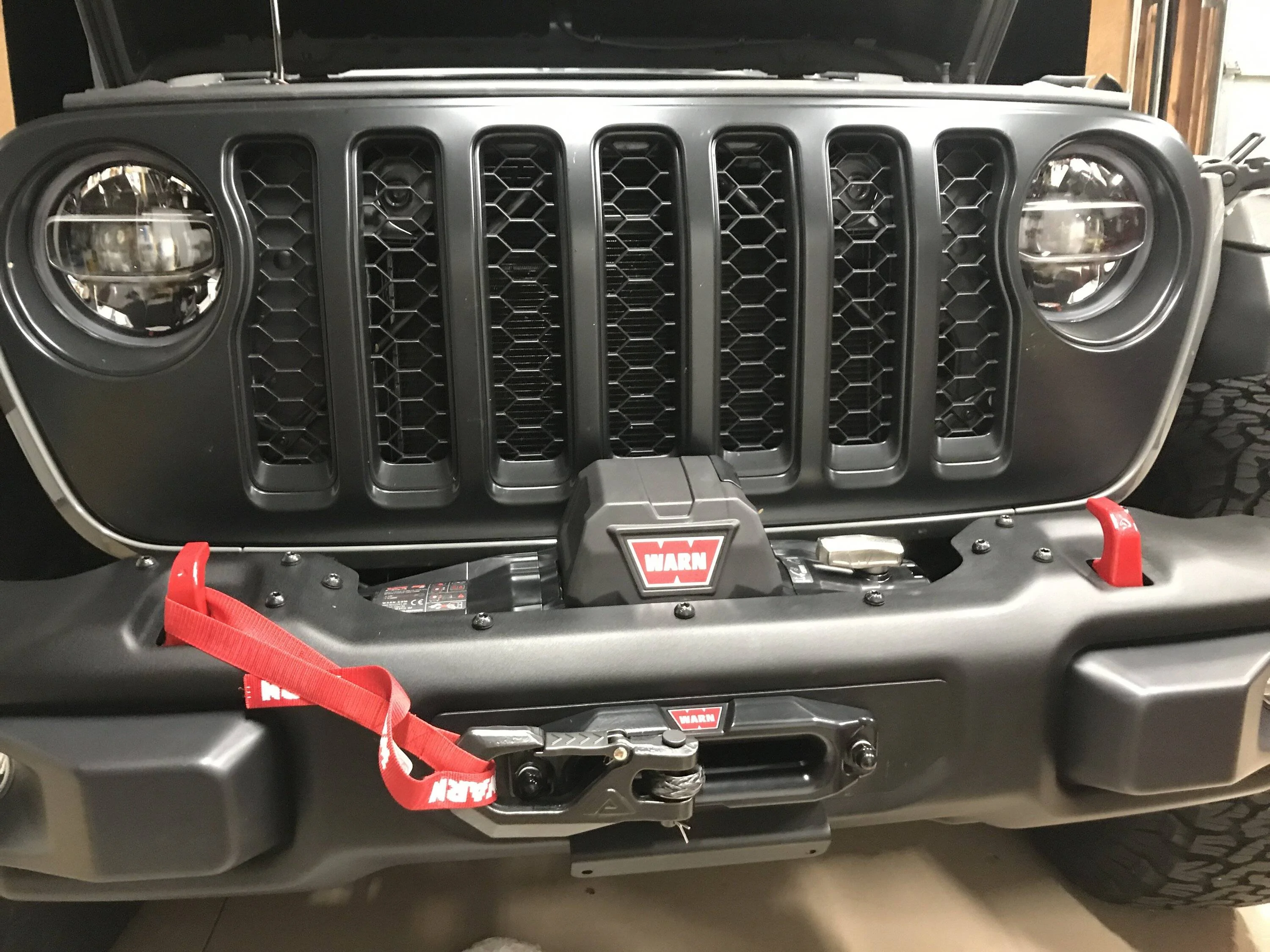

I have the factory plastic Rubicon bumper and factory steel skid plate. I wanted to keep weight down and use what I already had. I installed the Warn EVO 12S, Maximus-3 winch plate, Go Rhino 332000T Rockline Textured Black Fairlead Mount Plate (to take up some space between the winch and the plastic bumper), Tuffy license plate holder, Maximus-3 Tow/D-ring brackets. I bought the winch/mount plate kit from RubiTrux. Great price, no sales tax, and free shipping. I had to cut up the plastic and steel factory bumper, but the mounting plate fit perfect. I got the idea from a gentleman, Toby W, on the JLForums website who made his own winch plate and kept his plastic bumper. https://www.jlwranglerforums.com/forum/threads/winch-mount-for-plastic-bumper.7605/

Hello Mr. Cob, I will answer your questions.
1. Yes, it is the factory Plastic Rubicon bumper. I don't know if the plastic bumper on the Sport or other models would work, but I believe they would. The shapes of the base bumper and the Rubicon plastic bumper are very similar.

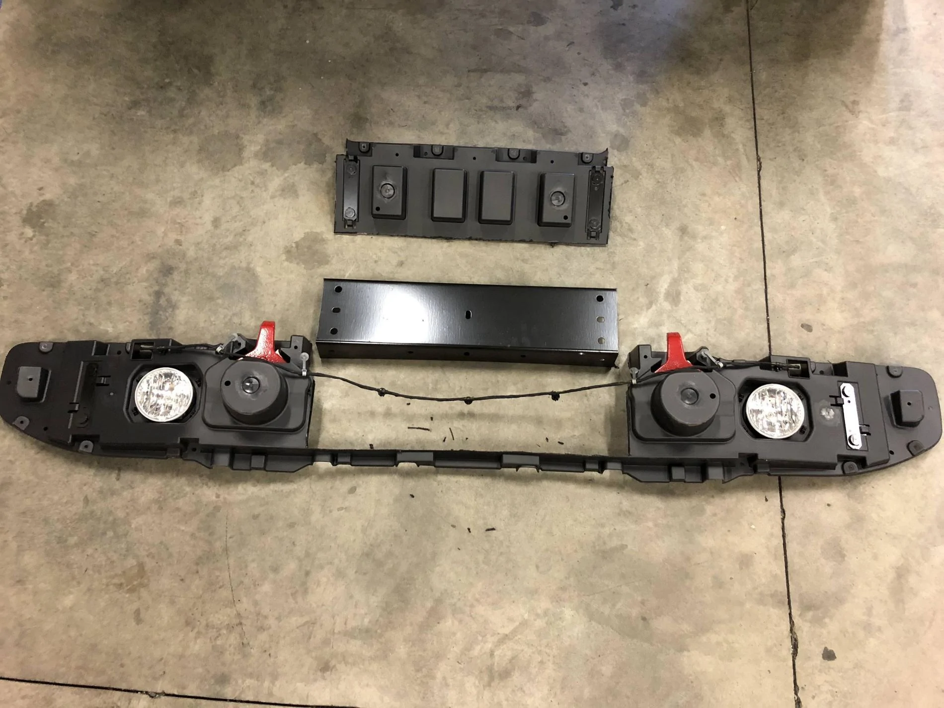

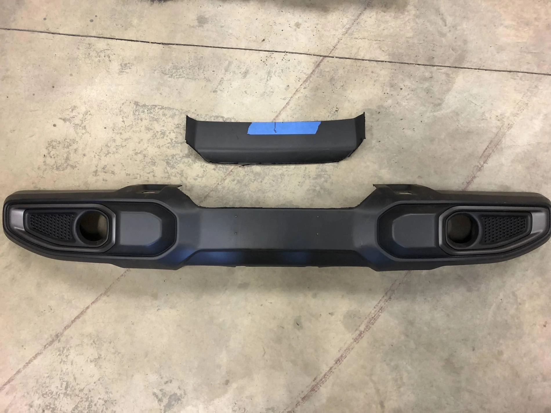

2. Behind the plastic cover, there is another plastic piece that is called the Bumper Reinforcement and behind that is a metal plate that is called the Bumper Beam. I am attaching a photo of the two pieces after they are cut. Both the Bumper Reinforcement and the Bumper Beam have to be cut. I just used a cut off wheel on the plastic and metal piece to remove the material between the two frame rails.
3. When you remove all of the bumper pieces, you are left with the two frame rail members that the bumper mounts on. These frame rail members are the same on all Gladiators (and probably Wranglers, too). Any winch plate should mount between these two frame members.
4. After installing the winch plate between the two frame rails and putting the winch on it, I found that the distance between the front of the winch did not allow me to mount the plastic bumper cover directly to winch. This might not be a problem with another winch plate. I added the Go Rhino 332000T Rockline Textured Black Fairlead Mount Plate to the winch plate hoping to take up the space between the front of the winch and the plastic cover. It helped but did not reach the plastic cover. There was still a gap, so I added another fairlead to the front of the Go Rhino plate and the plastic cover. You can't see it unless you look down from the top of the bumper (it is red in my pictures). After installing the plastic cover, I added the Maximus fairlead plate and the Warn Fairlead to the front of the bumper. And I also added a license plate mount.
5. The gentleman that I got the idea from built his own winch plate, so he was able to extend the nose of the plate to reach the plastic bumper, He didn't need pieces to fill in the gap.
6. It would have been much simpler to just replace the plastic bumper with a metal one, but I wanted to save weight if possible. I would have to add a winch plate regardless, unless I went with an aftermarket bumper that included it. I believe I saved about 30 pounds.
Let me know if you have any other questions.

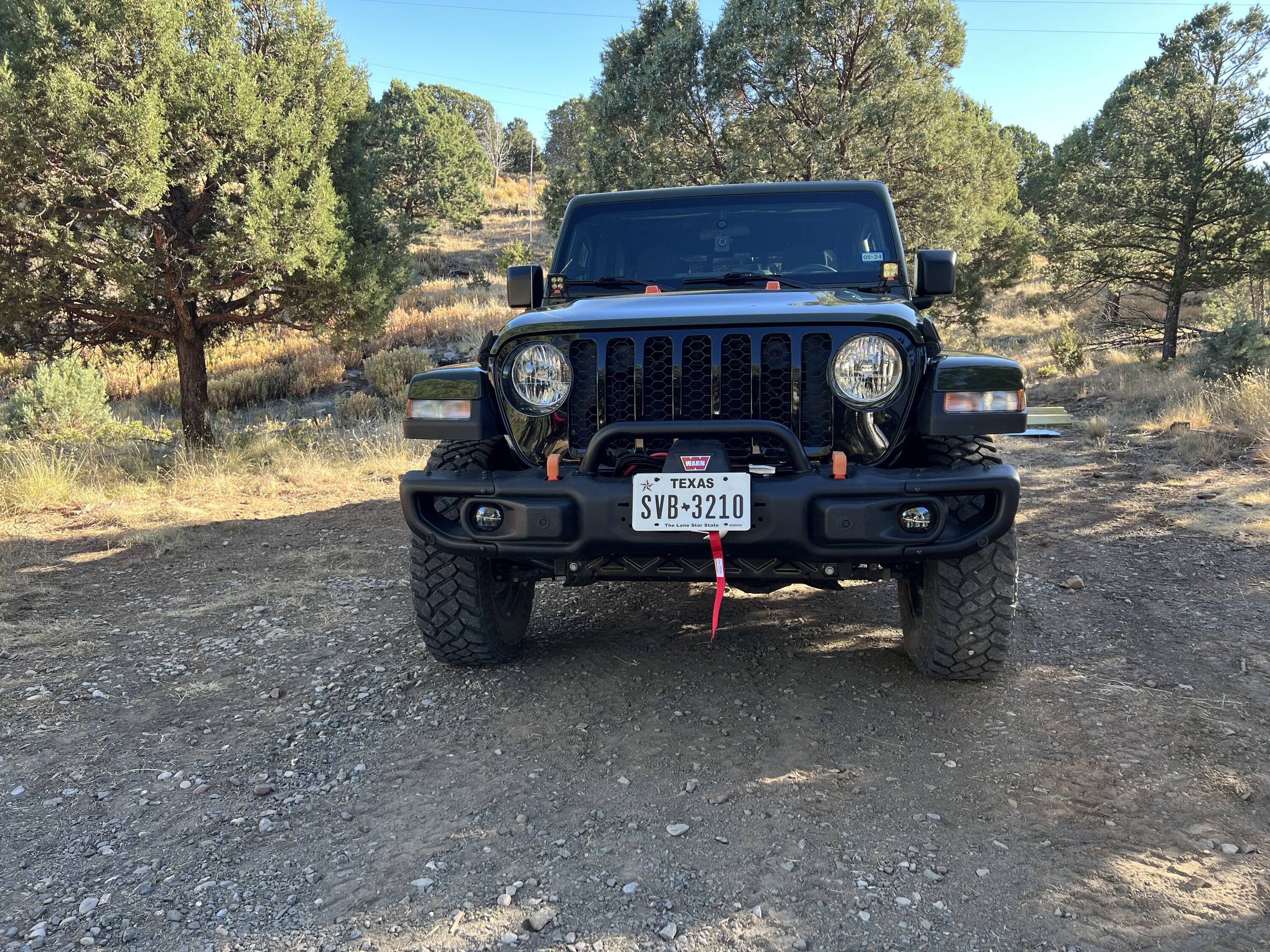

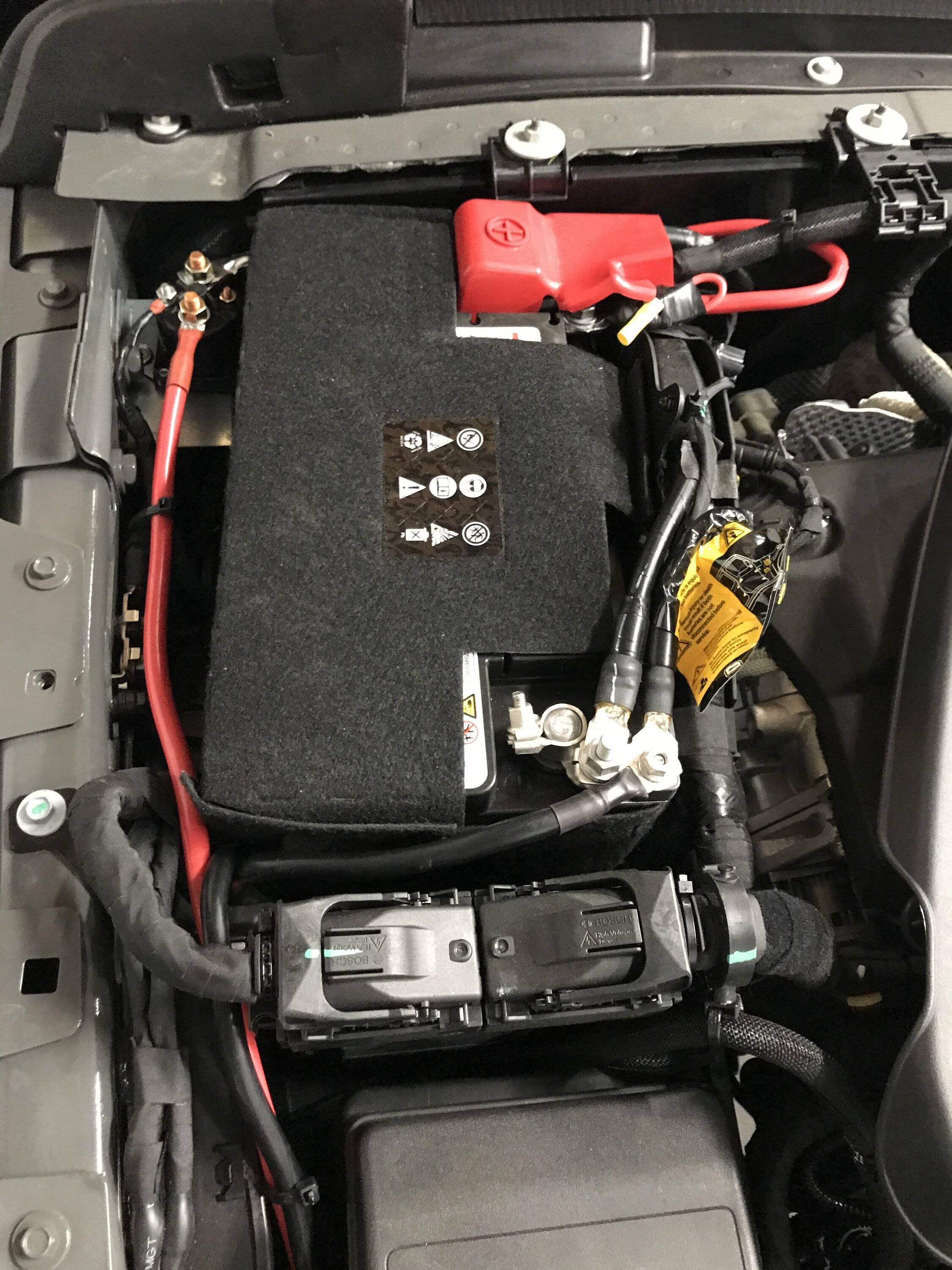

Like others, Warn 10s with Warn winch plate. No fit issues whatsoever.
Hey man! How did you hide the wires? Also, did you manage to fit the bottom winch bolts that bolt it to the plate all the way through? I’m struggling on my install! :/
A 2
Jul 4, 2020
86
905
1,139
N. San Diego
2021 JTRD, 2020 JLU
Construction
It’s been a while but I used all provided hardware except the fairlead bolts. wires were routed under the grill and up the by the frame rail then along the fender wall.

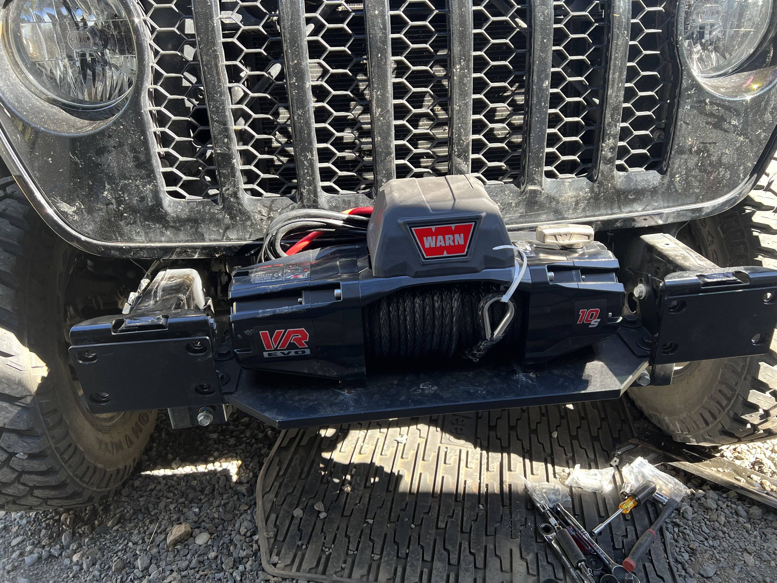

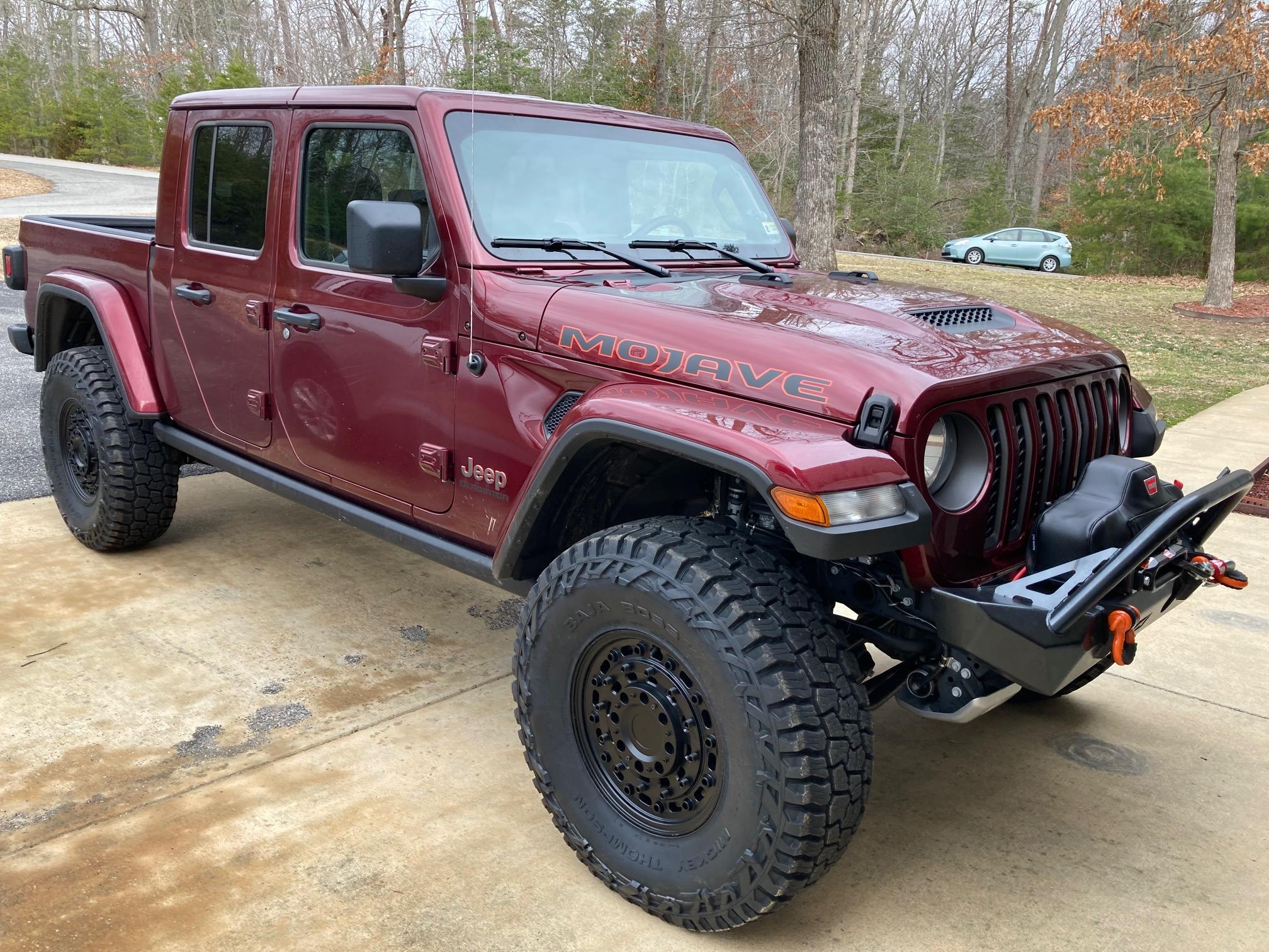

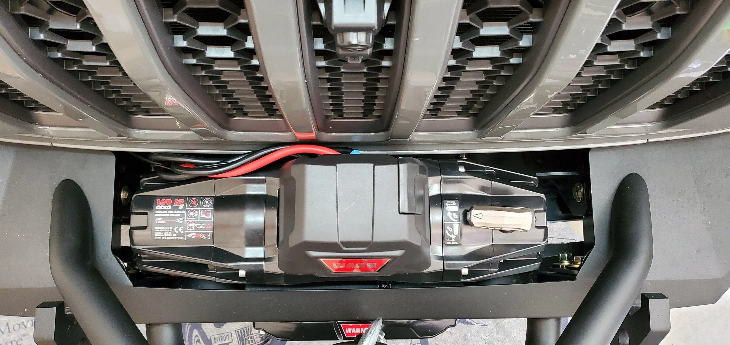

Did mine today while I was installing a steel bumper. Aligning the winch plate with the factory bumper bolt holes was a pain but we got it done. I installed the front license plate until I get the JT registered on NM next week. NM does not require front LP.
Jeep Gladiator Warn Winch VR10s install, anyone done one? IMG_8677
Jeep Gladiator Warn Winch VR10s install, anyone done one? IMG_8672
Got the title today after paying it off. Feels good. I like the looks of the new bumper. I'm pleased with the fit and finish. Only thing I didn't like was the sensor hole plugs which are garbage. Just ordred rubber plugs that will mold to the bumper contour.
