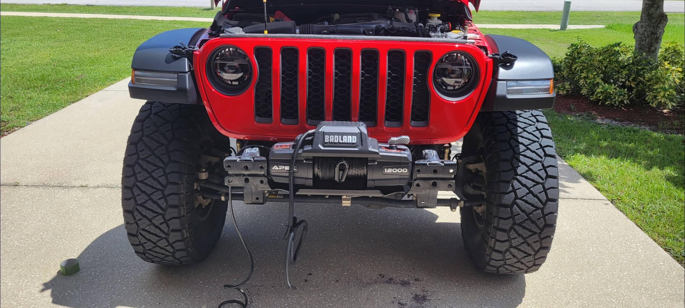

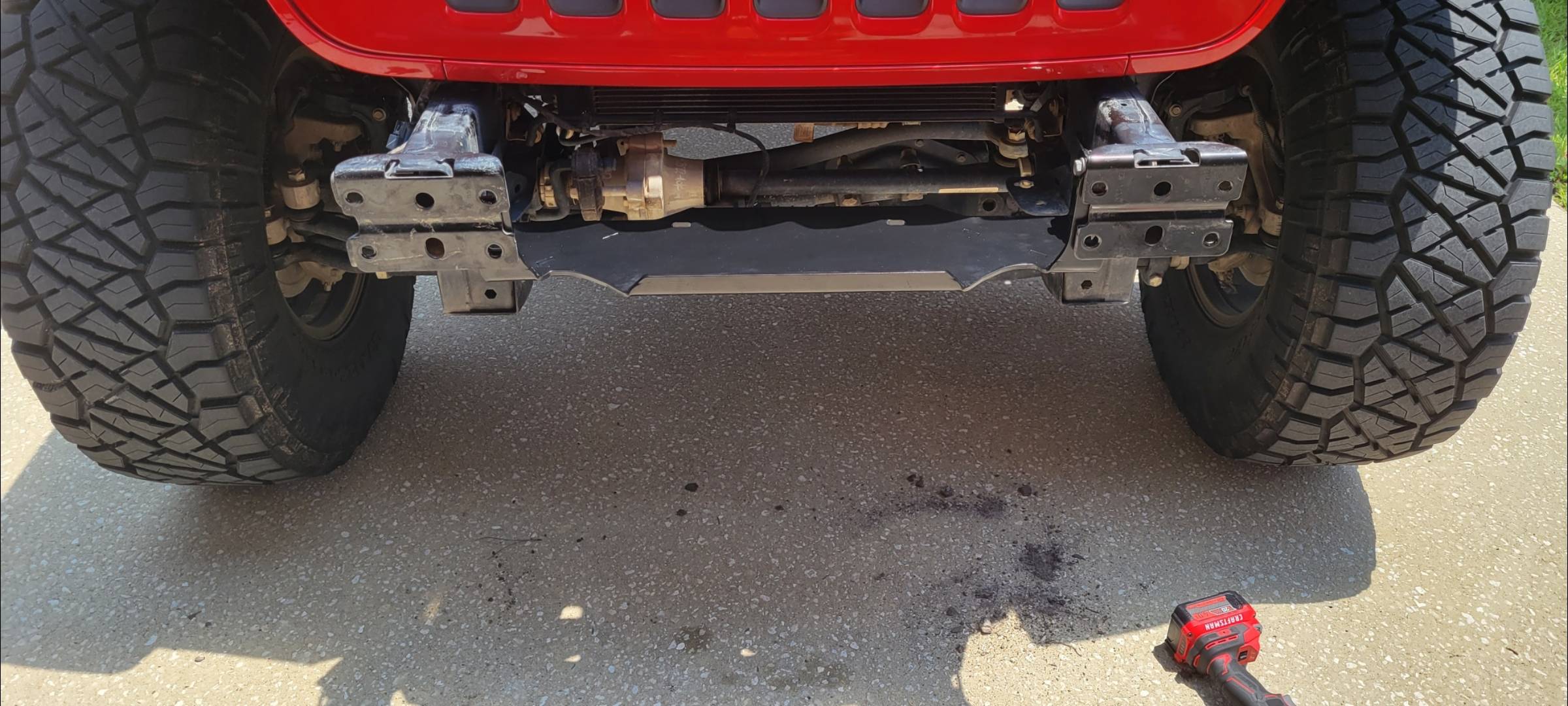

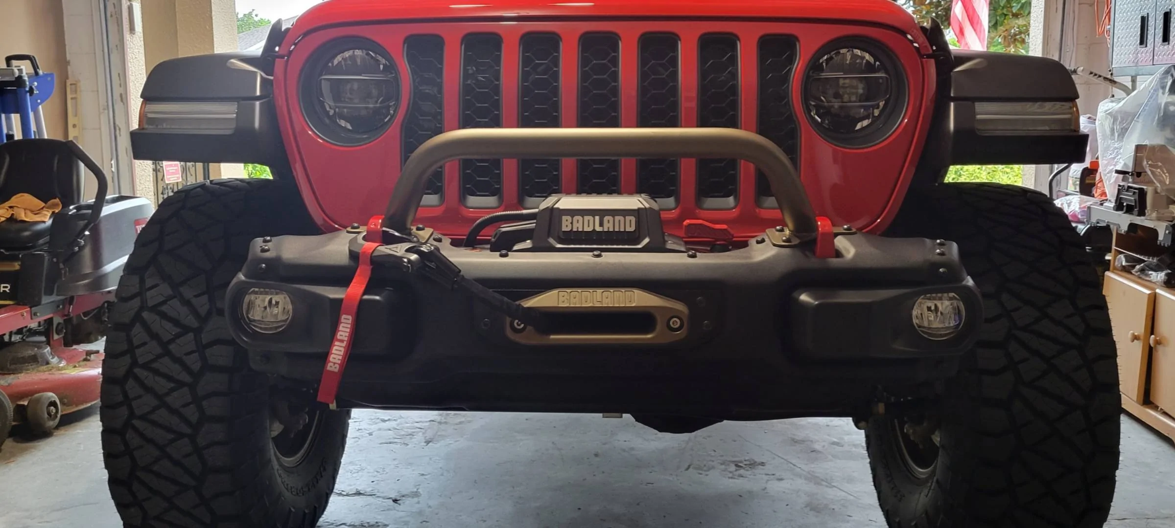

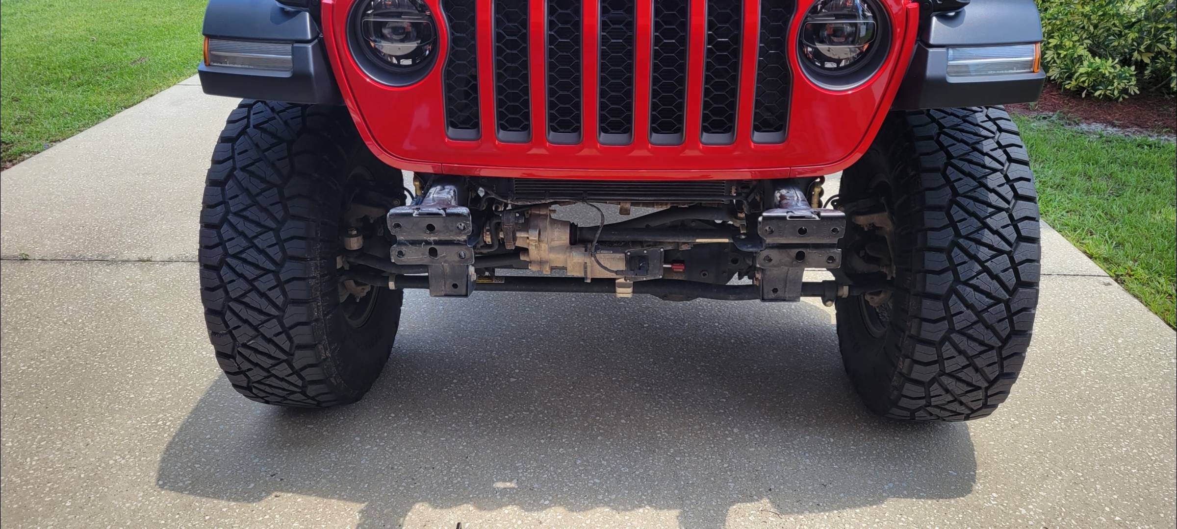

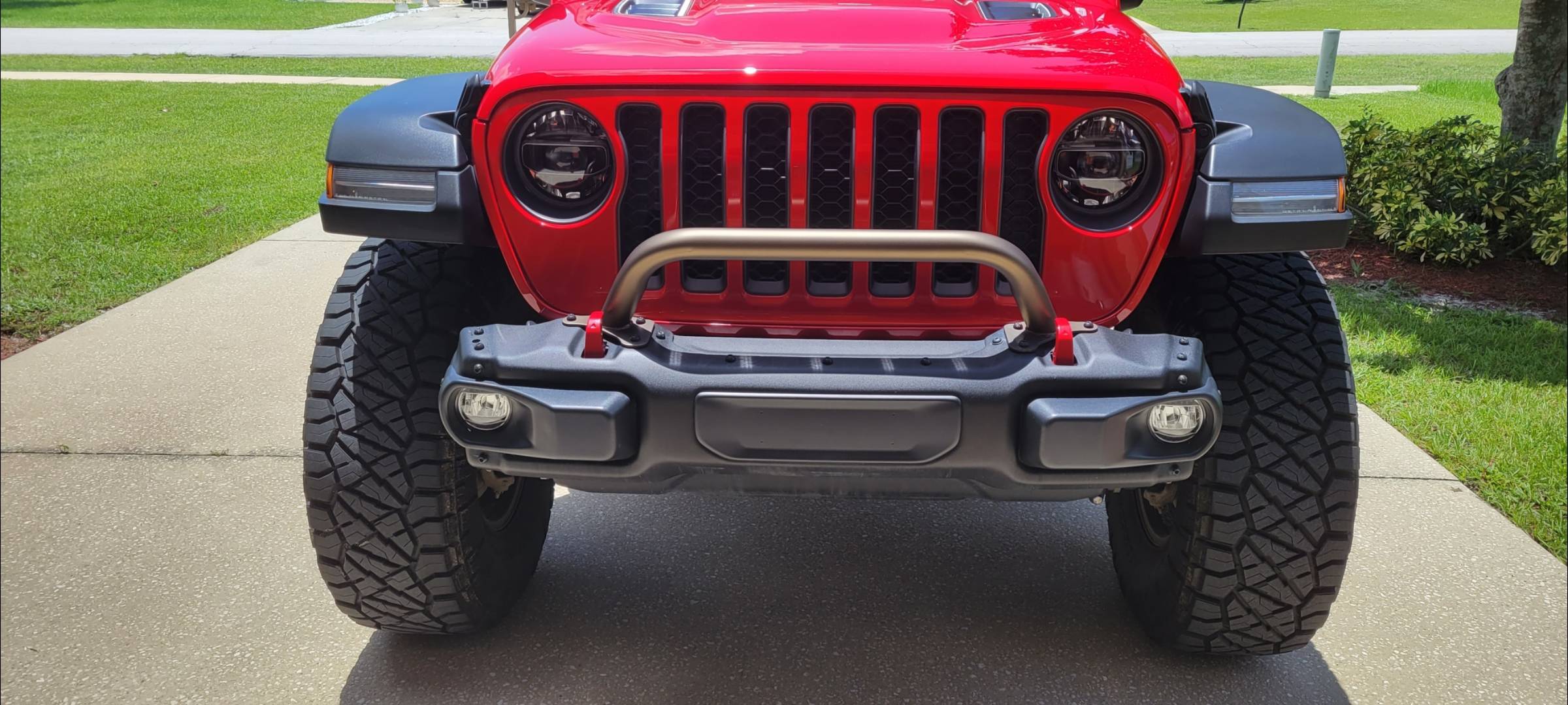

Please post some pics when you get your project complete. Here are a few pics I snapped during the install.
Jeep Gladiator Question about a winch install? 01
Jeep Gladiator Question about a winch install? 02
Jeep Gladiator Question about a winch install? 03

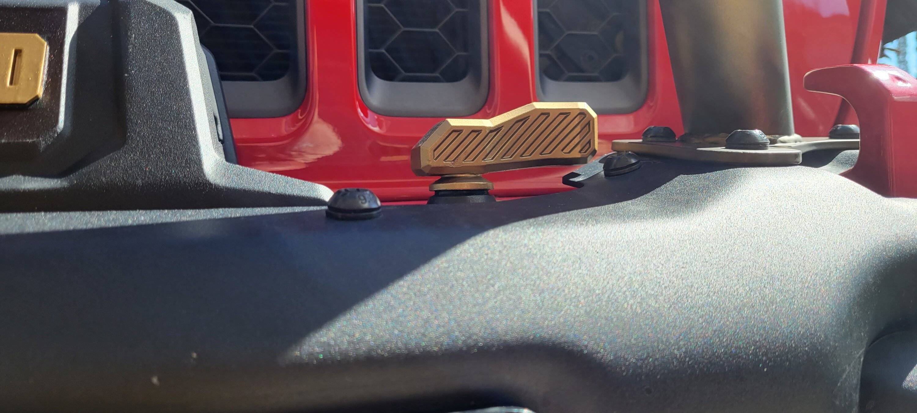

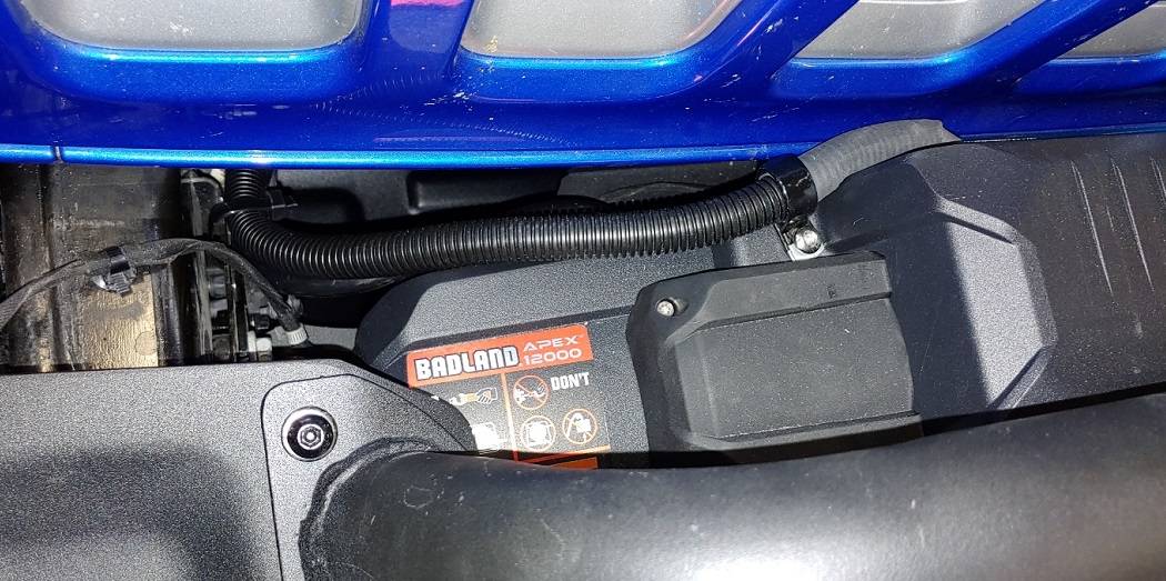

Yes with the Bulldog winch plate and the Rugged Ridge spacers there is plenty of room for the clutch lever, no trimming, no drilling needed. I did however relocate the wiring to the side. It probably would have fit but with it on the side it looks clean and absolutely no chance of interference. I did the relocation while waiting for my winch plate to arrive.

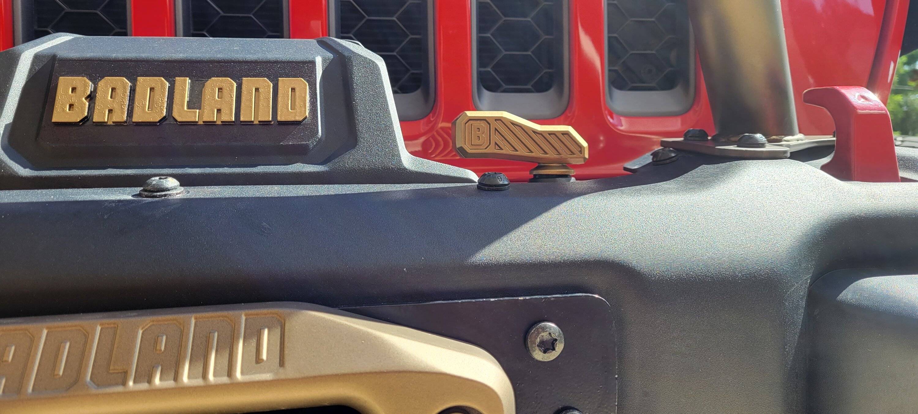

Some pics showing clearances.
Jeep Gladiator Question about a winch install? 20230903_161033
Jeep Gladiator Question about a winch install? 20230903_161045
250
40,624
54,315
Your bar didn't hurt the clearance any, either. That's the sort I want to get some day. My lever is already trimmed but your bar just looks nicer. I also like how it's closer to the tow hooks.
As far as the power cable - it can be done without moving it, but it would still be really close if a person wanted to pop the grill out in the future.

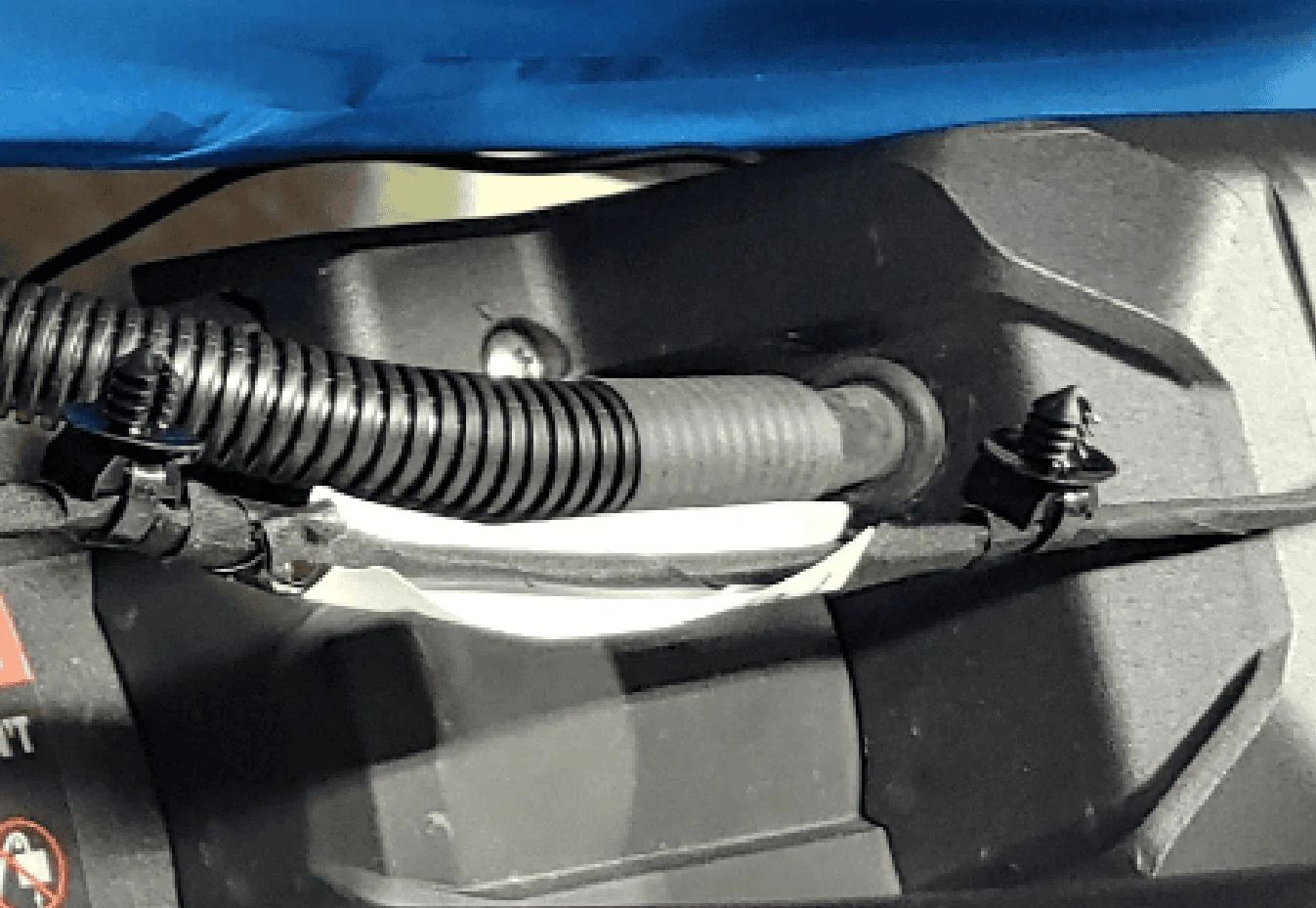

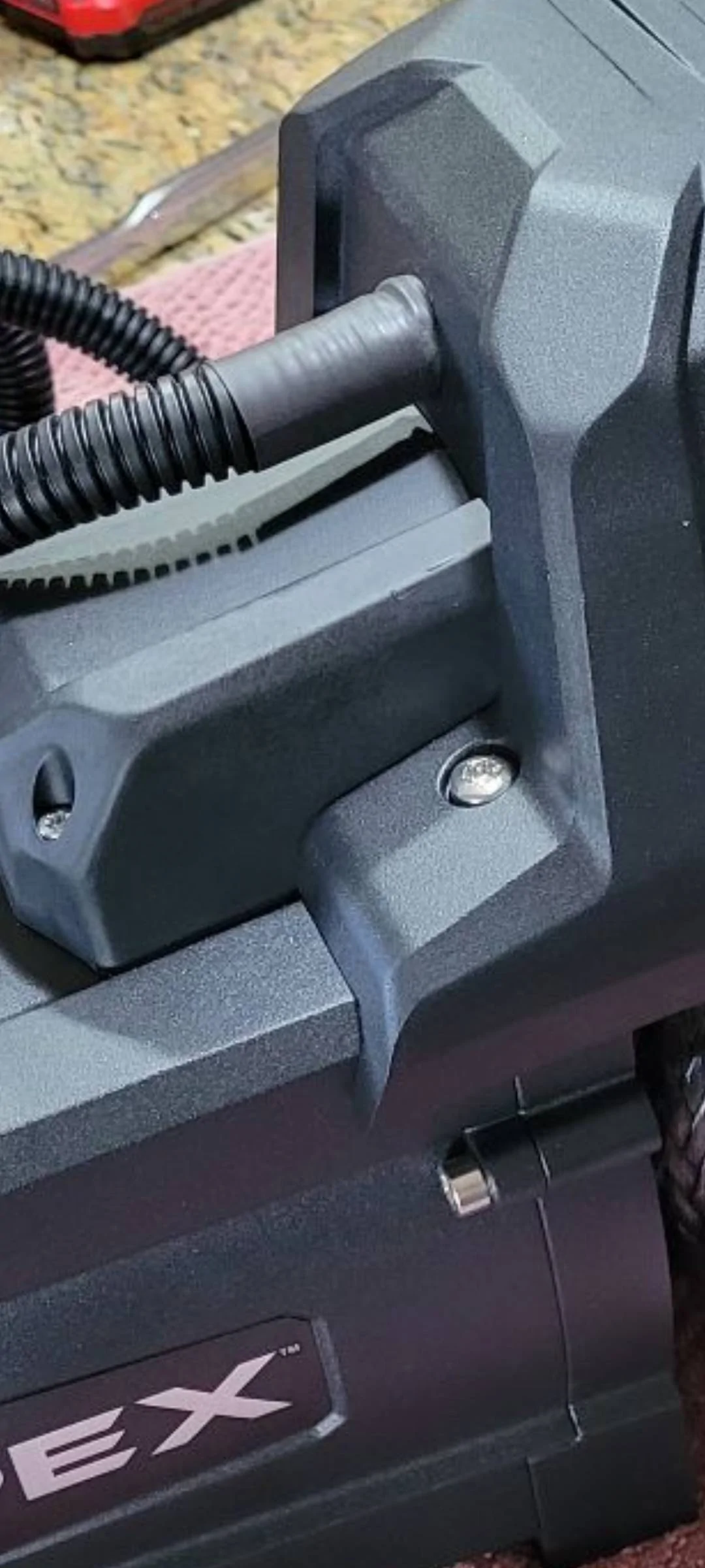

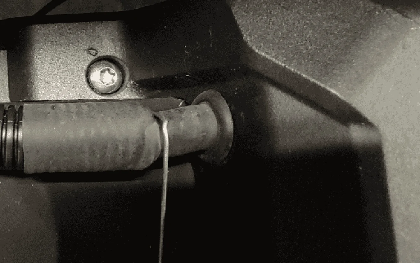

Nice install man! What's involved with the wiring relocation? I just picked up the winch and much prefer to keep it clean if possible. Just carve out a new hole for the wires on the side? Do you have an pics of that by chance?
Sempe-Fi Rubicon
Carl
May 21, 2022
602
1,461
Florida
2022 JTR - 2018 BMW 430i

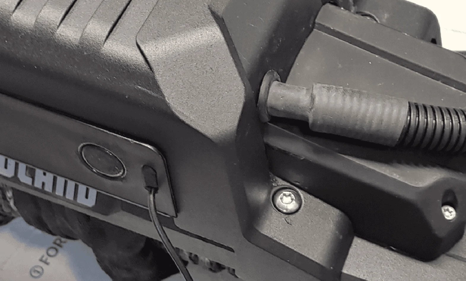

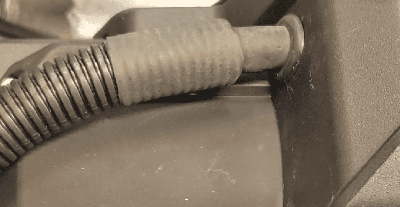

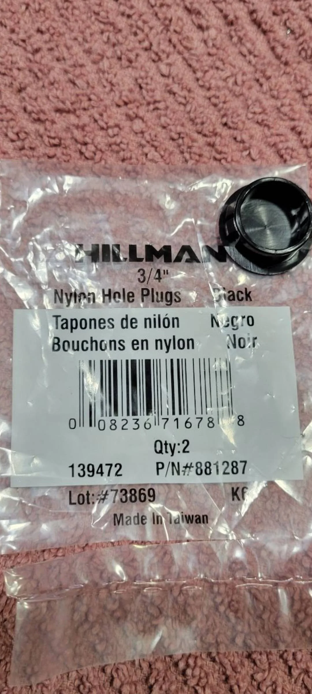

Yes just took a step drill bit and bored a hole to just a hair bigger than 1/2 inch. There is a couple videos on YouTube showing the process. I picked up a plug for the original hole in the back from Lowe's. Sorry, these are the only pics I have.

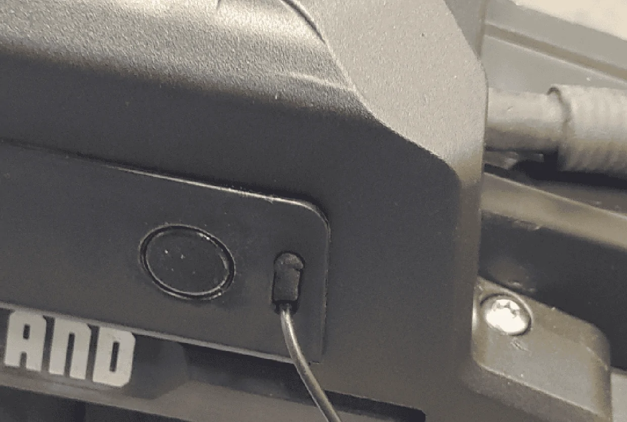

Jeep Gladiator Question about a winch install? 1693876117661

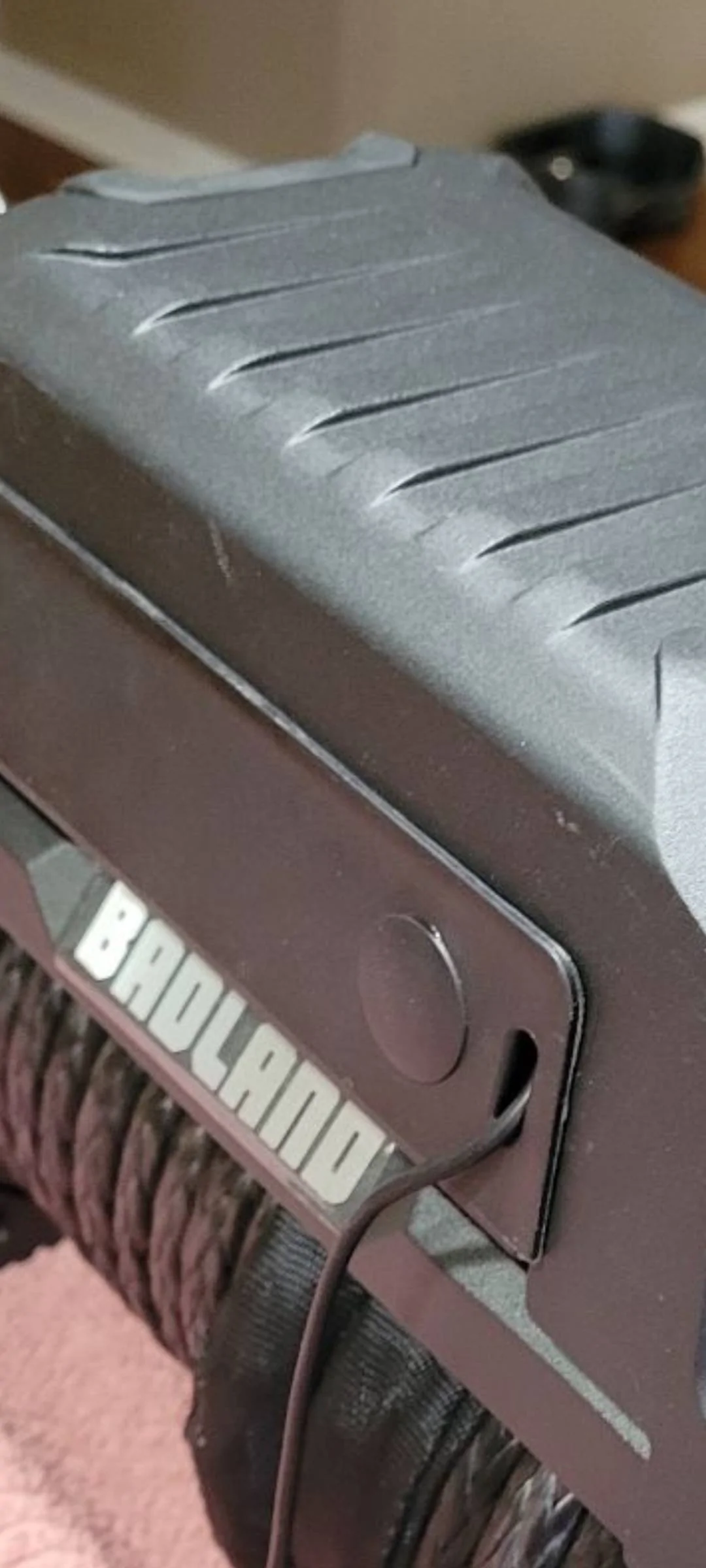

ignore the silver wire - it's holding the end of the rope up out of the way.
Jeep Gladiator Question about a winch install? 1693876190587
I have an assortment of grommets with no center hold cut out and used one of those to plug the back hole. A piece of dense foam plugs the slot for the small ground wire.
Jeep Gladiator Question about a winch install? 1693876276100
Jeep Gladiator Question about a winch install? 1693876312673
Jeep Gladiator Question about a winch install? 1693876348400
