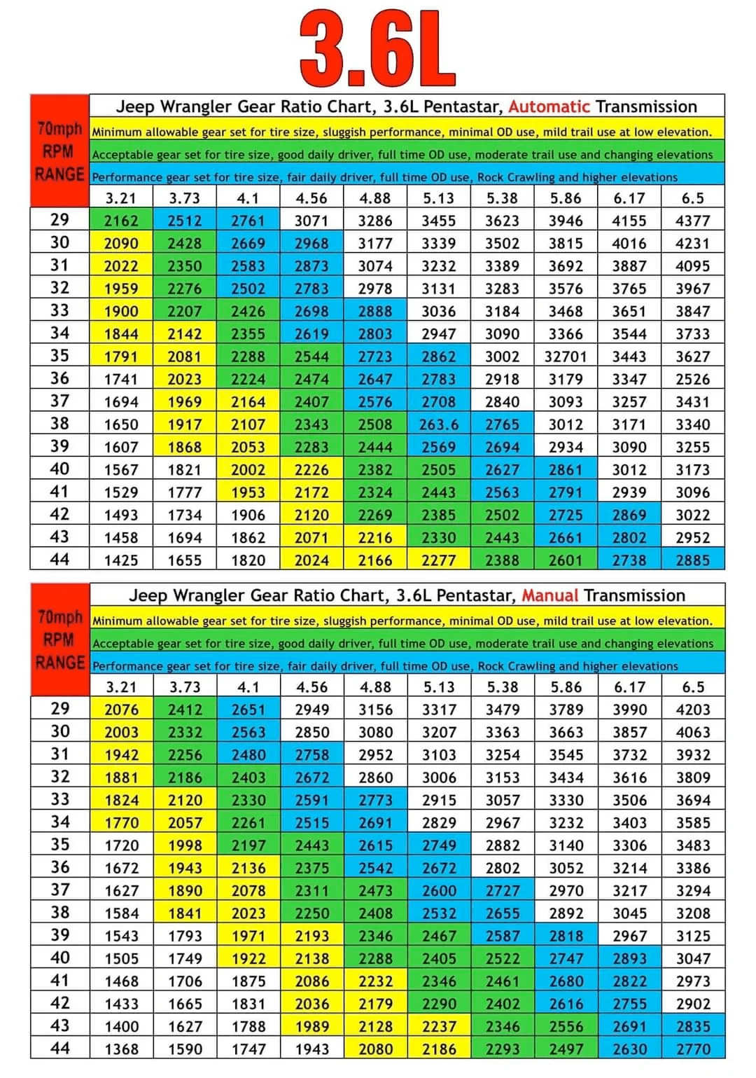

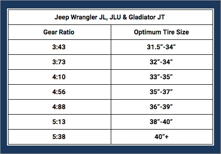

Not that this info is definitive, this site recommends:https://4xstore.com/news-tech/what-...-jeep-wrangler-jk-jku-jl-jlu-or-gladiator-jt/
And while this is the chart for the Wrangler, I suspect it's not far off from what the JT would need:
Back to your request, I don't have experience on 35's with 5.13's but I think those gears would be too tall.
That chart is for the jk, not the JT different transmission, use the link to Grimm off-road instead.
