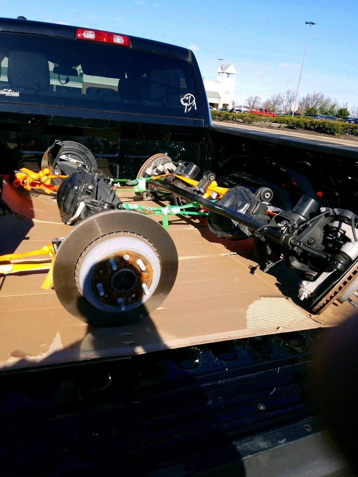

Picked them up. Now I just need to find the time to get after it.
