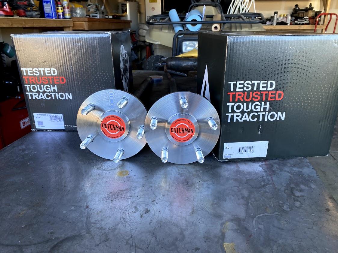

First parts arrived today.. And the last parts ordered.. This whole locker thing is starting to feel like a real thing. Hopefully the RCV Shafts dont have to be made. If they are in stock I should have the rest of everything in about 10 days or so.

Another Major milestone passed... All the parts exist. Everything is either in my garage or at Dutchman Axle (who is local & only about 2 blocks from the shop I am having do the install). So now for the hardest part of the wait... Waiting for the shop to get me in & get it done.
