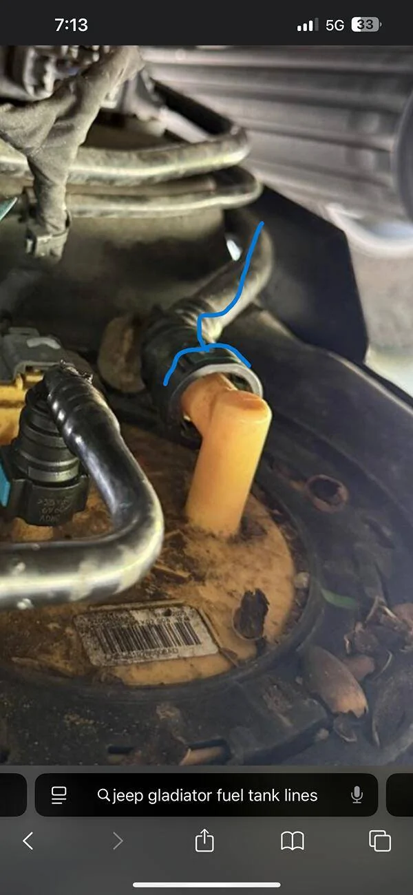

Hello all,
First post. I recently bought a 2021 Gladiator Overland. This morning it would not start and when it finally stopped i heard something pouring on the ground. It was of course gas. It sprayed the driveshaft and the muffler. I proceeded to lower the tank and found that a previous owner had used a very short piece of 3/8 fuel line to do a repair. The high pressure line that feeds the engine from the pump had the end broken off. the fuel pump side is fine. I went to the local crown parts dept and they were not sure which line it is due to the engineering drawings not matching how it really follows the gas tank. I did not take a pic of mine, but I do have a picture i found online. I have circled the line I need to replace. Do you guys know what the part number is?
Thanks!
Jeep Gladiator I need help finding the correct fuel line part number IMG_5729marked

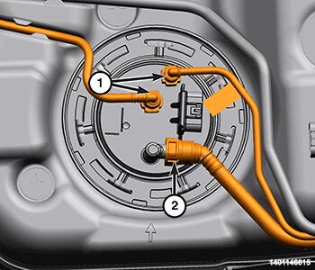

1 - Fuel Supply and Return Lines
2 - Fuel Tank Purge Line
Looks like the purge line, marked #2. The other 2 lines marked "#1" are fuel Supply and Return
From 2023 Gladiator Alldata service manual.
Jeep Gladiator I need help finding the correct fuel line part number 1753539358097-e8

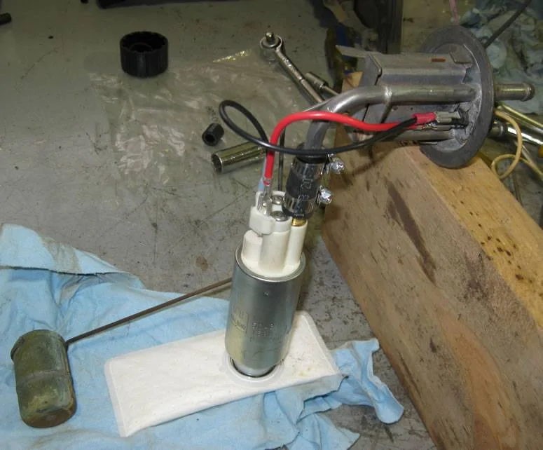

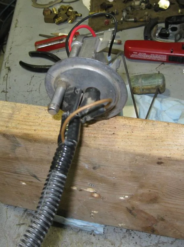

And here's mine - a Jeep fuel pump using my modified sending unit that carries the pump current through connectors I salvaged from an old Jeep tank and used on my sending unit.
Electric pump and wires inside the gas tank, connectors right next to fittings that I suppose could fail, maybe.
Jeep Gladiator I need help finding the correct fuel line part number sx4-pump-028
Brown wire is original to sending unit in the tank, the others I added to power the in-tank pump I put in.
And - I use the same type of fuel line fittings used for years on Jeeps, etc.
Jeep Gladiator I need help finding the correct fuel line part number sx4-fuel-sender-001

Well that's what I get for not taking a pic as I dropped the tank the first time. It indeed is #2. 68332306AB. The one on the left not the one I marked.
I will share something I have noticed. When I first got the jeep I noticed that it had a hesitation at low throttle takeoff, especially up a hill. You could feel the changes in power. I thought at first that the injectors needed cleaning and ran a bottle of SeaFoam through it. Since I repatched the line "waiting on new part" I noticed that all the hesitation is gone now. it runs like a champ. The previous repair must have crushed the old plastic hardline and restricted flow.

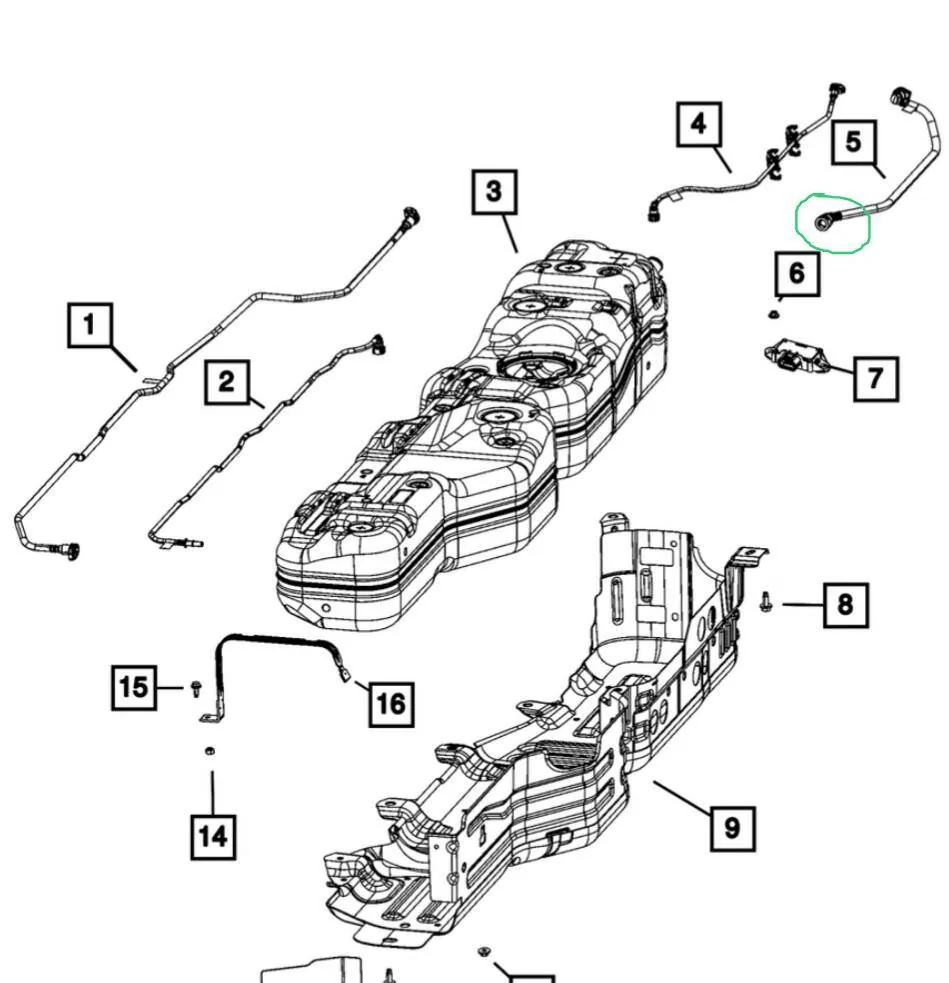

There is a Fuel Supply Jumper bundle listed but with no images. Its part # 52029784AC
Based on the connector's orientation though I believe it's fuel vapor tube part # 68369897AB , Shown as #5 below.
Jeep Gladiator I need help finding the correct fuel line part number 1753741497914-df
- Benny

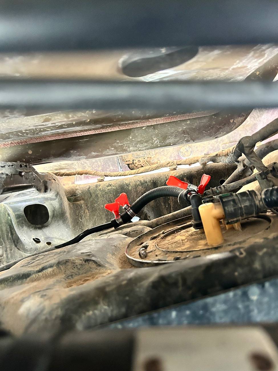

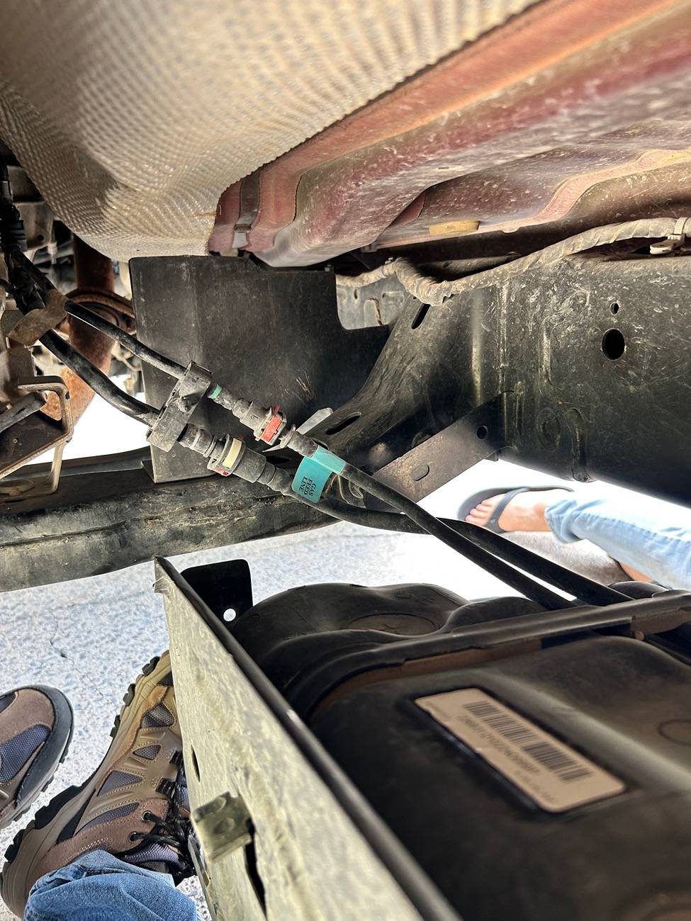

It’s definitely the feed line. Goes from the pump forward towards the front of the jeep. You can see in the attached pics where I recut the hard line to get the elbow out of it. That way I could sleeve it up further. The nipple on the fuel pump that I attached to is also part of the original line. It makes a 90 and clips downward on the pump. Look as if it is missing the safety clip as well. 🤦‍♂️
Jeep Gladiator I need help finding the correct fuel line part number IMG_5731
Jeep Gladiator I need help finding the correct fuel line part number IMG_5734

Got it, I would have to go back to the "Fuel Supply Bundle" part # then 52029784AC which I have no images for. I was able to find this diagram in the 2025 JT listing but its missing for all other years
Jeep Gladiator I need help finding the correct fuel line part number 1753746249472-d4
Do you recall if it had zip tie clips attached to it?
- Benny
