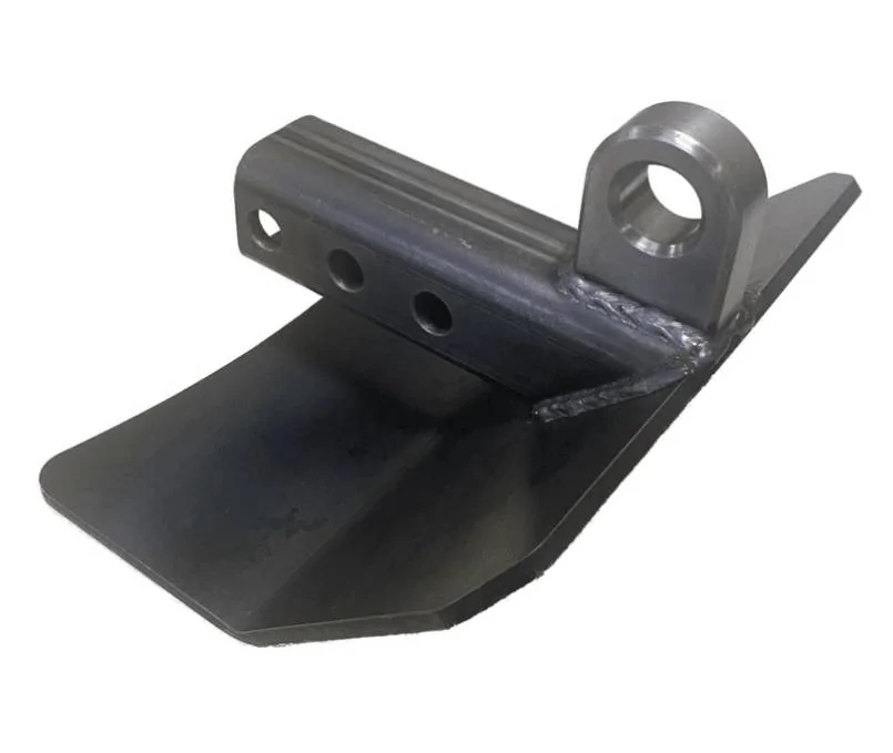

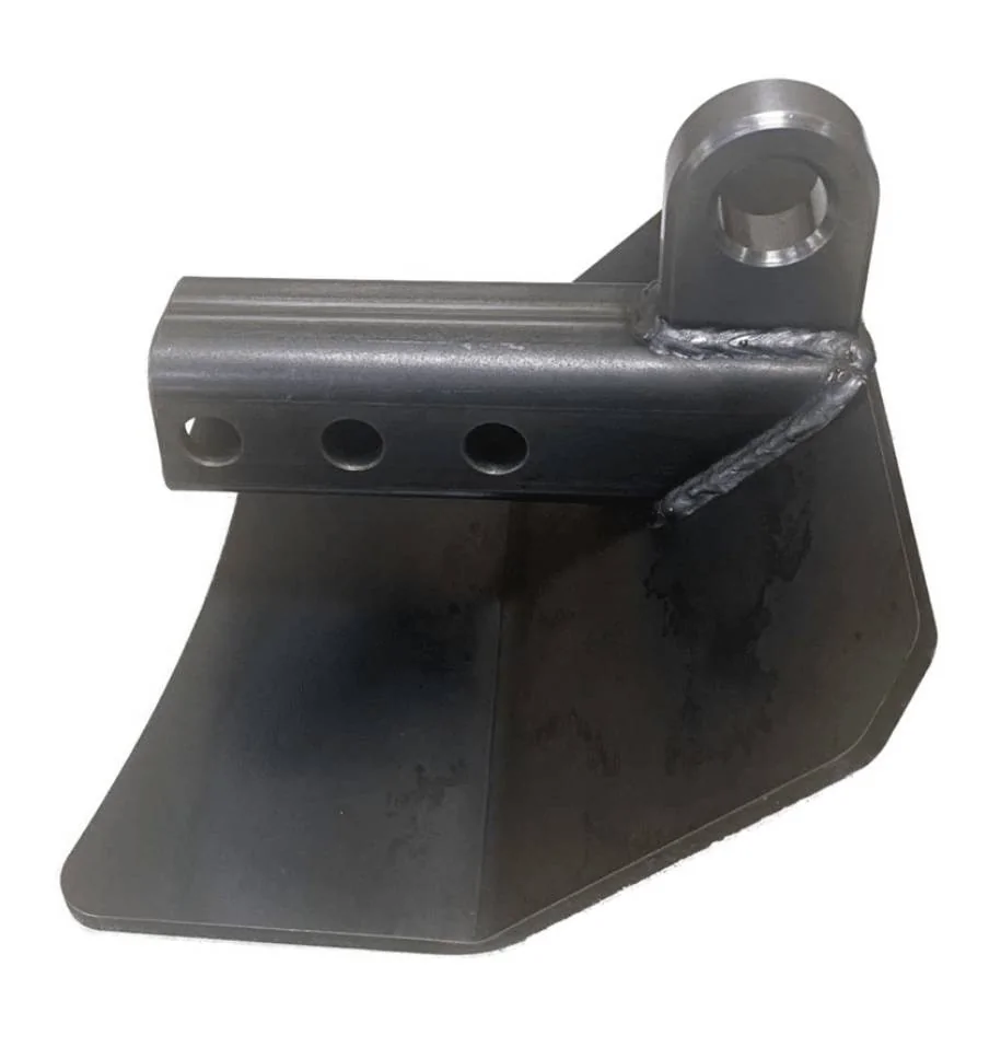

I just purchased an AJK Offroad Hitch Skid Plate w/ recovery point. They have two options, a standard and a short. I opted for the short in order to accommodate my 37" spare tire.
https://ajkoffroad.com/product/hitch-skid-with-recovery-point-short/

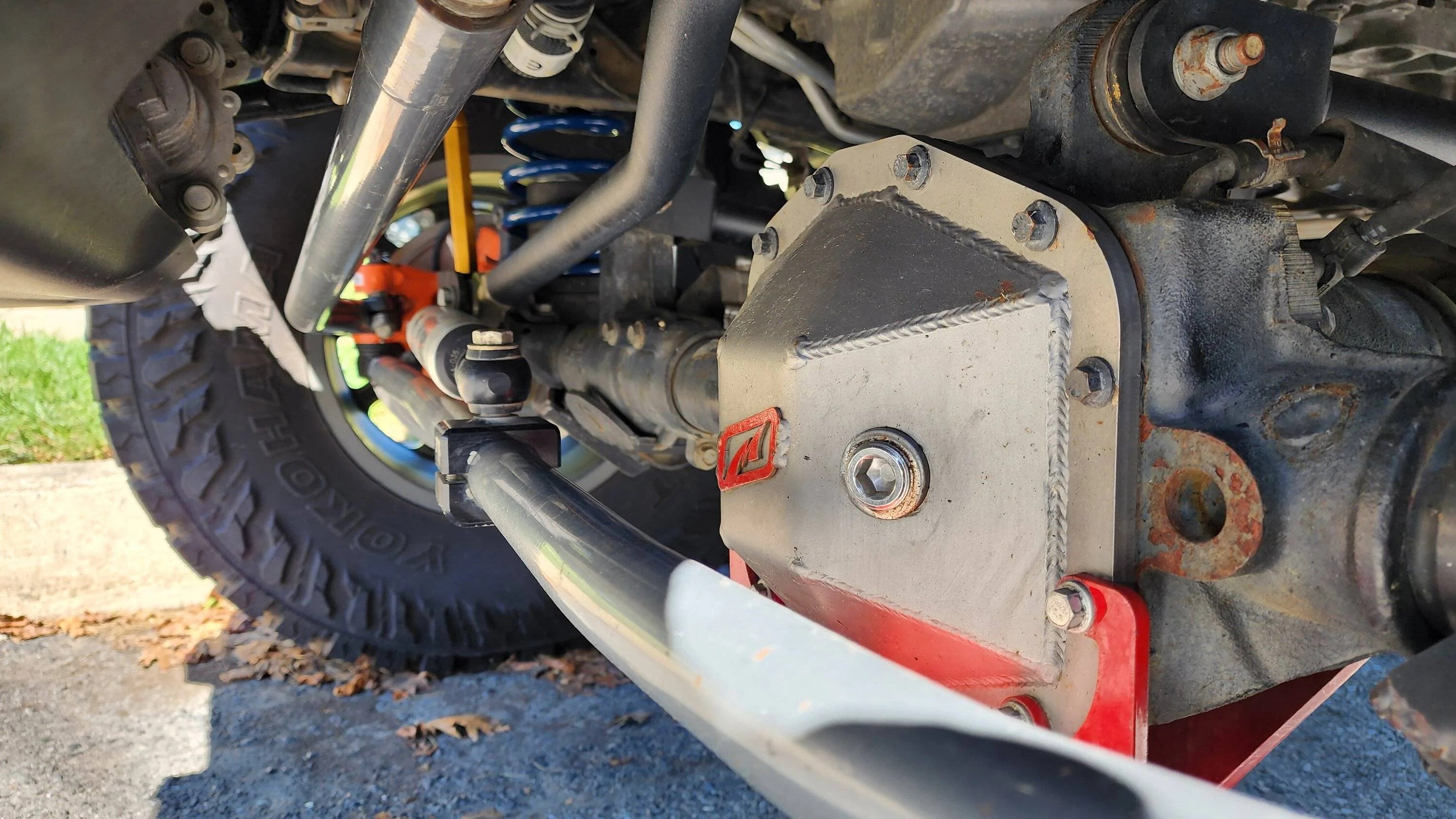

This is Steel-it over a bare motobilt diff cover. It's been fine for over two years now. I chipped it either swapping out my track bar or when I re-geared. Might get around to touching it up... some day. I spray it heavy first pass and let it dry for 8-ish hours then hit it with a lighter coat.

Great job, looks really nice. Glad to hear it holds up well.
