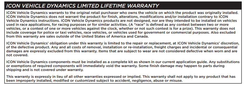

Did you do the installation or someone else?
https://images.iconfigurators.app/pdf/I22061_REVB_9246.pdf
1. I did. They asked if they were torqued properly. They are. These aren't complicated.
2. Two very good friends who are certified mechanics, part of the local off-road community and have installed suspension systems on several 4x4s. And I was there helping throughout the install.
Again, these parts in question are simple. One bolt at each end. It's impossible to get it wrong. They never made noise until recently. I suspect the heim joints are worn out.
I'm not asking anyone to diagnose my problem. I'm asking for suggestions to replace the parts.

Seems simple to me, with the warranty, but if you just do not want their goods again, why not either go with the Apex autolinks or a quality fixed set from Metalcloak, Terfalex, or another brand that isn't Rough Country.
