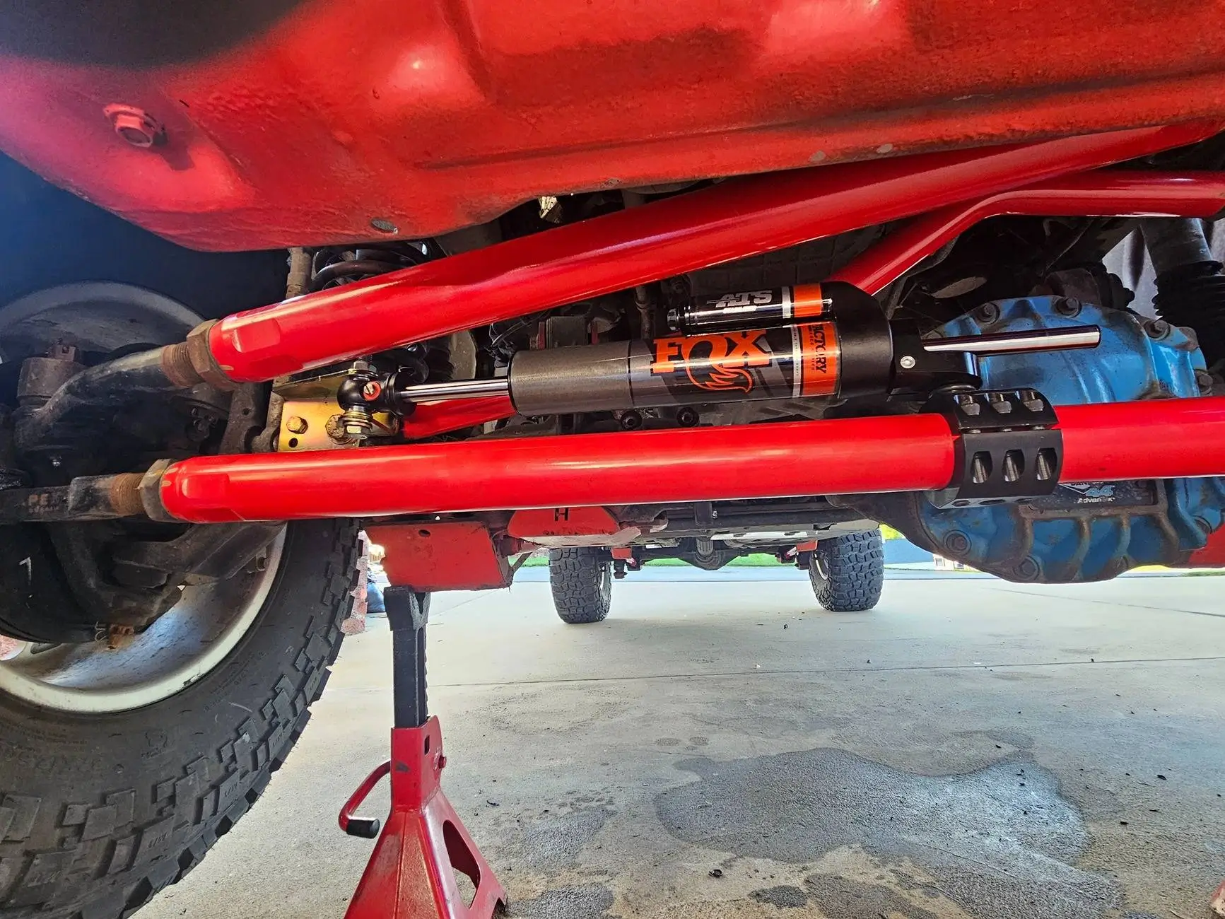

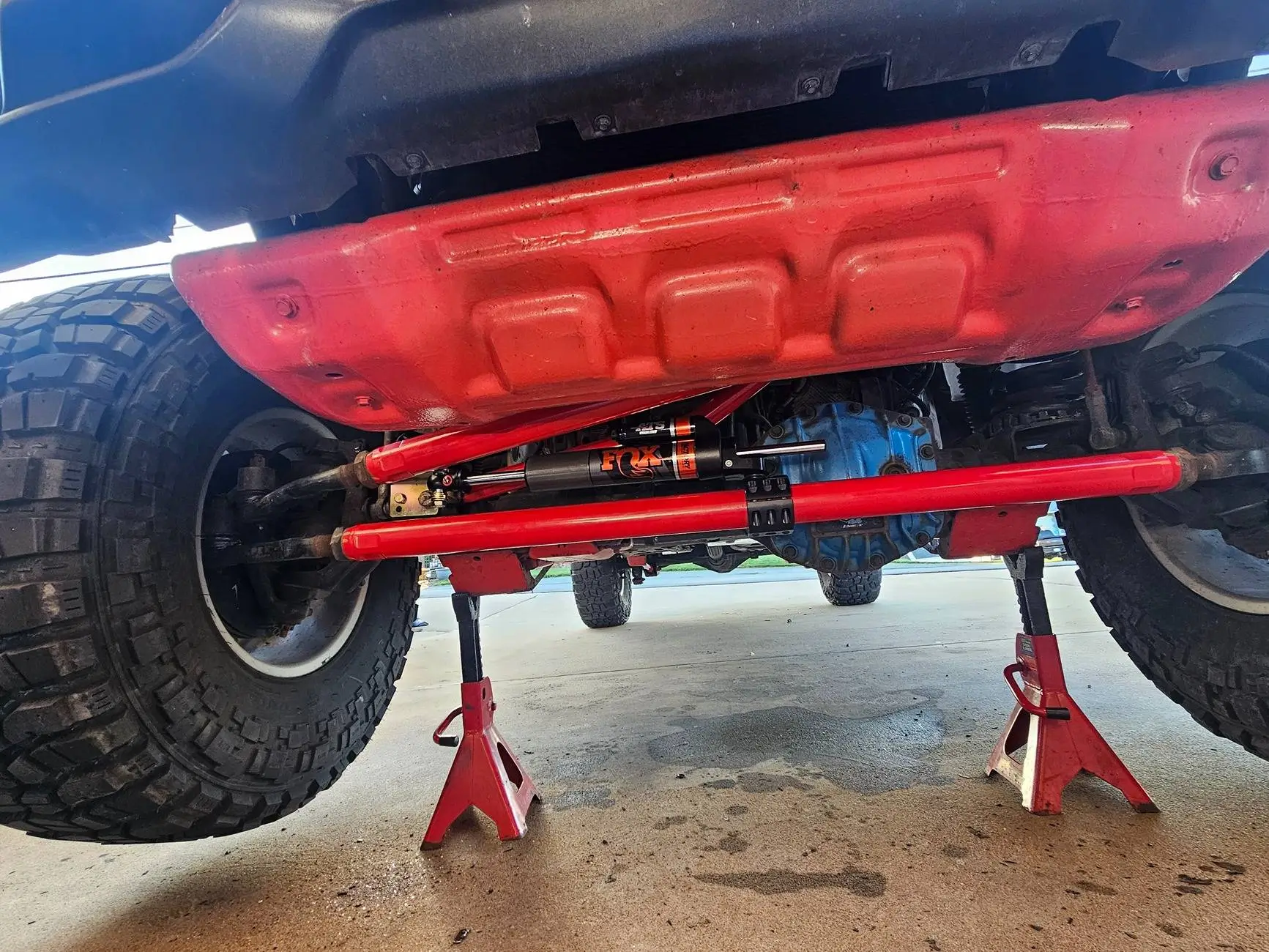

I installed the Core linkage a year ago. Still nice and tight. If you get the Core linkage. Get the steering stabilizer bracket at the same time. The Core bar is 2" in diameter. It's hard to find that diameter.
