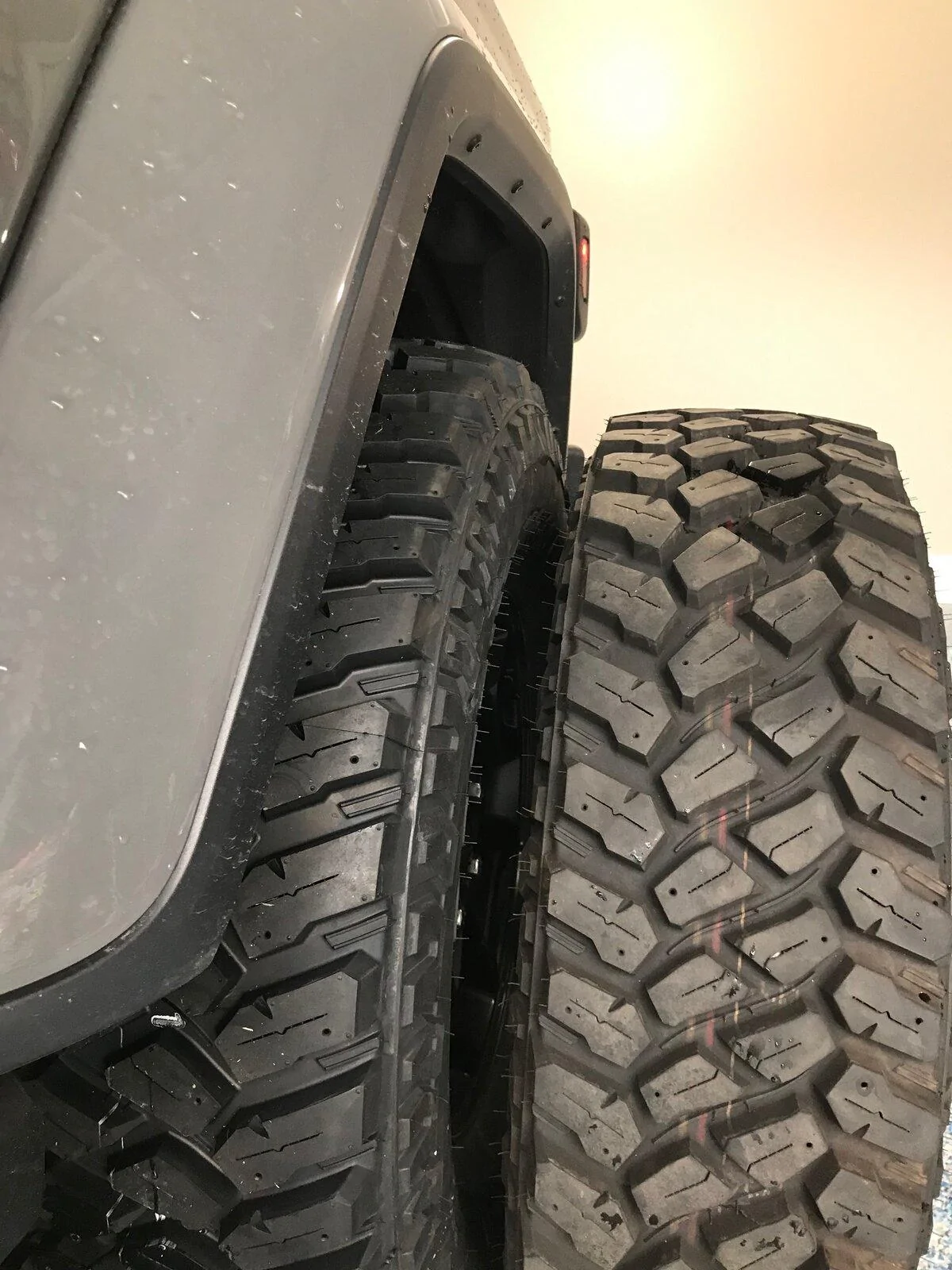

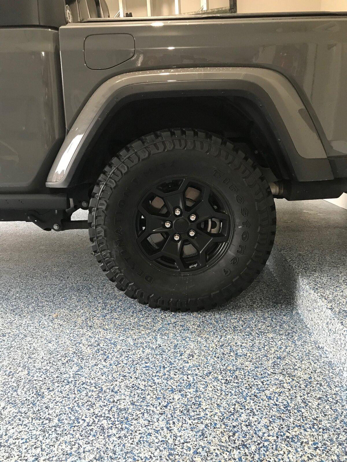

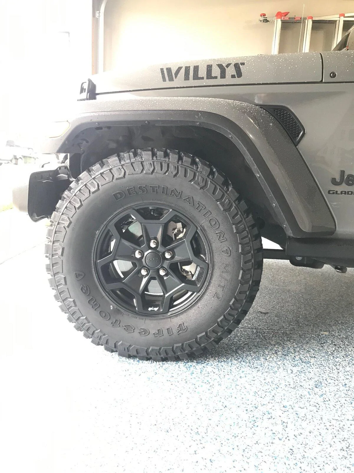

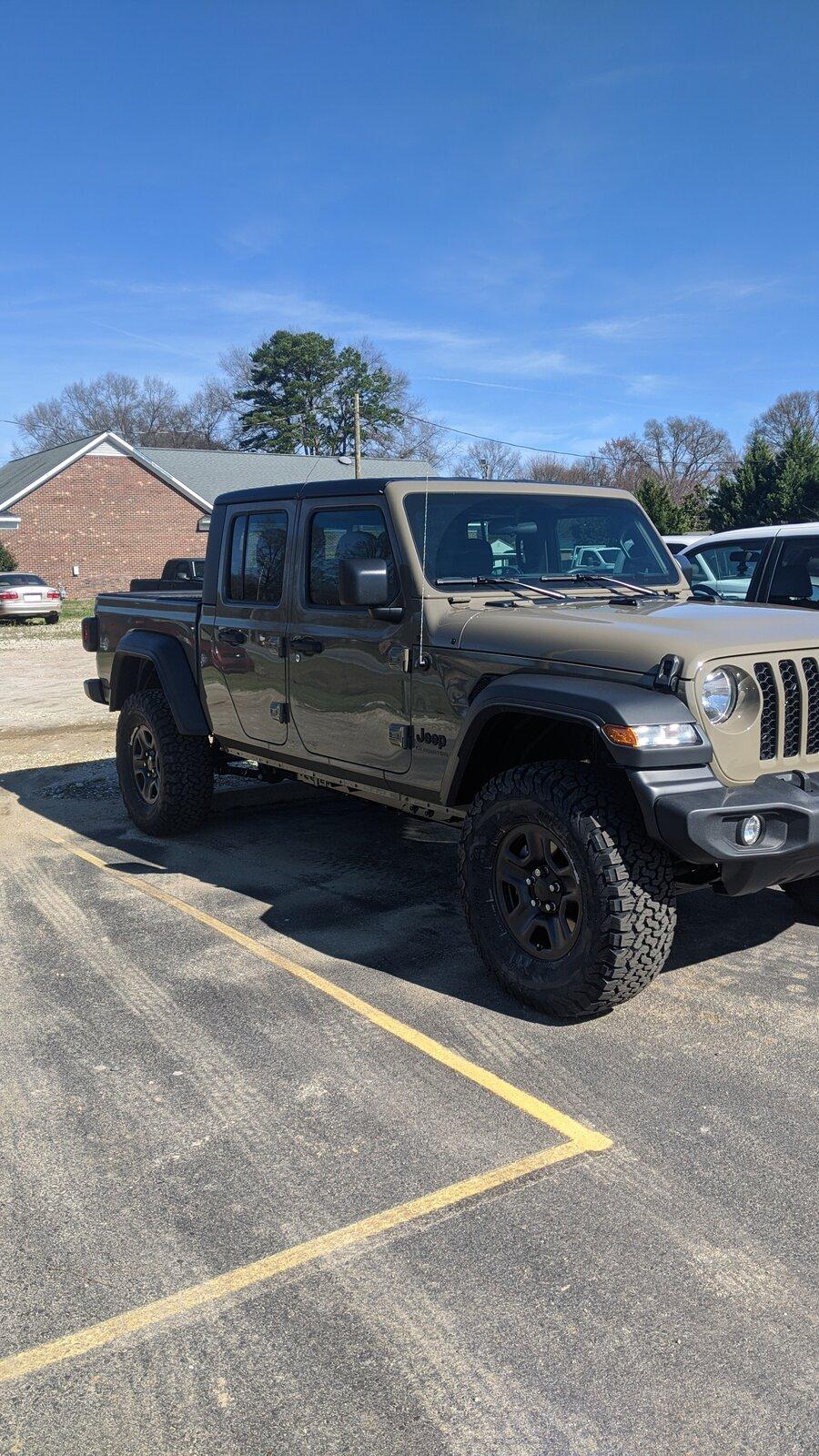

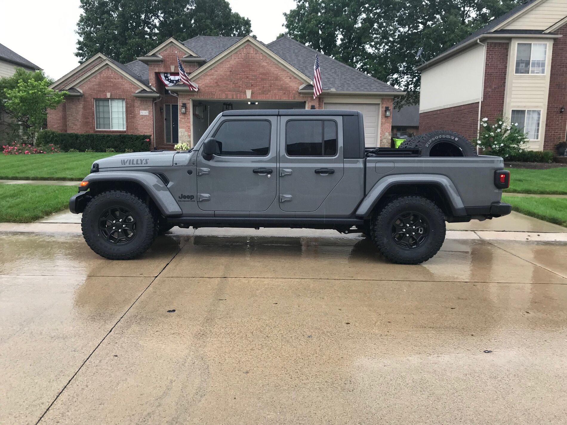

This is my Max Tow with 315 70 17 KO2s on it on stock wheels with it sitting at stock height.
Here is it with a 2.5" Readylift installed
No issues but mines a Max tow. The Same wheels on my buddies Overland resulted in him rubbing the lower control arms at full lock.
