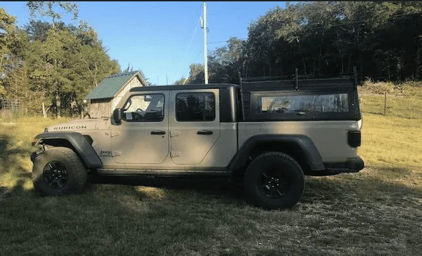

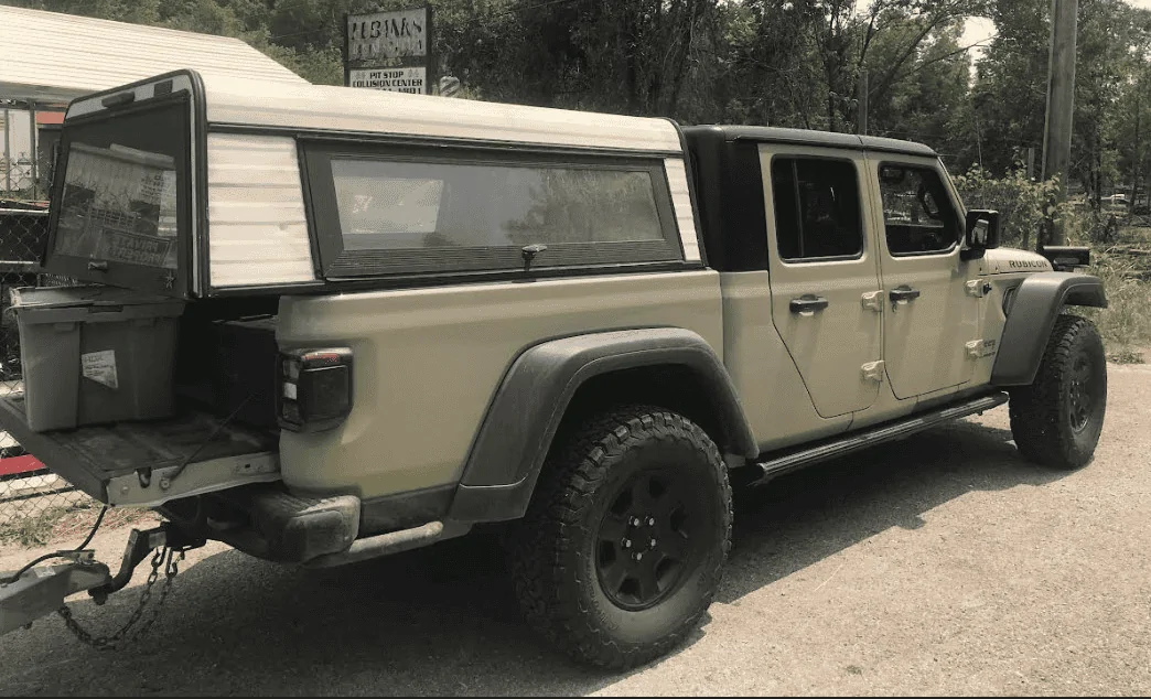

Hey folks, just thought I'd share my little project I just finished. Needed a camper shell 3, maybe 4 times a year & wanted one light enough to take off & on. As with my life, nothing is easy so after about 6 months of searching I settled on this one:
Jeep Gladiator Inexpensive But Functional Cap for JT 1693354156555
Width was good, height good but obviously a tad too long. No roof rack either.

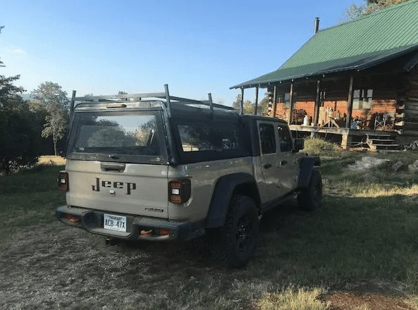

I found a bent-up rack at a local camper shell dealer, and went to work hacking away, took about 9" out of the length. This is what I ended up with:
Jeep Gladiator Inexpensive But Functional Cap for JT 1693354294337
Jeep Gladiator Inexpensive But Functional Cap for JT 1693354336965
Not perfect by any means, but the 3 doors are handy, the locks even work. And with one more bar over the cab, should be able to easily handle our canoe.
Total cost? About $150 including clamps, weatherstripping and paint. Just couldn't see paying what the really nice ones cost for what I need. Plus some labor, of course...

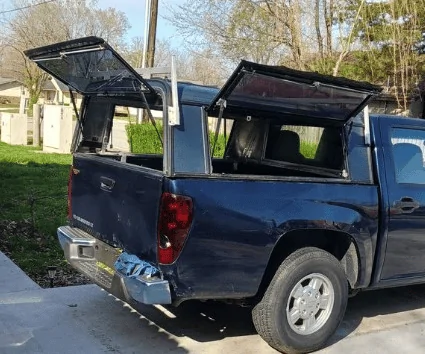

I am fairly certain a 1st gen Colorado short-bed topper would have bolted on with no modifications but they are Really hard to find.

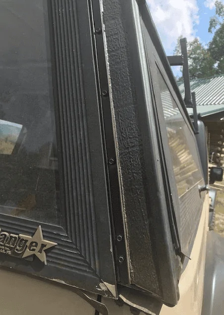

The whole thing is held together with these extruded aluminum strips that have sheetmetal screws to hold onto the frame. There is a plastic strip that covers the heads of the screws, it's missing on this strip. Same for the pieces the go over the corners.

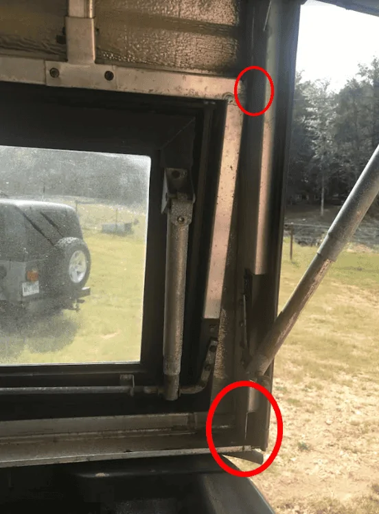

When I shortened this one, all I did was cut the back section loose from the frame, it was only welded in 2 places on each side, which are circled here.
