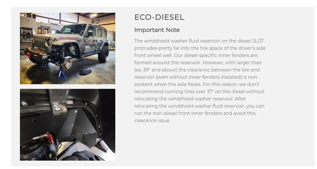

Im thinking of putting aftermarket inner fender liners on my truck when I go aftermarket fenders. I saw a comment on JCRs page they have only tested their liners with a 3.6 truck. Anyone know of inner fender liners that should work with the eco diesel ?

They do not fit .. maybe reworking the angles might work but I’d wait for someone to make the correct ones.
driver side the windshield wash bottle is in the way and it can be moved and a smaller one used(2 quart). Read on another forum.
Driver side the six battery box is in the way and it can not be moved but if you order the falcon 3.5 shocks you will have to cut the battery box for it to fit. Might do a small right up

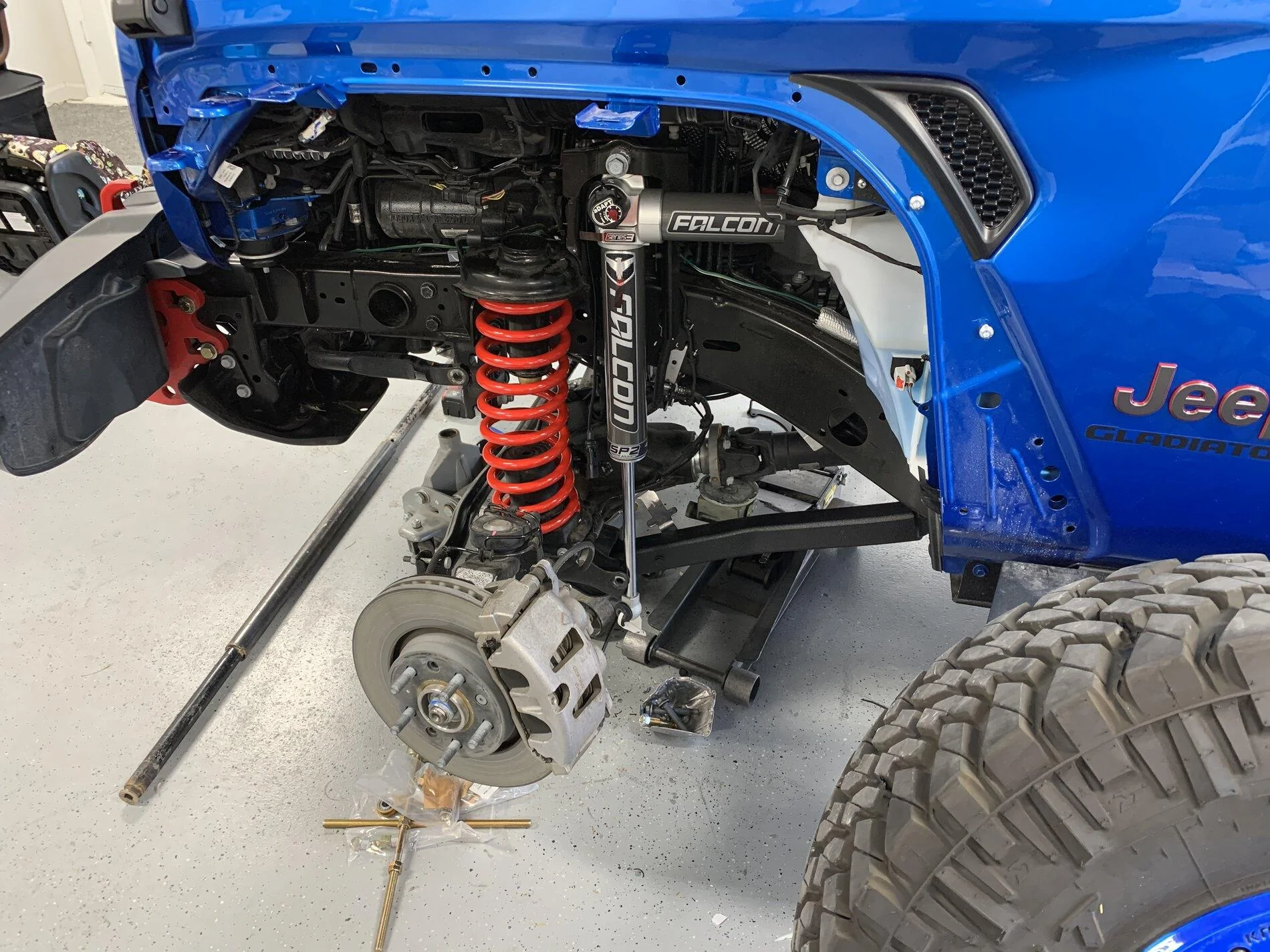

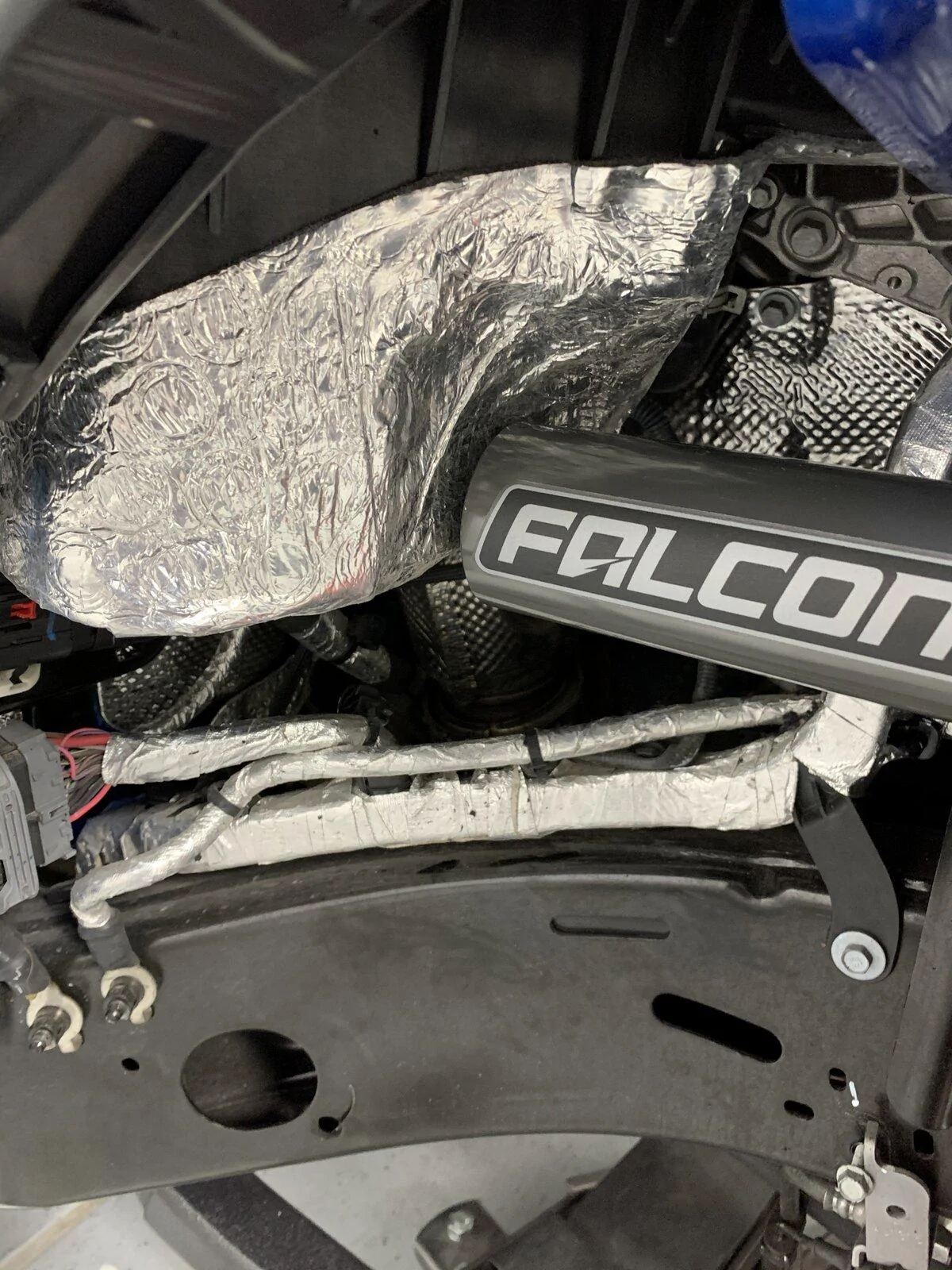

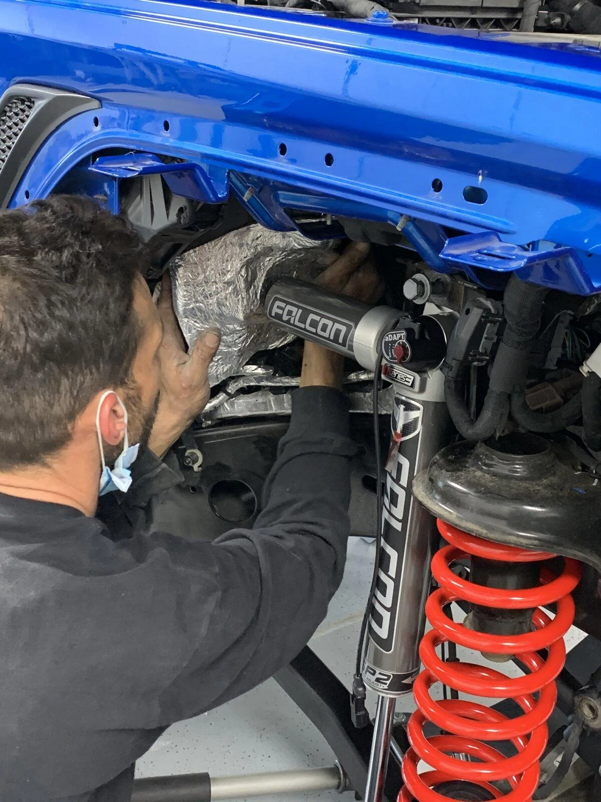

Jeep Gladiator Inner fender liners for diesel Screen Shot 2021-02-15 at 9.04.48 PM
Are those the diesel specific Falcon Shocks?
Don’t think there is such a thing.. will falcon 3.5 shocks fit a diesel ? Not just a bolt on but yes it will with a little mods..
Aux battery will need moved or replaced in a different spot and the aux box will need cut. Other than that nothing use is needed until you go to close the wheel well.. then it will take some mods for that to work also.

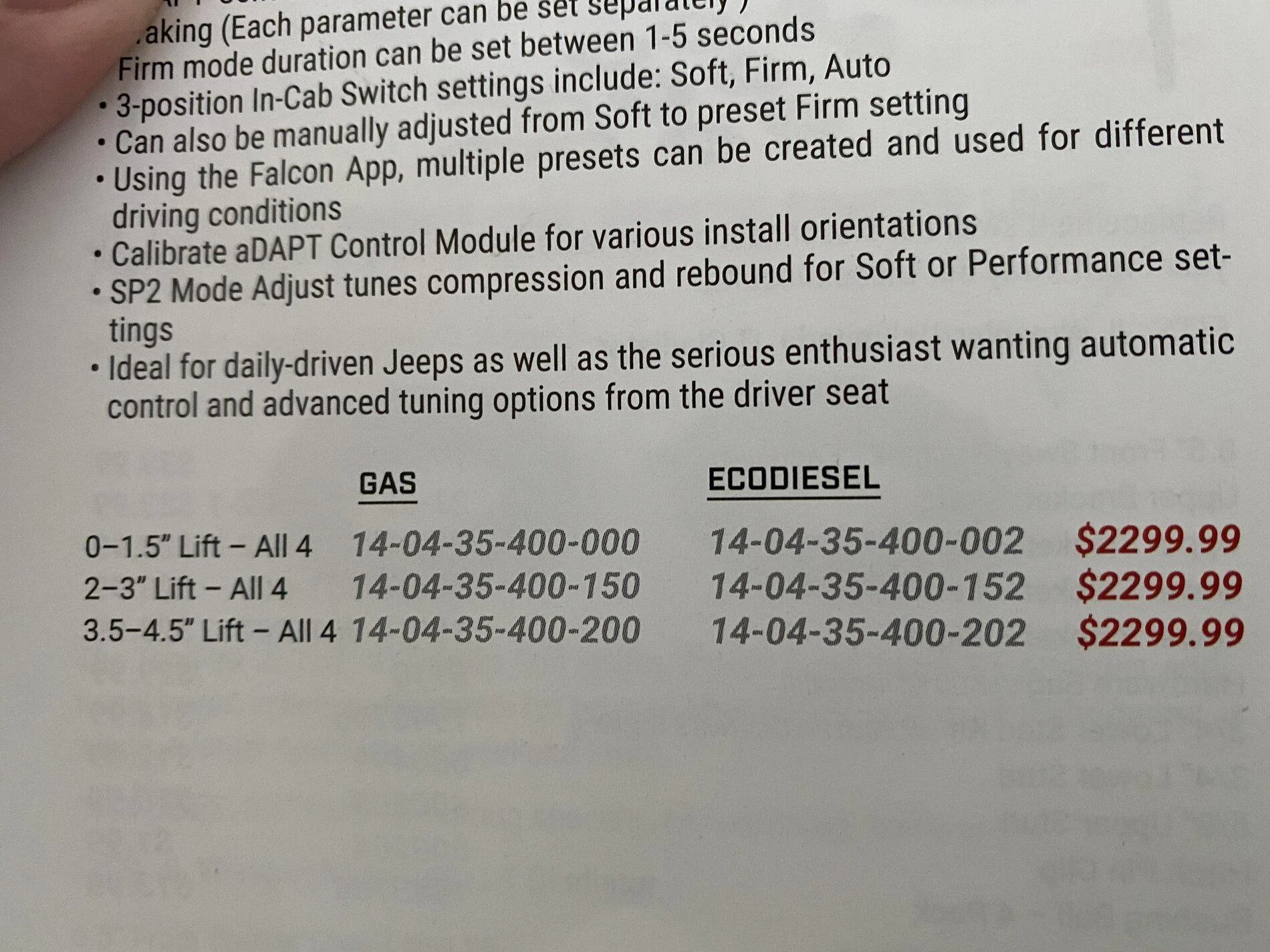

Falcon has 3.5, 3.3, and 3.1 specifically for the diesel models.

I would say that would be negative on a diesel fitment.. they would need to change the angle of the reservoir.. so I think you might have interpreted it incorrectly.. or maybe I did but geometry and aux boxes are what they are. The math doesn’t lie.
Also in the current catalog. They exist (I am a dealer) I am ordering a set for my personal Gladiator in the next couple of days.
