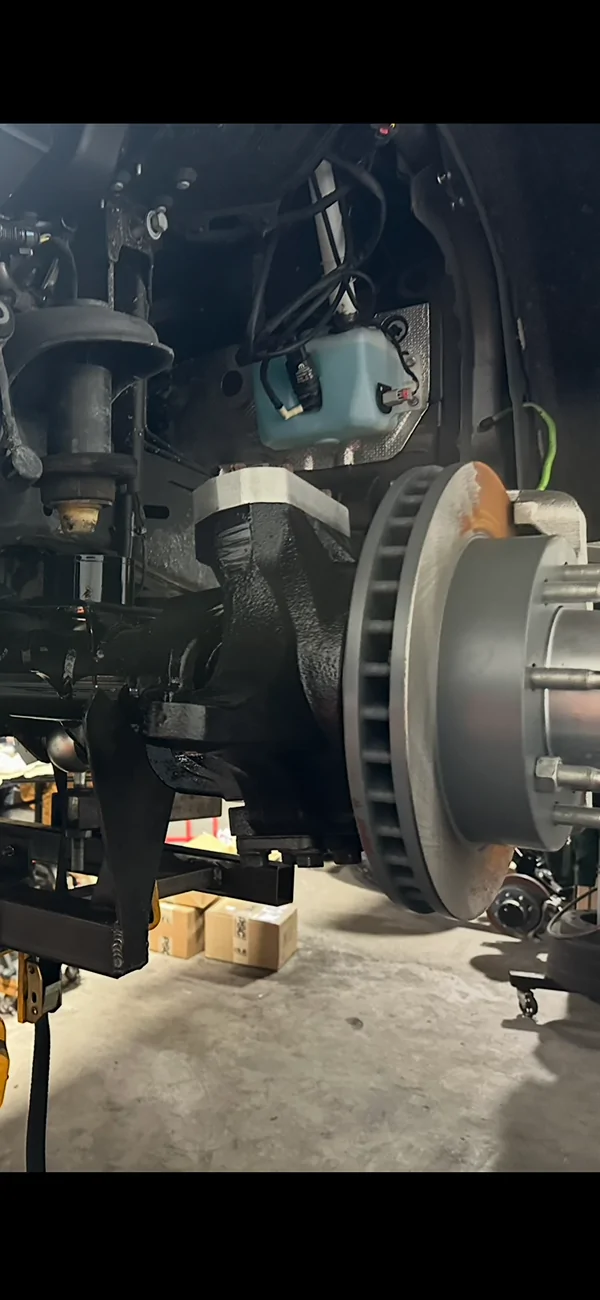

Big issue with the diesel is the windshield washer fluid bottle is on the left side and interferes with some of the aftermarket inner fenders. I have the American adventure labs fenders which are amazing, quick release. But I had to change the windshield fluid botttle to a smaller version to get them to clear. Motobilt makes a kit but it’s expensive. I just bought a smaller tank and swapped the neck and motor over. I am on about 4 inches of lift and 40s with 72.5 inch wide fusion 60s, clears at full turn and suspension cycle.

I have the KMC desert beadlocks 4.5 inch backspacing and 40x 13.5x 17 Pats, going to Nittos soon. I have the stock rubicon flares but split them to gain the extra clearance and did the American adventure labs fender lights. Definitely cheaper just to get a different bottle, like 25 bucks and Mount it in there.
