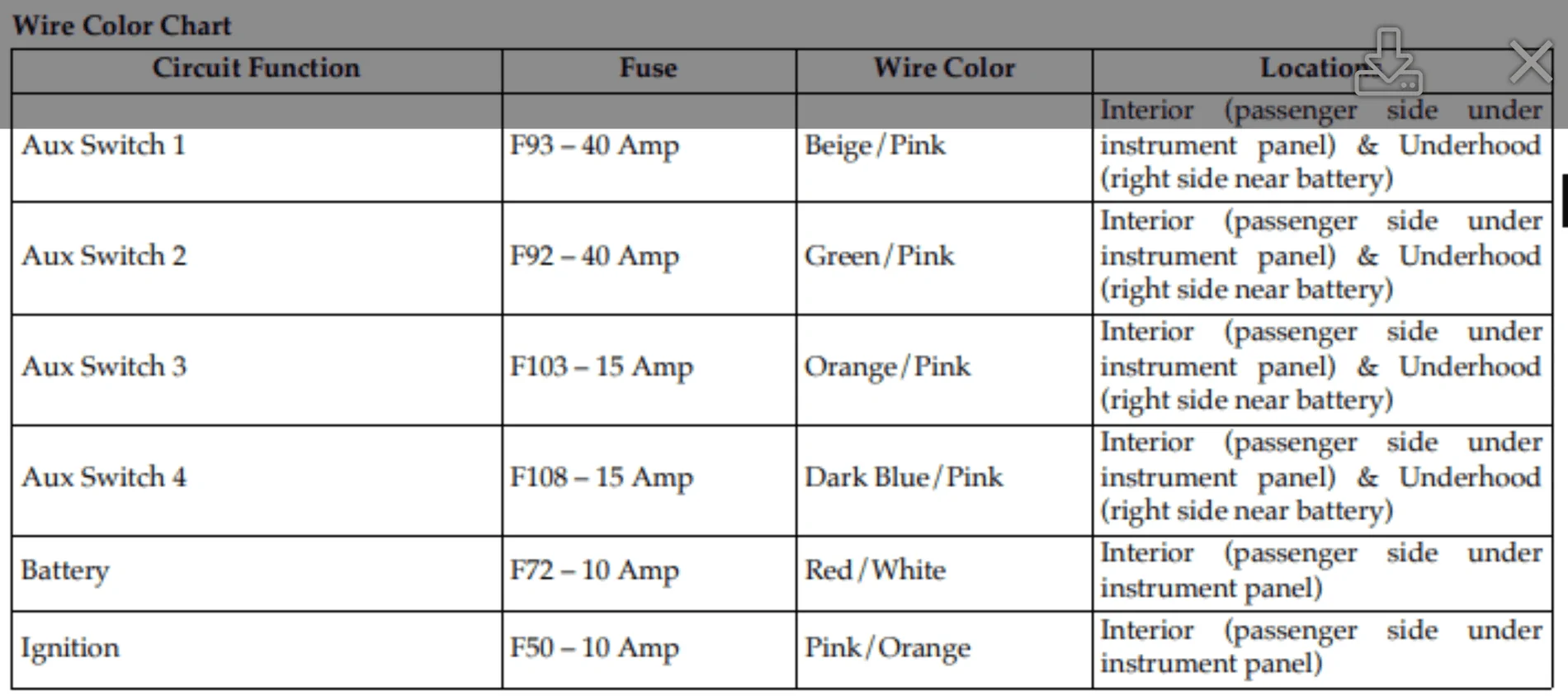

I was just told there is a wiring harness under the carpet on the passenger side below the glove box.
I haven't looked yet so I can't confirm this, but it's worth a look.
This may also help in your endeavor.
Jeep Gladiator Install Interior lights to AUX switch Screenshot_20210607-193256~2

Okay, there are wires in the engine bay and behind the glove box, yes, both places. Inside it's not under the carpet, just wrapped in with a existing harness bundle behind the glove box, not hard to find. Like the above chart there are 6 wires, four of them can be on your aux switches. On your center display you can program each individual switch. On/off with ignition, On/off with battery. Most likely for some low draw interior lights you would probably use aux 3 or 4, but check your rating and don't listen to some internet puke like me. Then of course you need a ground. If you never crimped or overhead soldered or don't know how to test for ground get somebody that knows how. It's actually very basic and easy, a great option to have. Hopefully this is of some use.
