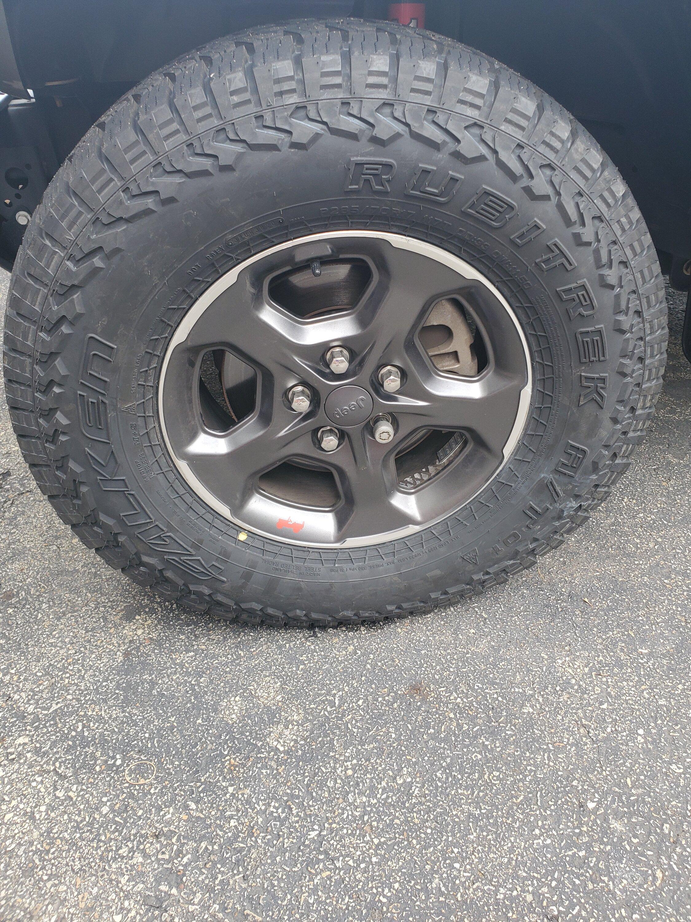

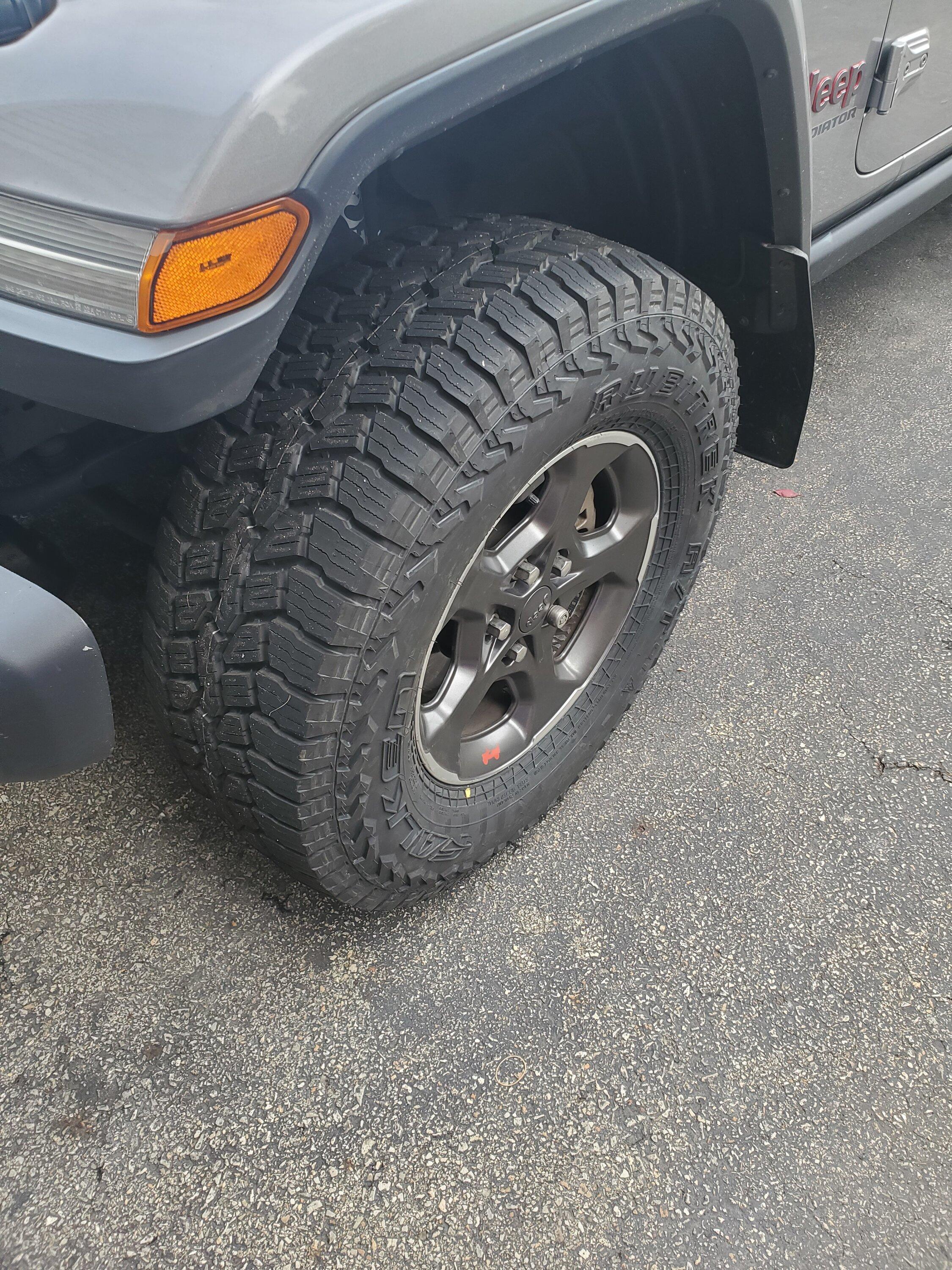

I finally replaced the factory MT tires after they got ridiculously loud. I was specifically shopping for the Falken AT tires since I put them on the wife's JLU and I like them. I couldn't find anyone selling takeoffs or find a decent price from a retailer. In my search I found the Rutitrek AT AT a decent price, about 825.00 for four. I searched for reviews but couldn't find many, but I decided to buy them anyway. They have the same features as the Falken AT but with a different tread pattern in the center. I have a few hundred miles on the now and I'm pleased with them.

Whoever mounted & balanced those tires must have been in a rush. All leftover adhesive from the old stick-on weights should have been removed, and the area where the new weights are applied should have been cleaned with a wax/adhesive remover.
That’s how it is at all discount tire locations

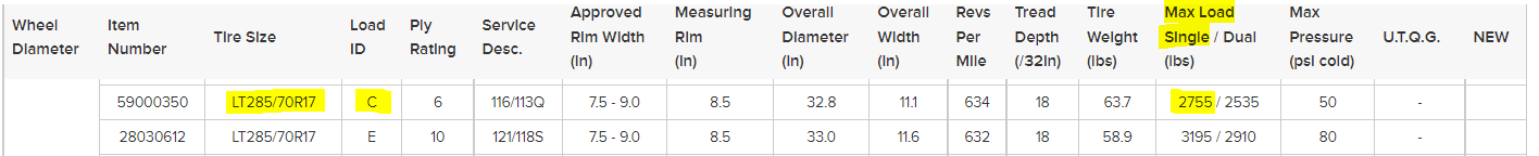

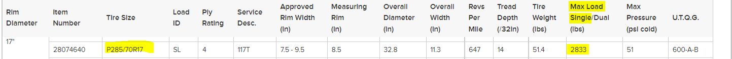

The max load on your Rubitreks say 2833 lbs. The max load on the Wildpeak ATs is 3195.
^^That is for the E Load Range AT3Ws, not the Cs.
The max load for the factory C Load Range AT3W tires is 2755 lbs, which is actually lower than the "P" Rubitrek tires which are 2833 lbs.
From Falken web site for AT3W:

From Falken web sire for Rubitrek:
