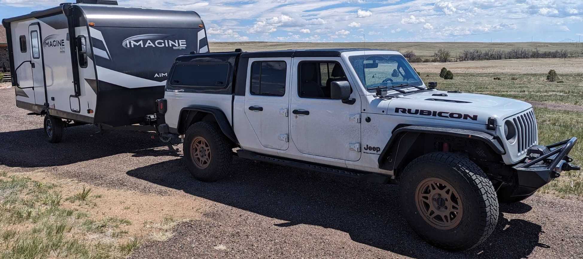

do you have any pictures of this setup?

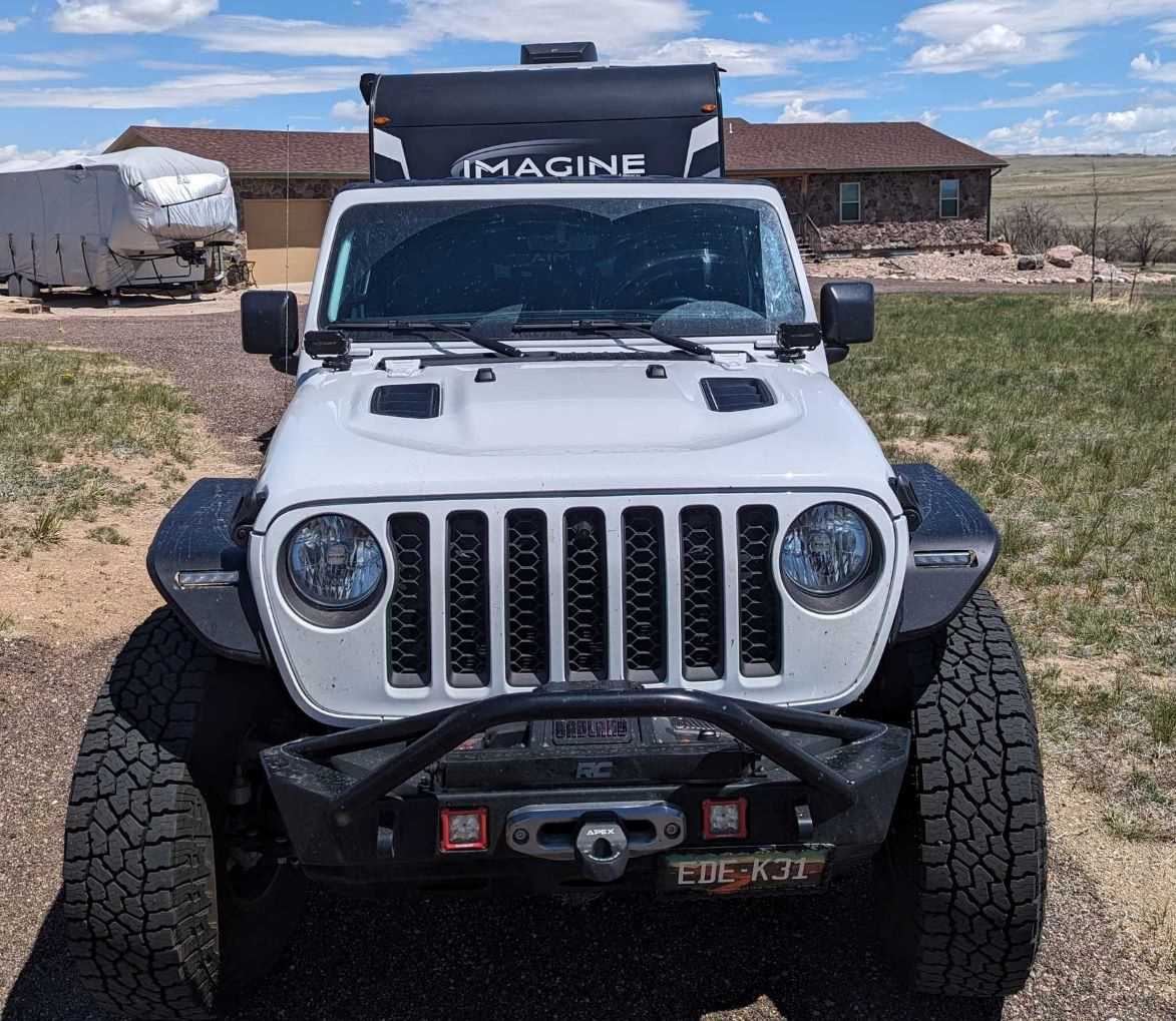

Another
Jeep Gladiator Falken Wildpeak A/T4W | NOW Available at DTC PXL_20240513_200222398

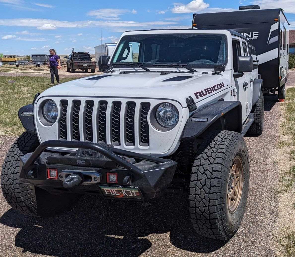

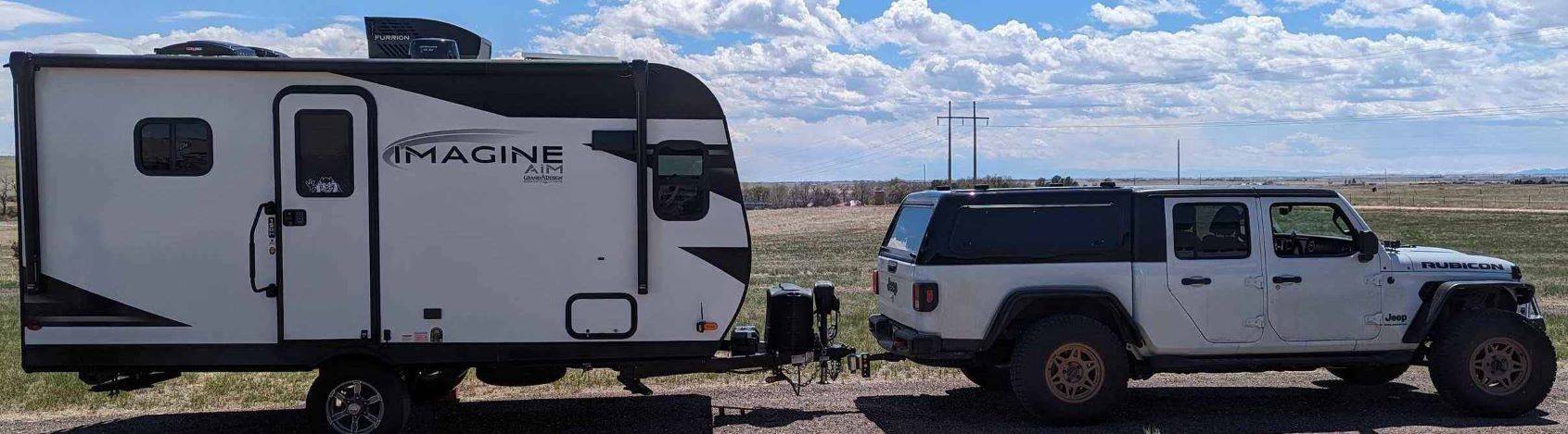

Another
Weight distro not hooked up, just moving it around the house.
Jeep Gladiator Falken Wildpeak A/T4W | NOW Available at DTC PXL_20240513_200201770
