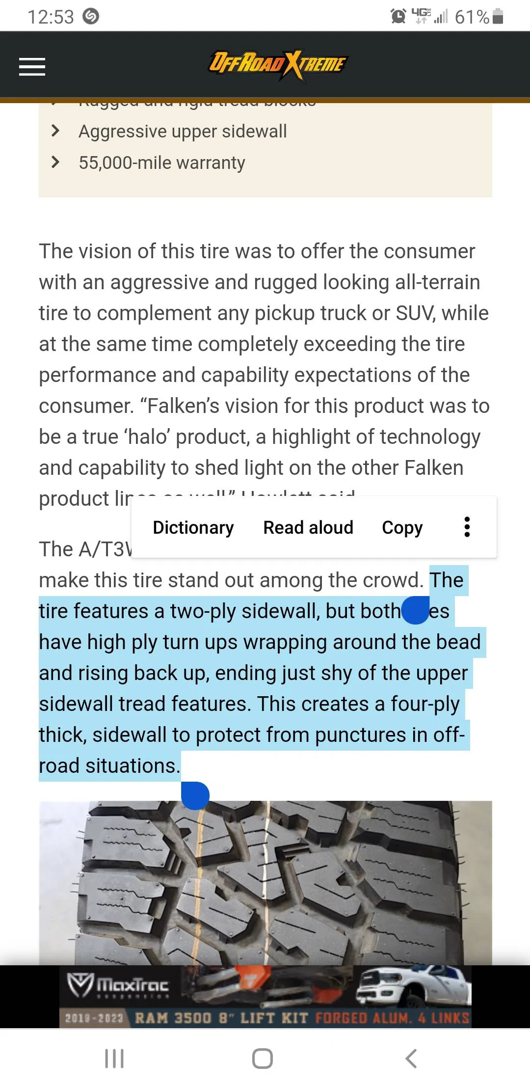

Same construction as at3w with 3ply instead of two? I don't know if this is common or not but the way the at3w is constructed is read below:
Jeep Gladiator Falken Wildpeak A/T4W | NOW Available at DTC Screenshot_20240124-125311_Chrom
