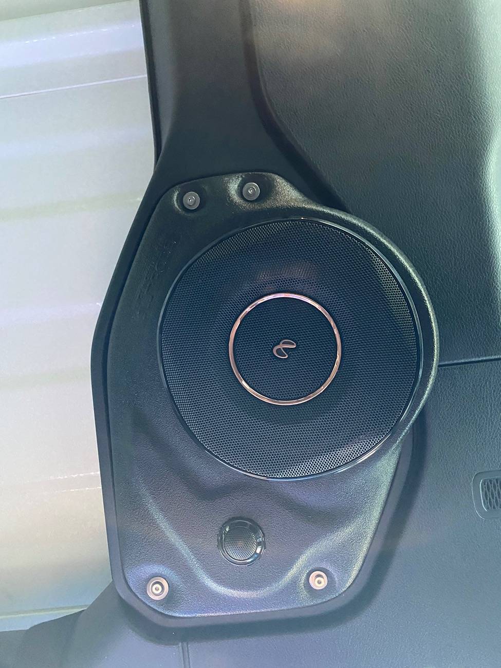

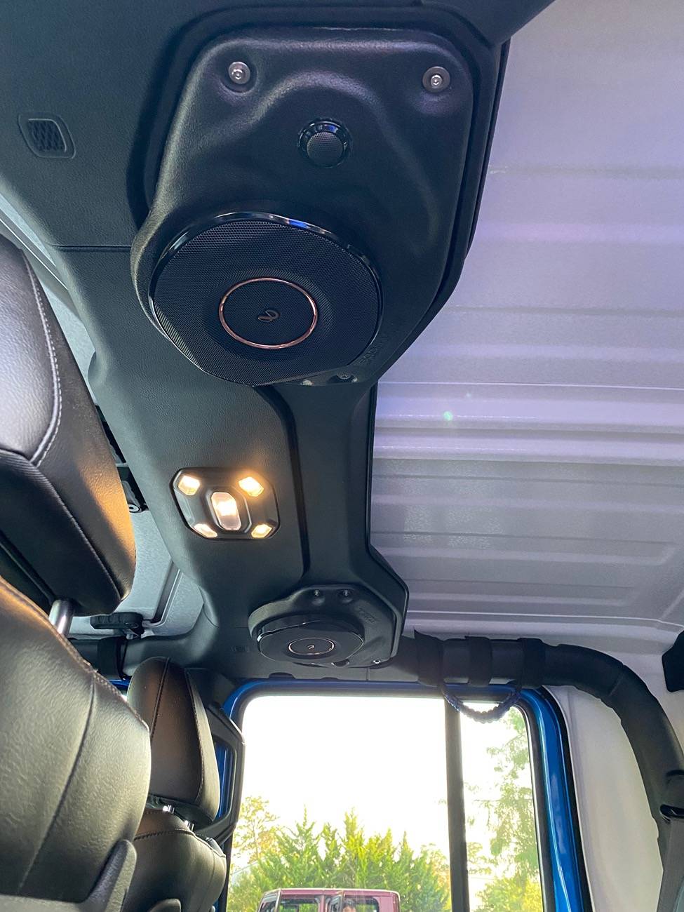

I just got done changing out the soundbar speakers. These are Infinity Reference 607 CF component speakers. I used the JL/JT pods. The beauty of using the pods is that you don’t have to cut your sound bar. I had to cut holes in the pods for the tweeters but the soundbar is still factory fresh. Thanks to Crutchfield, the components plugged directly into the wires from the old speakers. I didn’t have to use the crossovers that came with the 607’s. Huge improvement in sound quality.

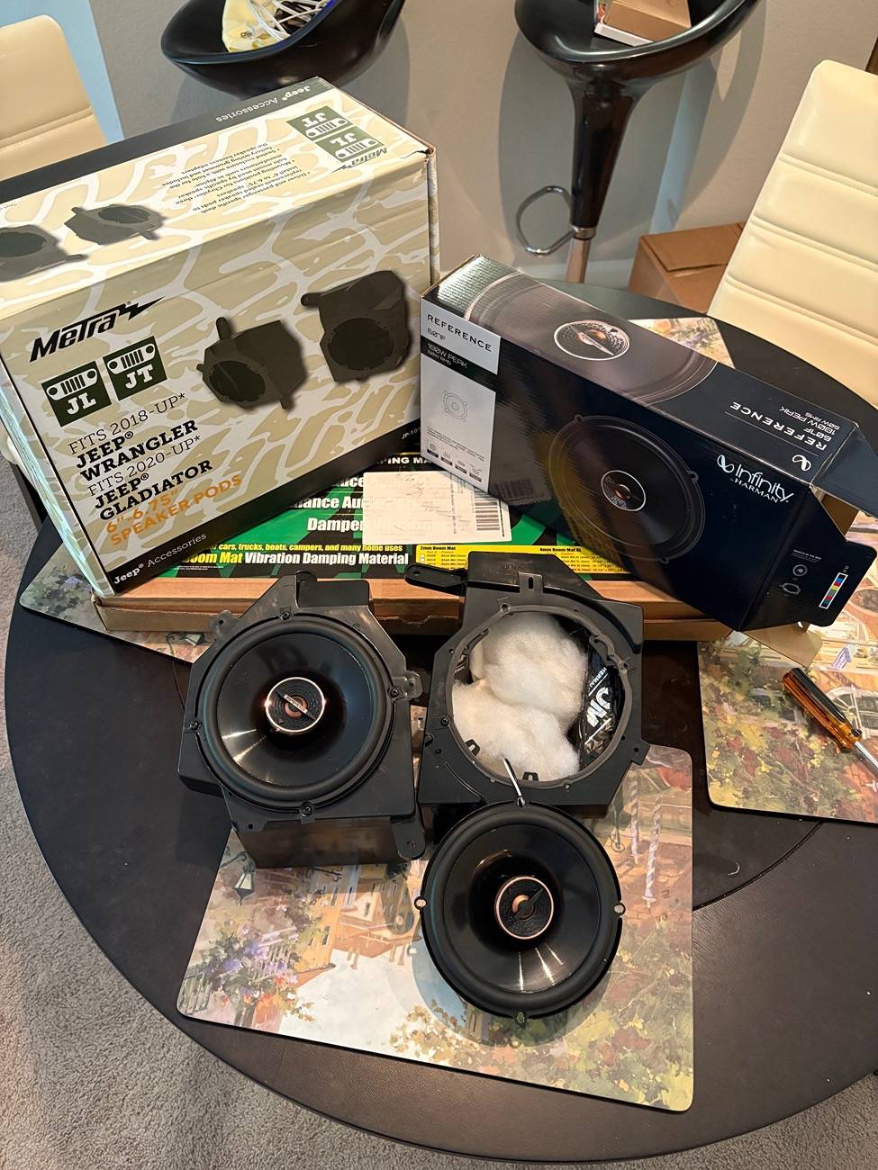

Just did the knee panel upgrade. Infinity reference 607, 2 way 6-1/2” speakers in the Metra pods. It took 5 hours total for the work and my hands are chewed to hell. The pictures I posted are the significant steps. First, when installing the speakers in the pods, sound proof. Also be very cautious of the sheet metal clips. Make sure the screws are actually engaging with the backside. It took me many attempts to get all of them correct.

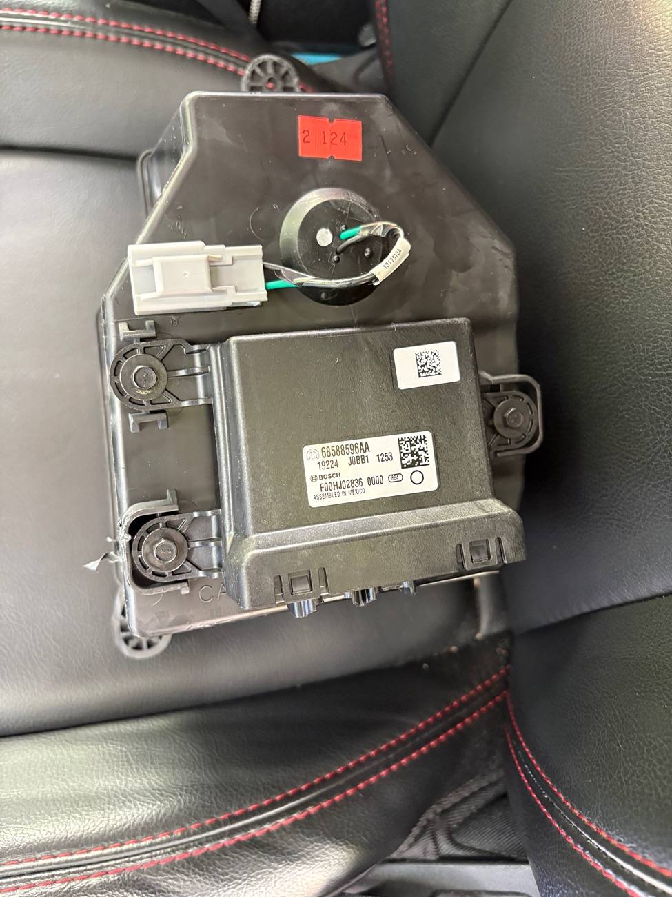

The second picture is an O2 sensor module attached to the drivers side pod. The Crutchfield master sheet didn’t mention this and the YouTube videos just kind of skim over it. The hole in the Metra pod are undersized. You’ll need to run one of the extra speaker screws in just to open them up.

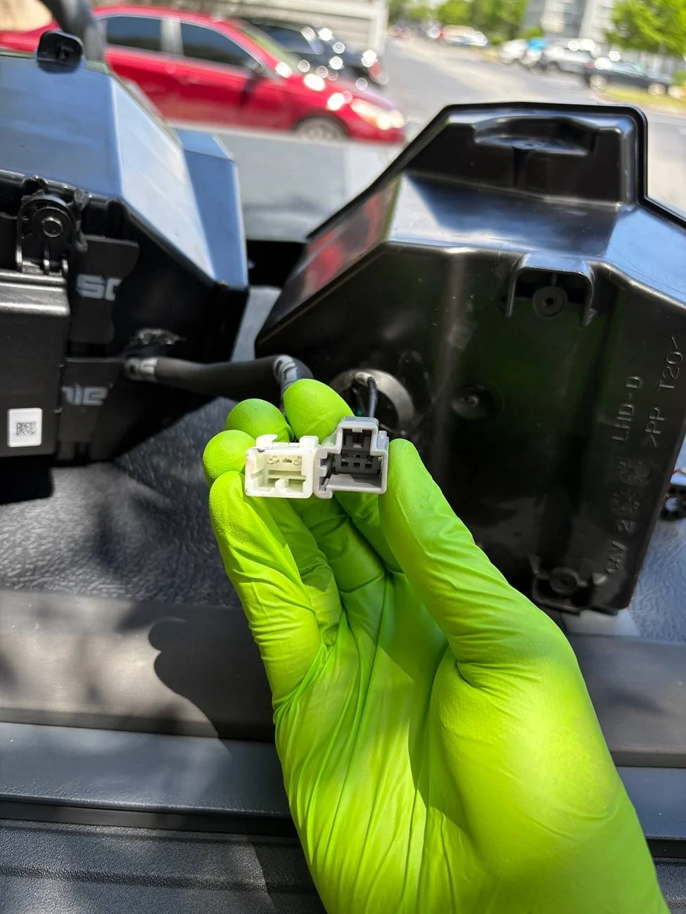

The third picture shows that the plugs are different. There were no instructions about this. I cut off the plug from the old speaker and spliced in on the new speaker wire. The plugs you get from Metra won’t work.
