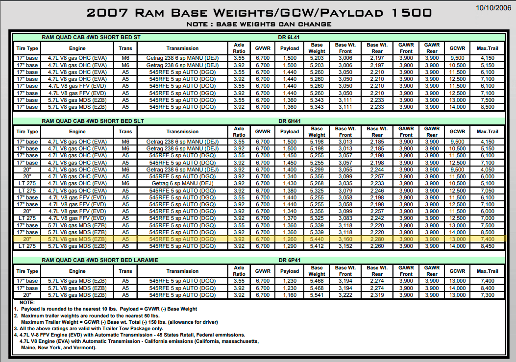

Fair enough. Though since I don't have any work trucks with aftermarket controllers, IDK that those trailer lighting and wiring checks are in place without the OEM controller. I might beg to differ a tiny bit with the max tow package though. I mean, that's aimed squarely at hauling and towing, and in that regard compares quite favorably to my Ram. Actually, it exceeds the Ram in both payload and towing capacity.
Now personally, I don't especially care much about all the fancy electronics, and I'm fine with just a dial for the controller. I'm just surprised that it wasn't integrated like most other oem brake controllers.
I think in the end we're on the same page, just not instantly squaring it in forum posts.
I can see the integration bit about the controller not happening as a standard feature. I can't see it not being an OPTION at least on max tow.
