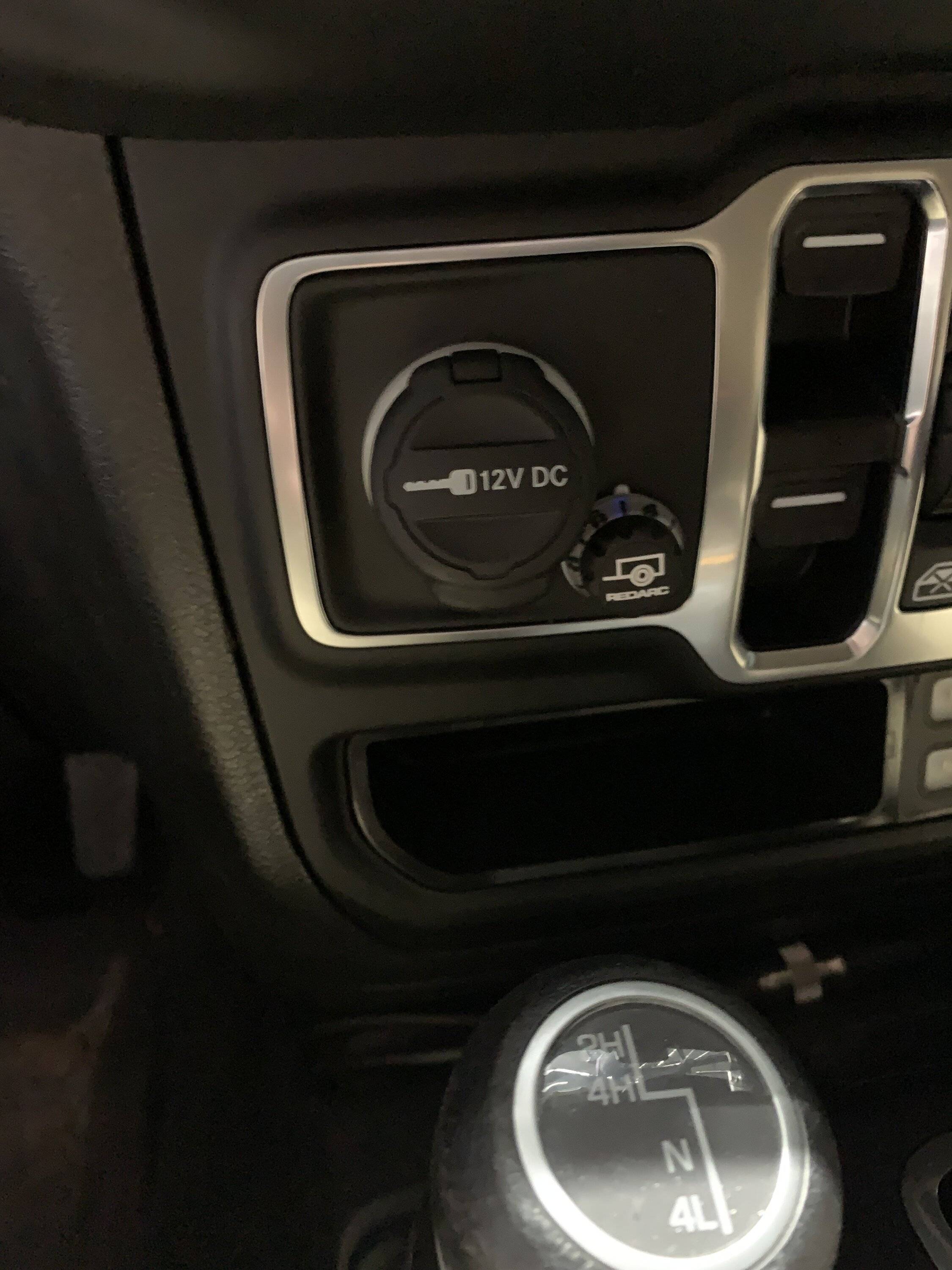

Definitely took the advice here of placing it in a spot that is easy to reach but not easy to accidentally hit. I didn't want to move the 12v outlet and this was as close to the stock location as I could get with out relocating the outlet. I think a pretty good compromise.

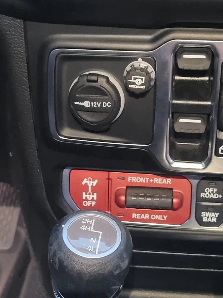

Got my new trailer brake controller installed today. Went with the Redarc Tow Pro Liberty. Big shout out to @RudeJeepin for the mounting idea. I think it came out great!
Jeep Gladiator Trailer Brake Controller Installed - Redarc Tow Pro Liberty tempImagepBKhoD
Turned out geat. Thank for the shout out, but i too borrowed the idea from someone else.
So while I agree about loosing 112v plug if you have stuff plugged into it can you still see your brake button ? Thats the only concern with that location I'd have. I relocated my 12v port but to this point 2 years later have not used it. actually wondering why i moved it..lol
I've towed several times since adding my brake controller and so far I haven't had any issues with using the 12v plug and the controller at the same time.
Before punching the hole, I sat there with the few 12v plugs that I have and made sure it would work out for my needs. I did mount the controller knob in the upper right corner, not sure if it would make a difference or not.
Kinda figured if it was a problem, I could always take the "door" off the 12v plug to make a little more room, but so far not needed.

Did you have to do any dremelling behind the panel to fit the button switch. Its larger than the button but it doesn’t look too big.

Thinking of this also and since I have not removed that panel I was wondering also about having to remove any plastic to make it fit. Any advice would be great

I did have to remove some plastic. In my case it was about a .5 x.5 piece of plastic. When I was looking at mounting points in that area I chose the spot that had the least interference. I cut the plastic tab with a pair of wire cutters (didn't need a dremel). I just had to take a small corner off it.

Ok, thanks. That doesn’t sound too bad.

It's been awhile, but if I remember right, the only "dremel" work was to the section of panel that the 12v plug is in. Atleast I remember thinking that I wasn't doing anything that I could undo if needed.
