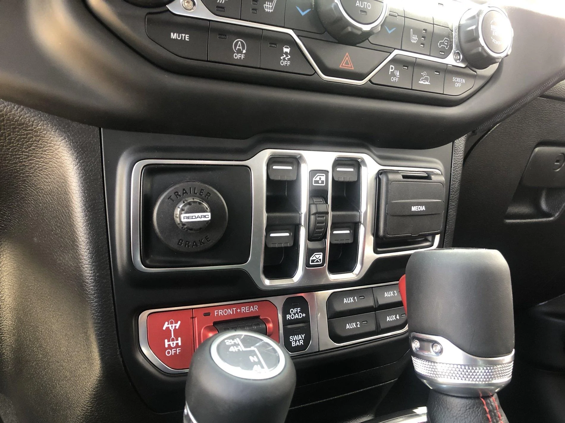

So far I am really liking mine, it seems to operate smoother than the Prodigy P3 in my JKU and the install in the dash makes for a factory look.

Does the brake controller light up when a trailer is not connected?

Hey Nordnded. I know this is old but quick question. When you disconnected the ‘cigarette lighter”, what did you do with the power cable? Did you just secure it inside the dash? I just ordered the Rebarc you utilized and I want to connect it the same way. Thanks for the info you’ve provided us.
KVJ
Kenneth
May 31, 2019
624
773
Trumbull County, Ohio
Sport S W/Max Tow
In case Nordnded dose not get back to you. When I disconnected the cigarette socket from the console, I pulled it over to the passenger's side behind the dash. It will reach and you can access it by removing the glove compartment. I plugged my dash cam 12v adapter into it.

How flush is yours? I noticed I had a gap when I installed the circular trim...

Just hooked mine up. Does it light up at all. I only see the blue light blink once in a while when parking... Havent hooked up a trailer yet...

I also have a small gap but you can’t really see it and I wasn’t going to mess with it anymore after I got it installed. Also, when you connect your trailer, it will light up when you engage your brakes. The harder you apply your brakes, the brighter the light. I’ve towed a 19ft Airstream around Florida with absolutely no issues. The brakes work great.

That’s normal until you hookup the trailer, then the blue light will be on and slowly change to red as the brakes apply.
