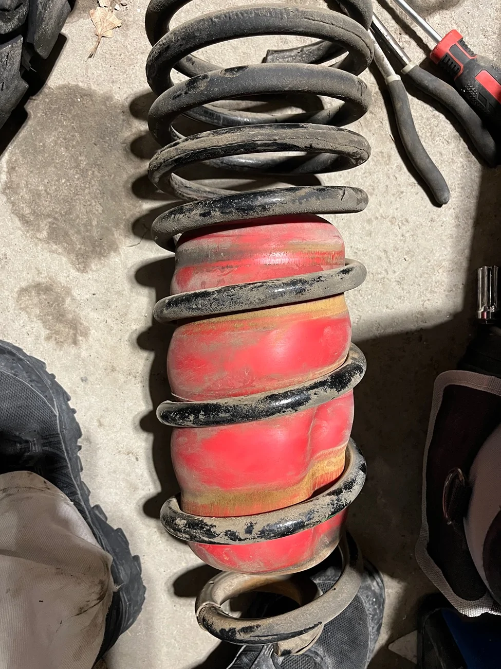

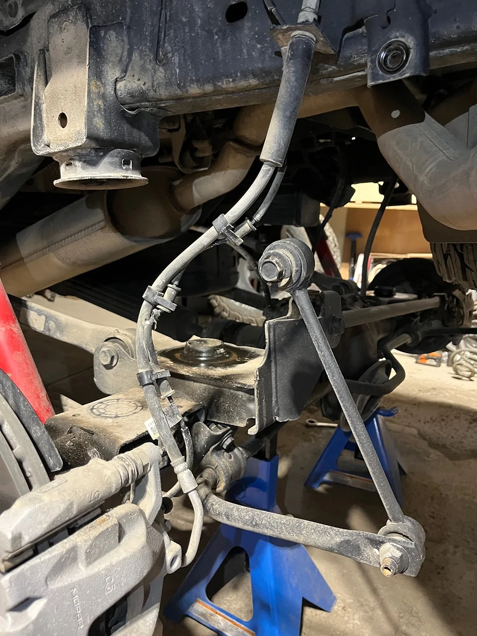

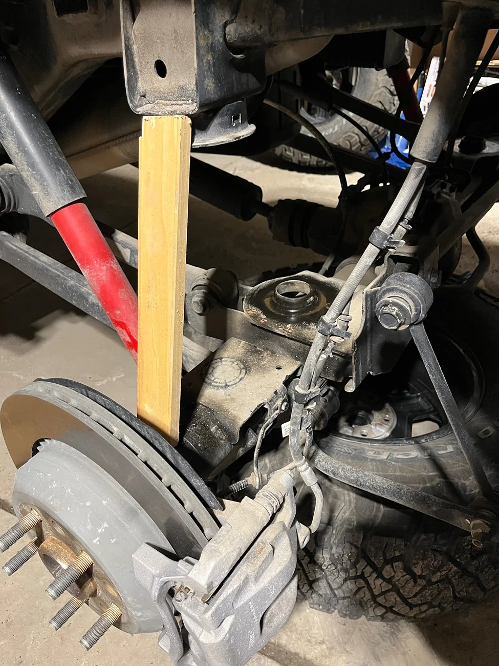

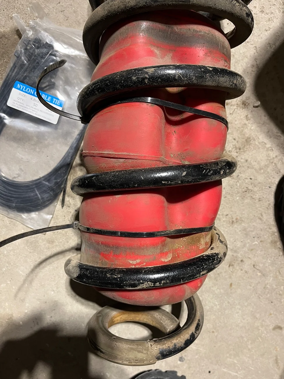

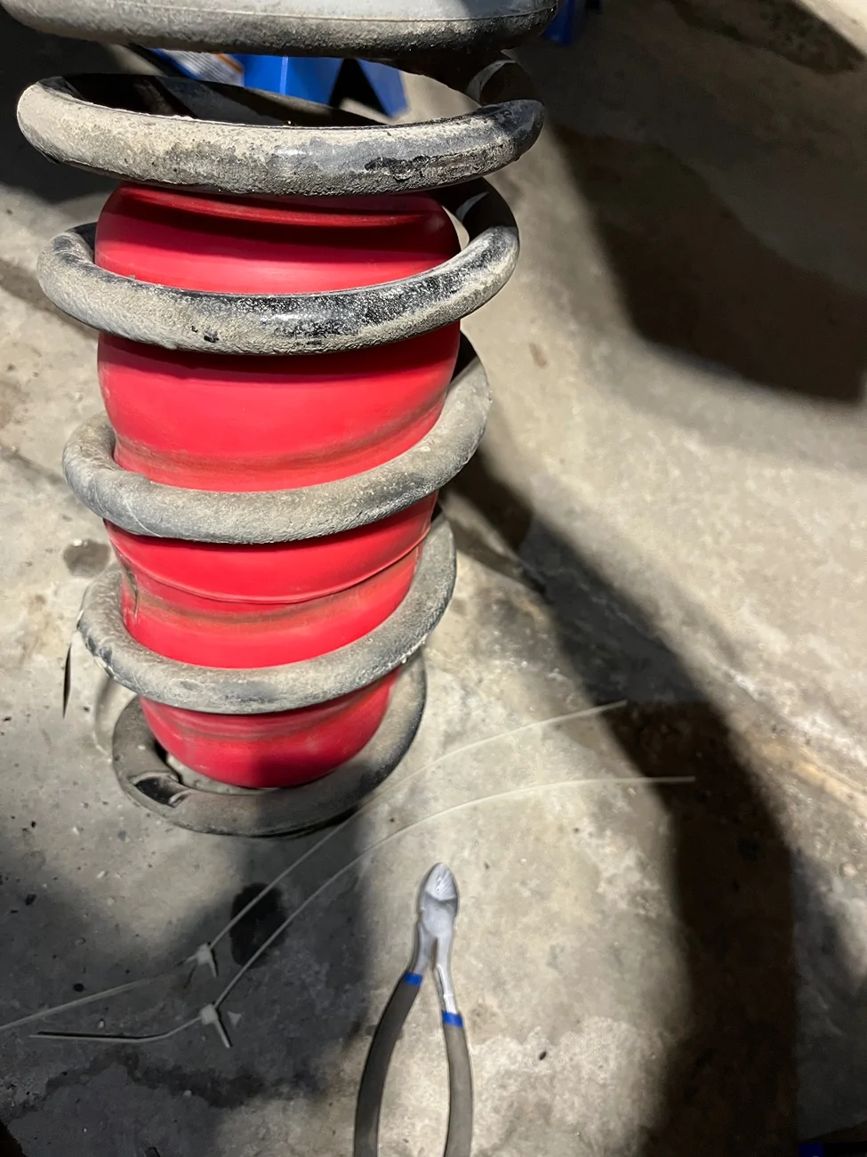

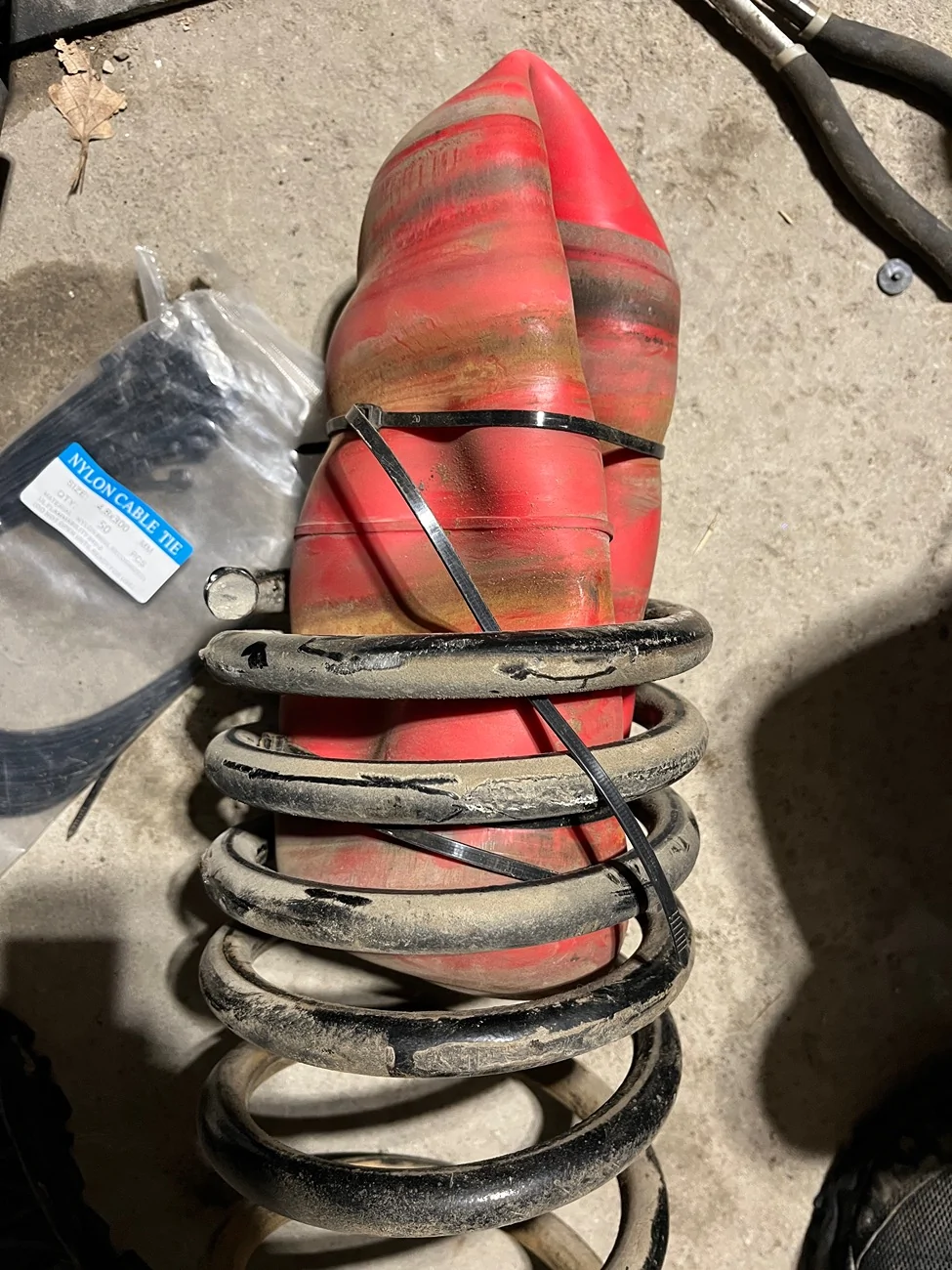

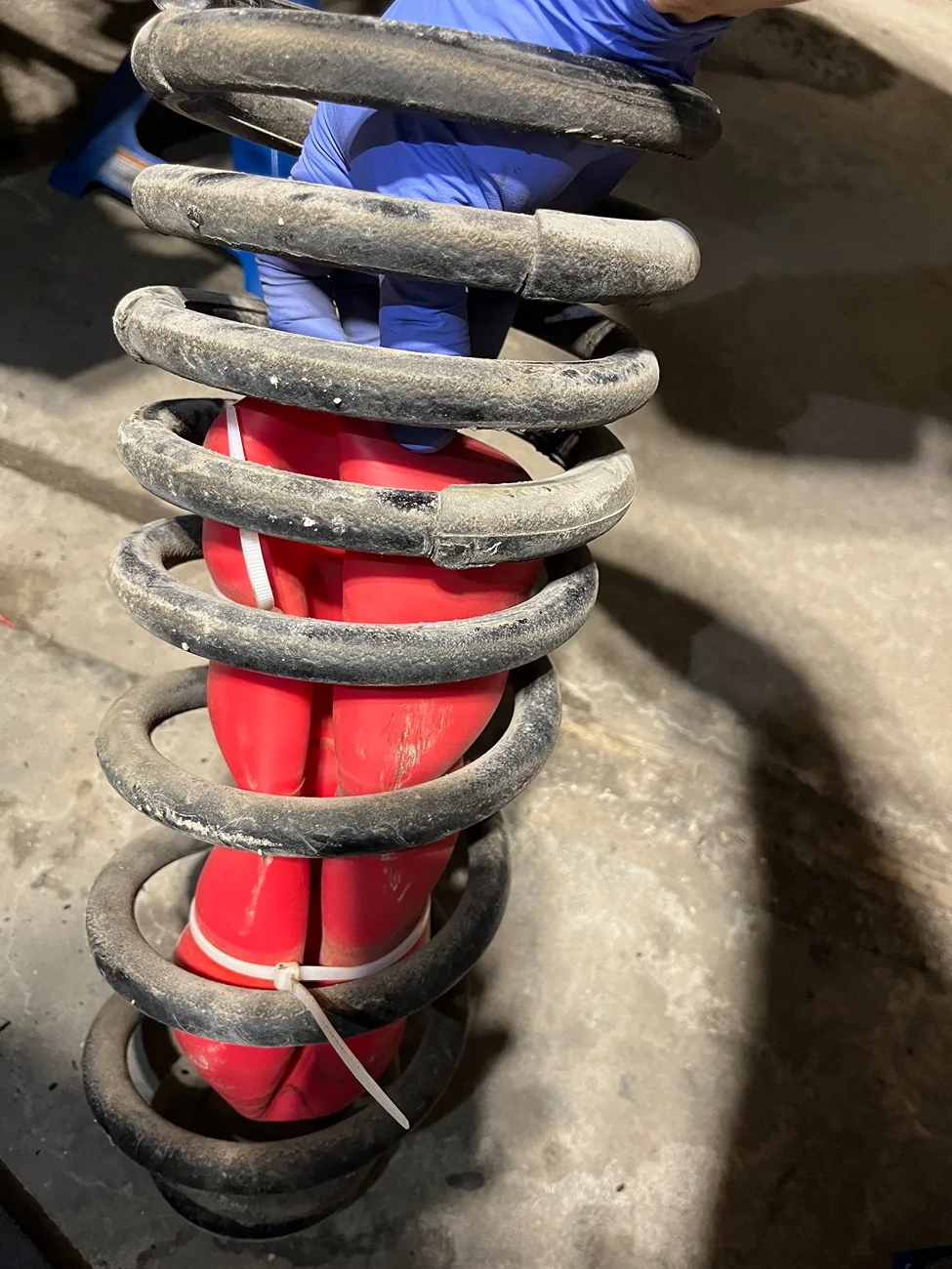

One of those items is the airbags. Here’s a quick “how to” with a couple pics in getting the airbags out of the coils and back in the coils.

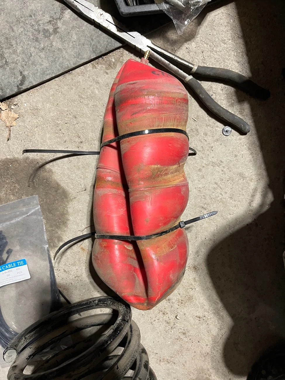

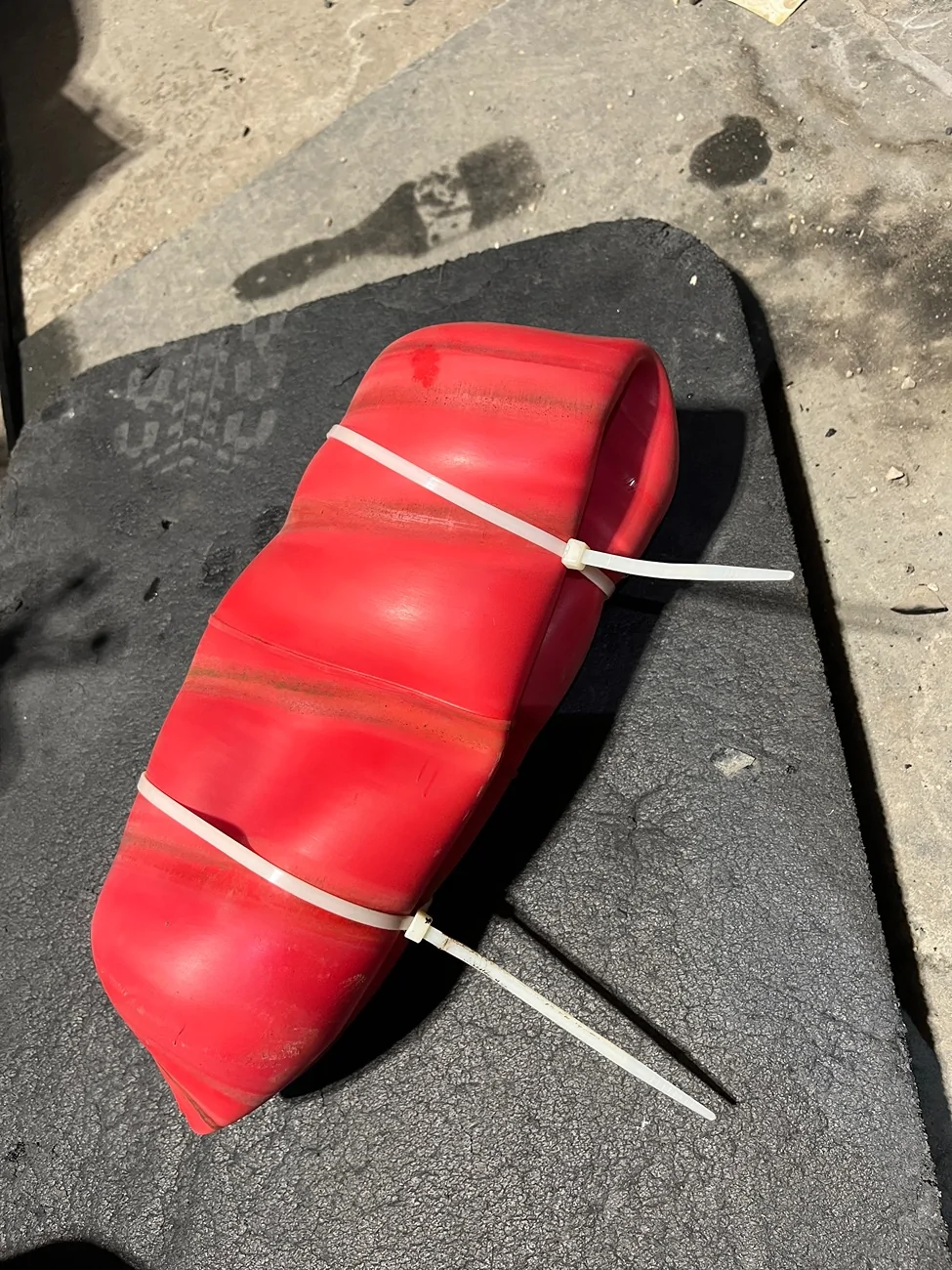

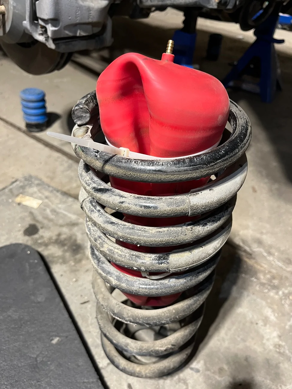

The most important tip I can recommend to getting the bags in or out of the coils is to fold the bags and zip tie them. This is easily done before dropping them down into the coils and just reverse process to get them out for what ever reason.
Trying to force these bags down into the coils not folded and zip tied is just near impossible and will have you cursing the day you thought these bags were a good idea.
