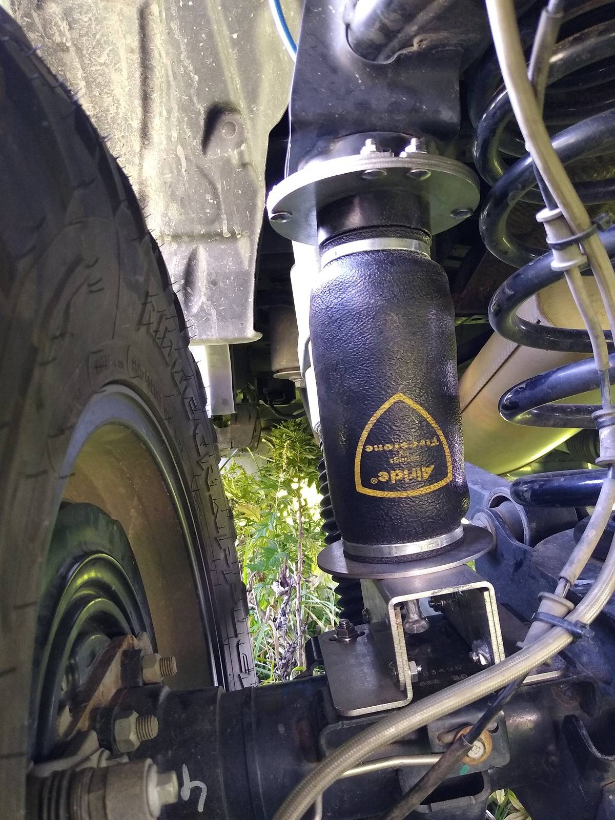

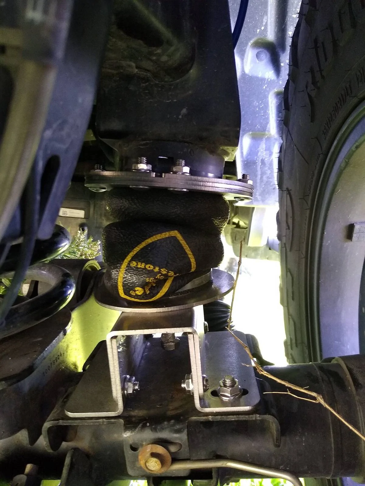

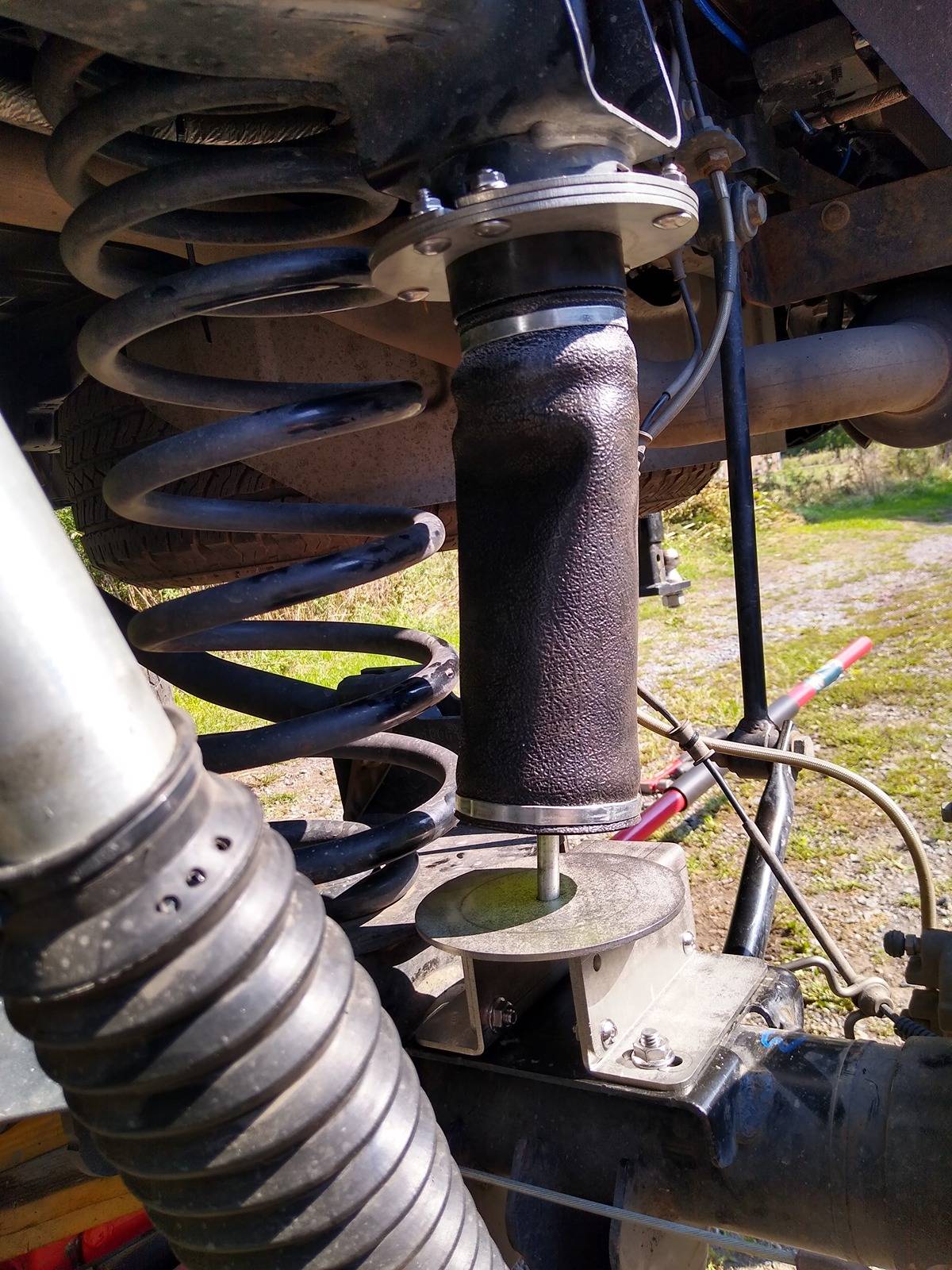

I installed the Air Lift 1000 bags on my stock 2020 Gladiator Mojave. The install was fairly easy. I used a floor lift jack to lift one side rear tire off the ground. Removing the spare tire gives a lot of room to get under the vehicle and work. Lifting one side provided enough clearance between the spring coils to push the bag between the lower coils. I found that heating the bag with hot water and not fully deflating it made the install between the coils easier. Air Lift provides a top cushion but not a bottom cushion. I did not like the idea of the bag contacting the bottom surfaces of the spring mount without a cushion so I re-used my old Firestone RideRite cushions. One could fabricate a bottom cushion out of plastic or rubber and silicone it to the spring bottom seat. The bags seem to work well. 9 lbs of air and about 425 lbs of rear weight (canopy and tools) delivered a somewhat stiffer ride but ok for rough terrain.
