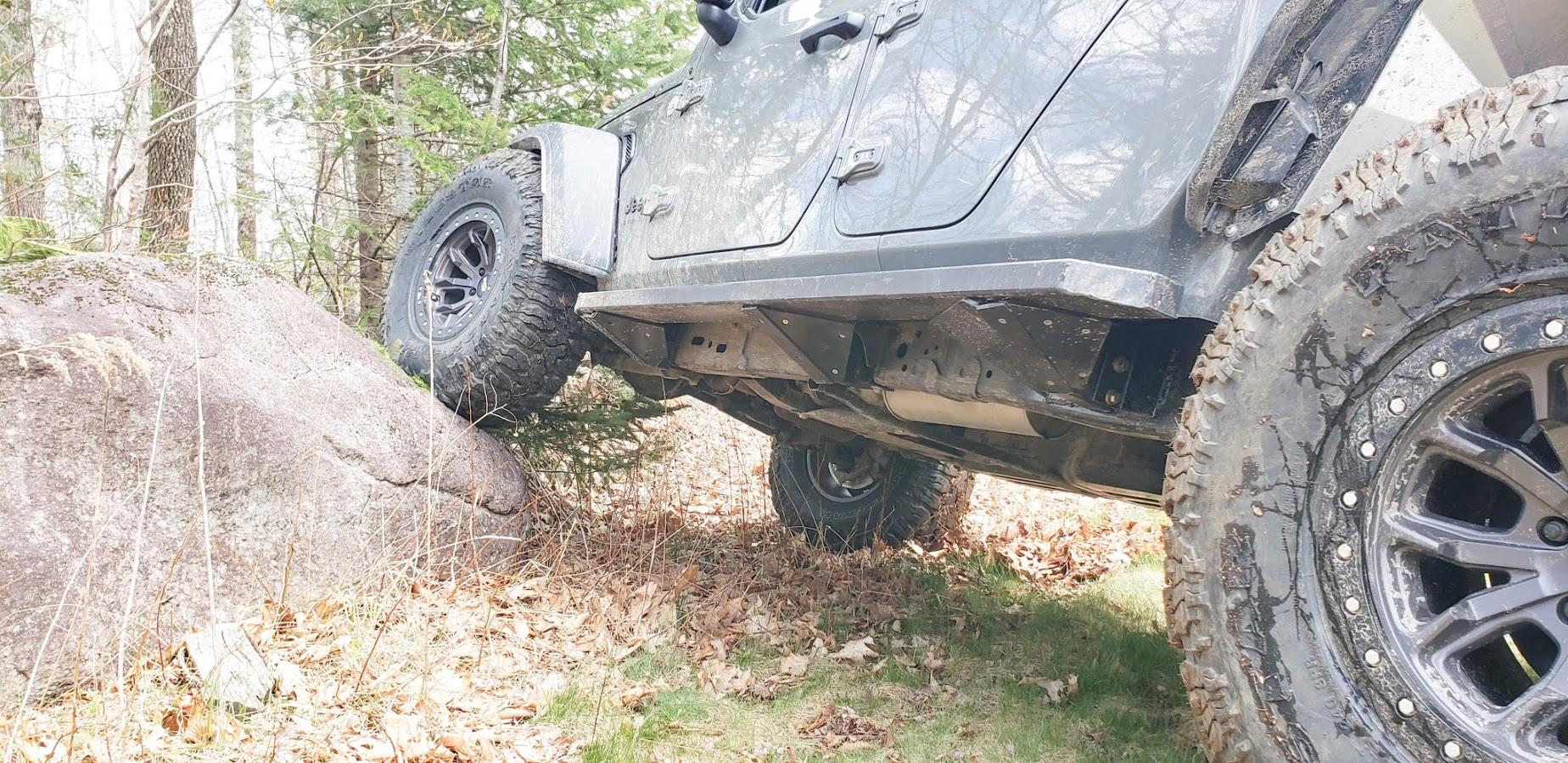

I will see if I can find some better in process pictures tomorrow. I tired the front and the middle to the frame using exsisting hole locations. The Rear was no reall great option so I ended up welding Three Angle pieces onto the frame and made a bolt in location.
I cut the 2X4 3/16 tubing at an angle going back to the frame and reinforce everythig with 11 gage angle gusits.
Then we covered all that UMHW Skid and counter sunk all the bolts. I am going to redo the UMHW to clean it up alittle. Need to buy some more tools first.
We are not sure if we are going to manufacture this or not. Need to see if there is enough intrest. Here is a picture where you can see the frame tie in and the UMHW.

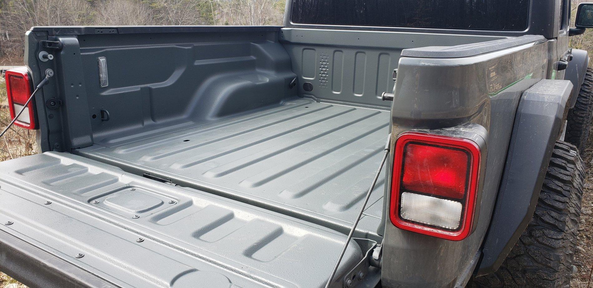

You can barely tell it's bed lined! Great job! :like:
Its held up great so far but we have used this stuff before on our XJ and CJ7. I am tempted to spray my Rock sliders with it.

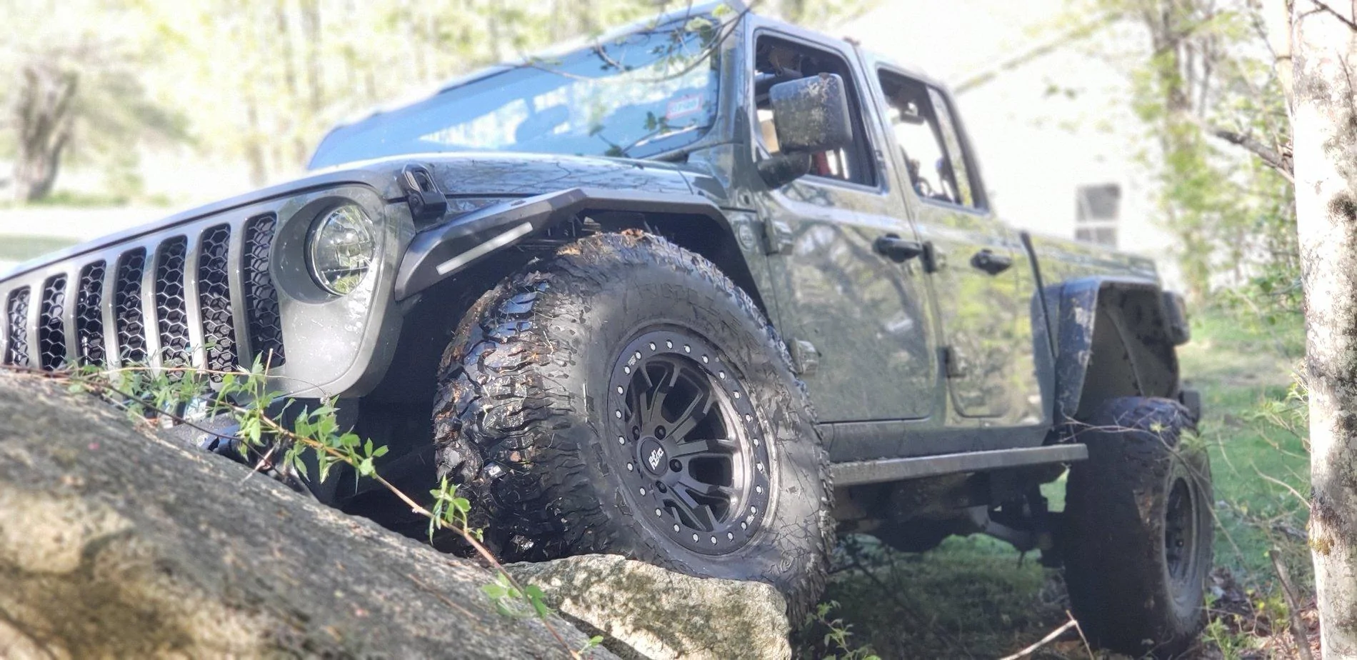

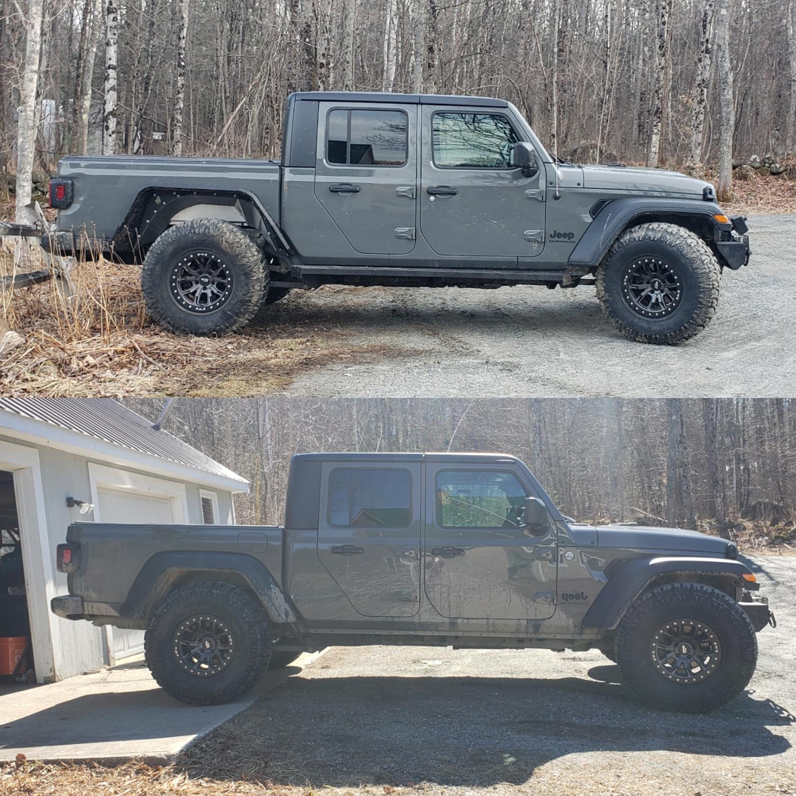

This shot almost makes the back fender look aftermarket hi line?!
Good eye! I am behind on posting this because I am still waiting on the fronts.

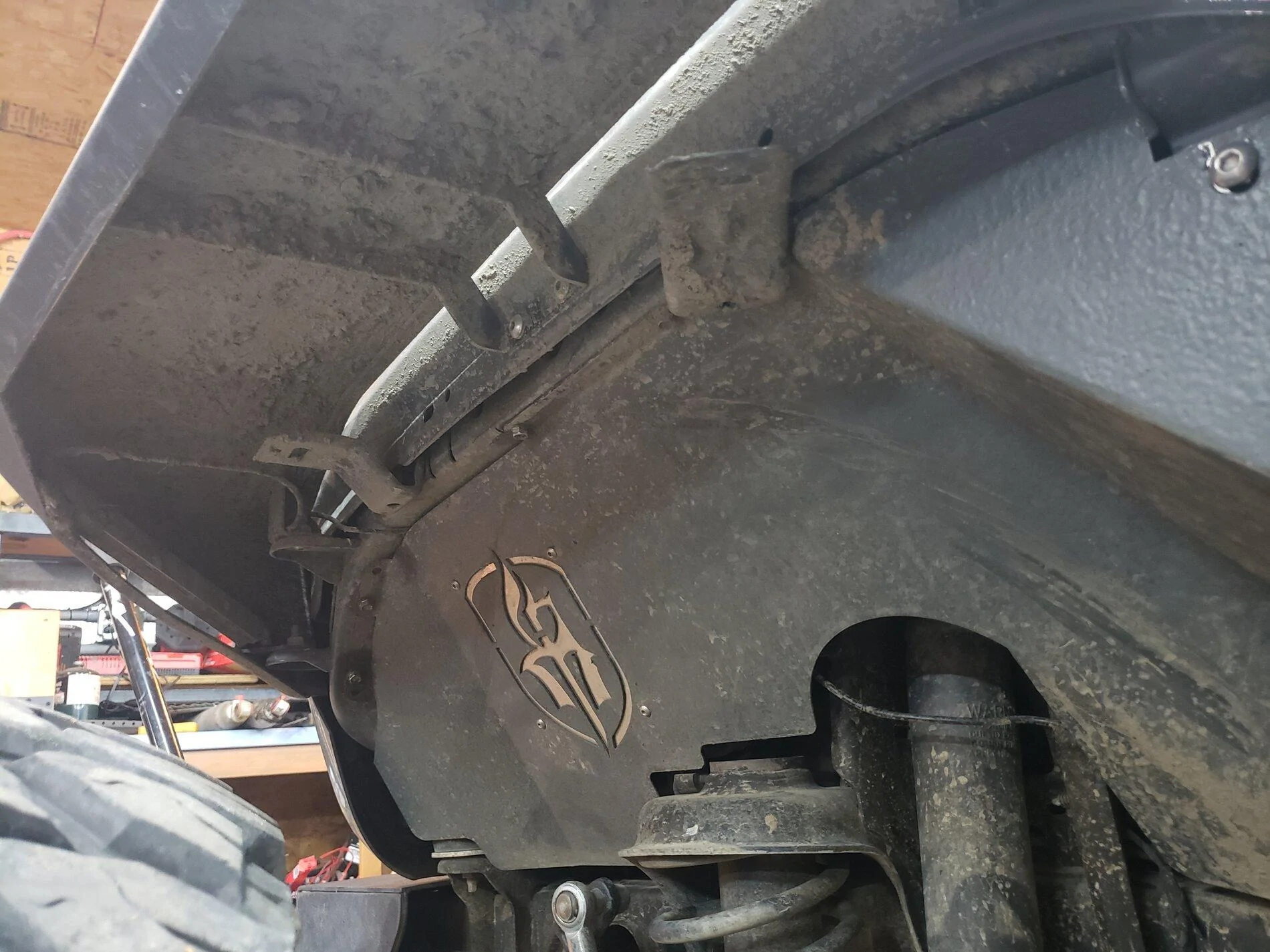

We installed the rear Road Armor Stealth fenders and fender liners

Wow! I might be going the fender route after seeing this! I love the LCOG style builds like I have had in the past. That fender setup was slick. Did it come with the inner fender as a kit? I think I would paint my inners black though.

It does give the 37s some room! This is with no lift.
They do not come as a kit, You have to buy the front and the rears separately same with the liners. But.... they are beefy!!! My plan is to powder coat both inner fenders and my rock sliders once the fronts come in. I might make a new front bumper first.
If your interested we are talking with Road armor on becoming dealers for there products.

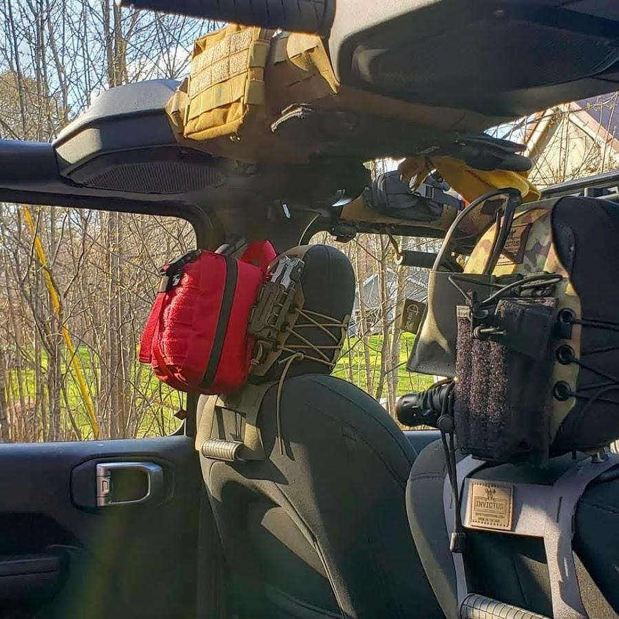

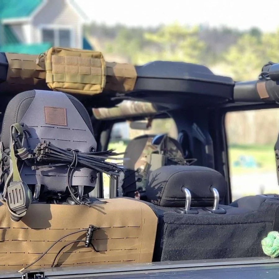

We have also come up with some new products for the center of the roll cage.
This is a great option to locate your gear close and still work with a soft top, Hard top, Sun rider or sun shade.

Jeep Gladiator Invictus Off Road Build 20200922_194001

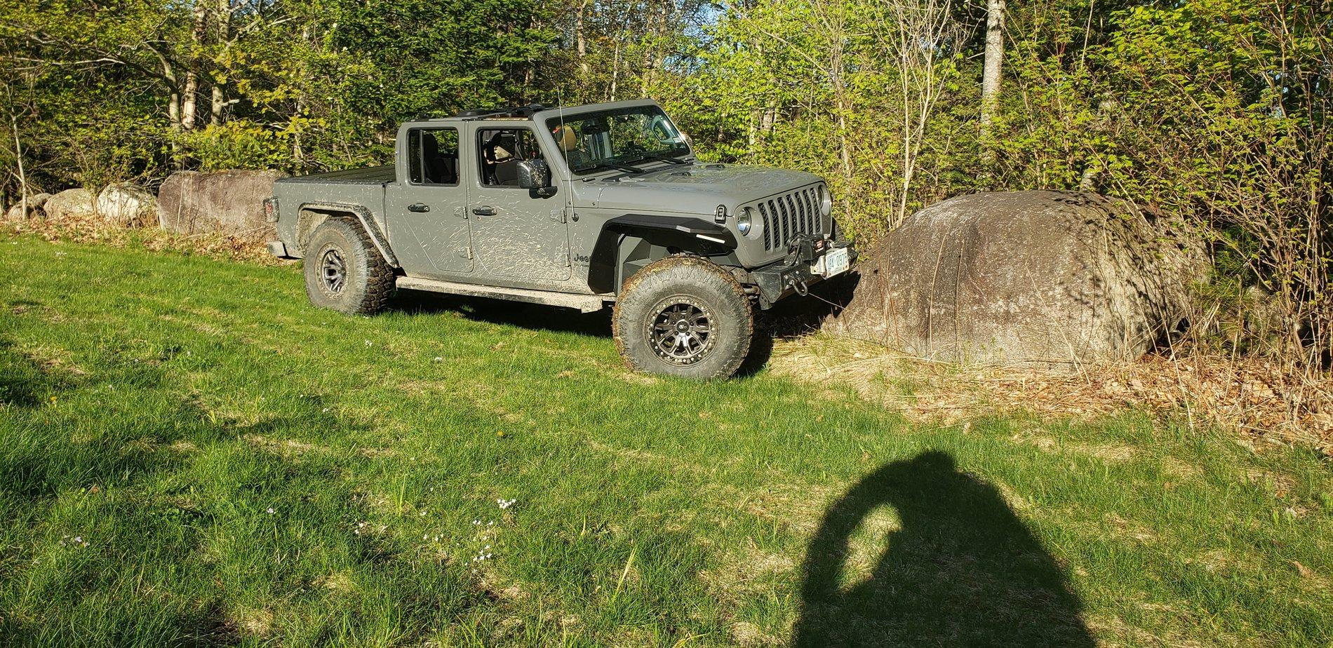

Well we have had the antirock for a while and really started rubbing on the old mounting brackets for the front fenders. We need to either change out the front bump stops or we need to get a lift!
