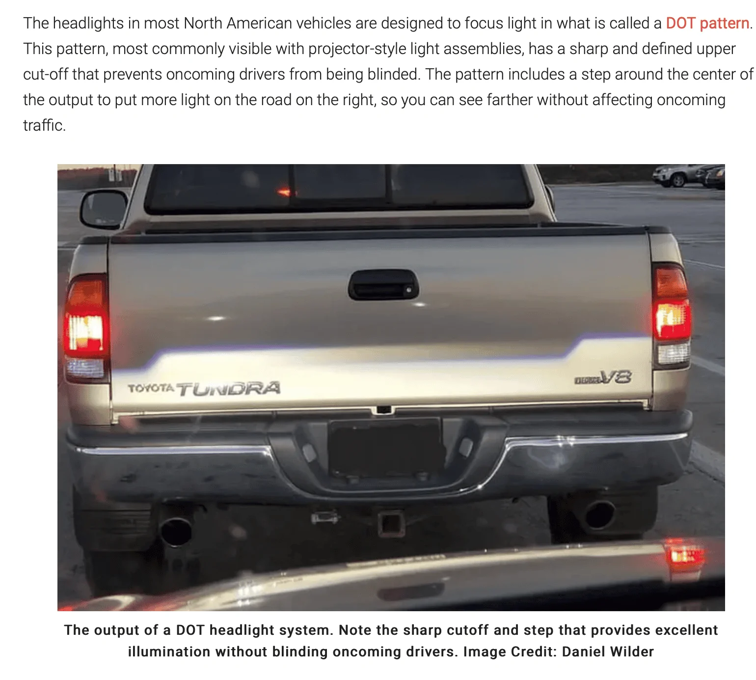

Yes, that is what is referred to as a DOT beam pattern, don't want to flood this thread with jargon but here is a simple explanation of why it looks that way.
Jeep Gladiator Is an uneven pattern normal on aftermarked LED headlights Screen Shot 2021-08-26 at 8.59.08 AM

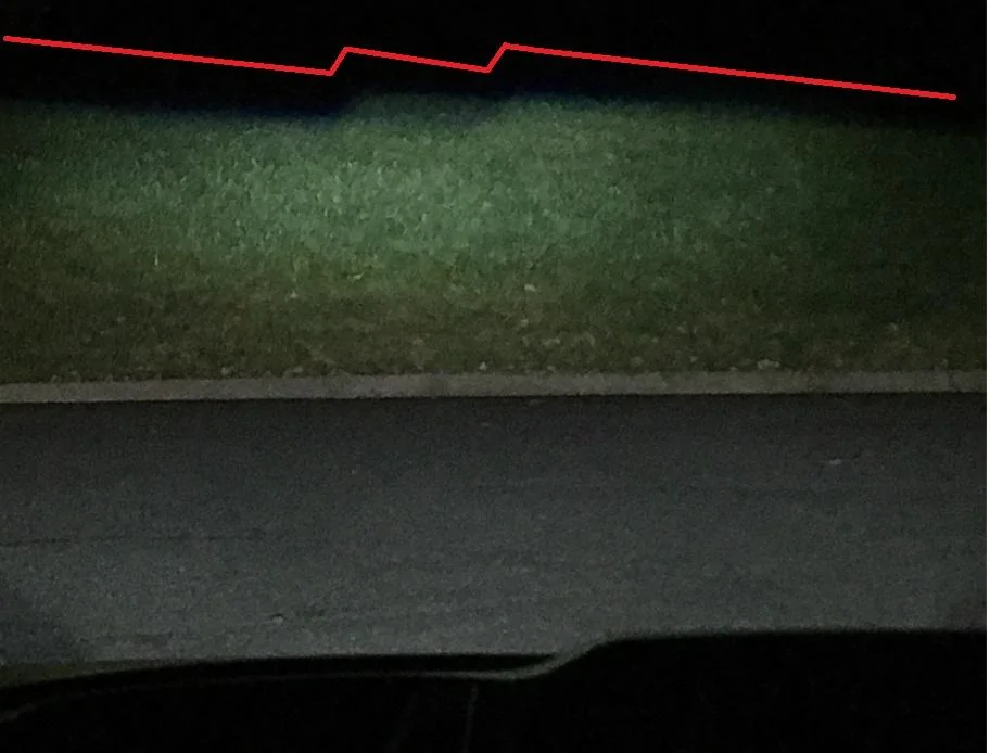

That is by design. You set the lower driver side to be a cutoff that wont disrupt drivers, and the lower passenger to match the upper driver.
Gives you better side road lighting without getting into drivers face. Works well.
Jeep Gladiator Is an uneven pattern normal on aftermarked LED headlights 1629986765556
