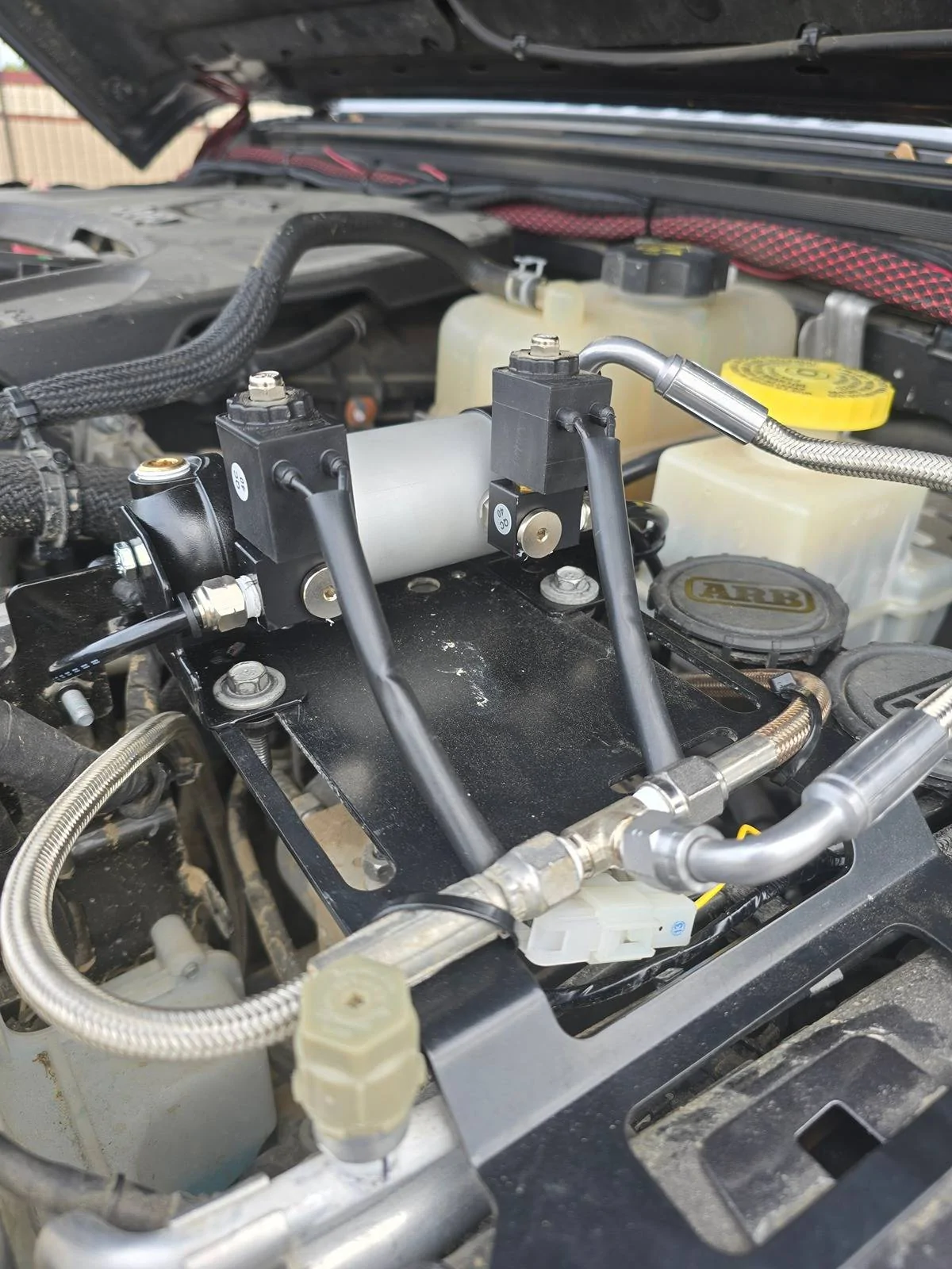

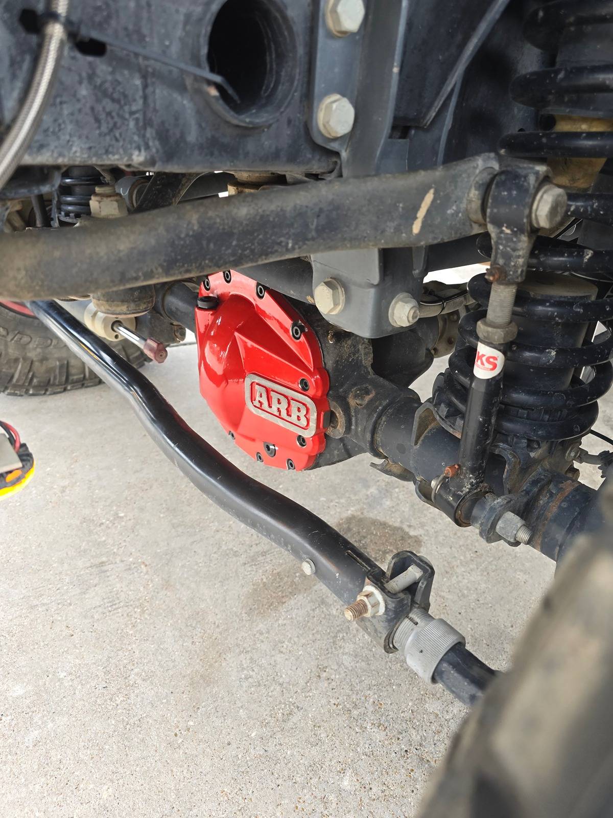

Well for what it's worth and all the great advice/conversations my comment sparked. I finally got them installed.
I realize this thread is bigger than my original post, but I thought I would share :)
I also had 5.13 gears installed and just because no one wants to spend that sort of money and not have anything visual to show for it, I also got the Diff covers to match.
I think at its root, my desire to get the lockers was a combination of curiosity and maybe a little Rubicon envy?
I had Elevation Jeeps in Houston do it and I'm very pleased with the install. very clean. we discussed beforehand and I suggested the mounting bracket that I wasn't using for the Compressor to mount the manifold. They loved the idea and went with it. the result is something easy to maintain and service if the need comes up. plus, it's up and out of the way.
