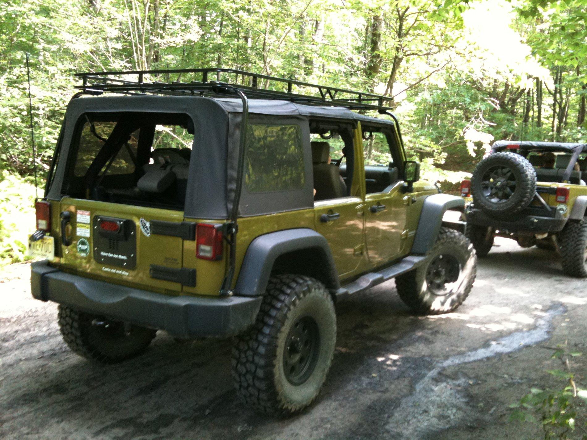

I have a JK with only the soft top and half doors (the upper door halves are fabric like the soft top... you zipper your plastic windows to open and close) for 10 years now...
In NJ with below freezing and snow... no problem!
- With half doors the only glass window is the front windshield. All other plastic windows don’t get ice buildup in winter!!! In the morning only need to clear ice from front windshield.
- Once engine warm, heater is strong and never felt cold or that heat leaks. I have to lower the heat as it gets too hot in the Jeep.
- Never had water leak in from the outside for 10 years
- I like how the engine stays warm even after getting back to the Jeep after sitting in a restaurant for an hour in the winter. Heater ready to go right away.
- Cloth seats don’t become freezing cold like leather seats when you get in, in the morning.
- The cloth seats have some sort of water resistant treatment, even after 10 years, that really works very well to protect from rain or spills. Of course if it pours they get soaking wet, but after a day in the sun with Jeep open they dry up. And any rain that accumulates in the floor can be drained via the floor plugs. If you leave Jeep open in rain of course.

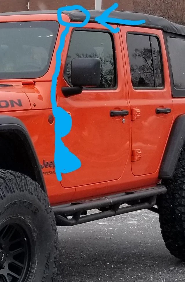

It was parked outside all winter due to not fitting in my garages. The Jeep lifted on 40s was too tall.
There is a design flaw. The soft top rails that run the length of the roof end/line up perfectly with the front door gaps. Water runs from these rails straight into the door gaps and collects in the door limiters. Once the jeep cools down, or the temperature drops, the water freezes. This prevents you from being able to open your front doors. Multiple times this winter, I came out to the jeep to find I couldn't open the doors, which resulted in me taking another vehicle...

That's a significant design flaw.
