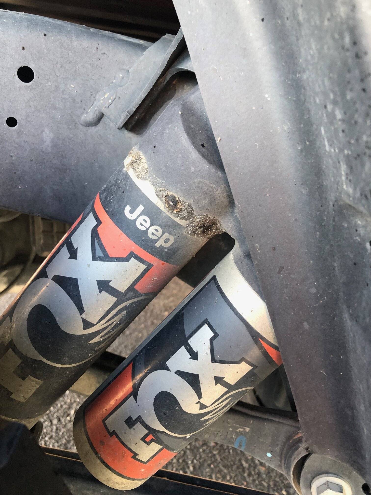

I'm close to buying a 2021 Mojave for sale near me, but I'm wary of having to spend money replacing shocks right away. This right rear shock has some buildup around the top that feels like tar. I'm not sure if it's just road debris that didn't get washed off, or if there's oil leaking there and attracting dirt. I can scrape it off with my fingernail. Other shock leaks I've seen, including ones on this forum, are usually down around the piston, so maybe this is nothing to worry about.
Jeep Gladiator Is this shock condition a concern? (Looking to purchase) IMG_8359
Another thing that concerns me a little is that the dealer says they replaced the right rear spring (although it doesn't look new to me). It just makes me look more carefully at the shock on that wheel than I might otherwise.
What do you think? Dirt? Small leak not to worry about? Indicates suspect use, and run away? I know I'll end up spending a lot of money on the Jeep anyway; just trying to pick a good one to bet on. I don't even mind the money too much, but I don't want to get caught without replacement parts available. I like the vehicle other than this shock.

Something has been leaking there. Mojave shocks have been a point of contention for a few with many needing replacement with under 50K miles. Dealer OEM replacements are expensive and lead times usually long.
I would look at it with the expectation it is probably bad and would adjust my decision making to account for it.

@Hootbro Thanks for your input. After going back and forth and doing more research, we decided to pass on this one and look for one with a little less wear and tear.
The dealer service team said they think this shock was previously leaking and had been sealed. That didn't make me super confident. I'd rather take a chance on a used Jeep that I don't already know has some issues.

A leak repaired shock and replaced spring? Perhaps the previous owner has been taking ‘er off some sweet jumps. Good call, walking away.
