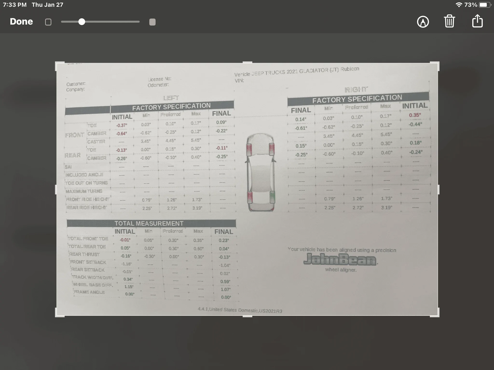

I just installed a lift and this is the Alignment report that was given to me. Is this correct?

What lift? Makes a difference what parts were used as some offer more adjustability.

+1 what lift.
Solid axles front and rear means there isn't much adjustability, but an aftermarket lift could mean adjustable control arms or track bars.

So, they just changed the toe to zero. The caster around 5deg is good for highway. Camber is way out.
Was this alignment from a separate shop, or just part of the lift install? They corrected the steering being off-center. I doubt they touched the caster. The camber issue isn't from the lift, so if an alignment was part of the install, I would say it's fair. there are camber sleeves involved in fixing that. If this was a full alignment performed by a 2nd shop, ask if it was supposed to include a camber correction, and your's is way out.

If this was a TJ, (and the suspension setup is fairly similar), you need adjustable control arms to fix the castor and judging by the fact that front camber is out in the same direction (right tire leaning left and left tire leaning left) you probably need an adjustable track bar. The track bar being too short can do this wacky thing with the measurements.

What's wrong with the caster? The only thing that's jacked is the camber, and the only way to get that is camber bushings.
Ideally you'd like the caster higher, higher than 6 degrees will give you better return to center and highway handling. Did you get adjustable LCAs? If not, you should at least get the mopar lift LCAs
I agree. Caster is low. You can go half a turn to one turn longer on the lowers and half a turn or one turn shorter on the uppers. This will give you a better ride.
5deg is spec, so there's not much to complain about what the shop did there. Did I miss where the OP talked about how the adjusters were set? Sure, more caster will have more on-center feel, but I'm not sure if I'd go throwing parts at 1deg of caster before the camber is fixed. Until then, expect banana handling.
1 degree of caster makes a big difference in these jeeps, it's all over the forum. Spec is low from the get go. Adding $70 mopar lift LCAs is a good way to do it. It definitely wouldn't hurt.

The Jeep JT specs are a joke, 4.5 deg +/- 1.0 degree is in spec.
The YJ spec says 7.0 to 8.0 and my '93 is in spec, not sure WHAT precisely though, and it steers a whole lot straighter than my '20 JTR when I picked it up from the dealer.

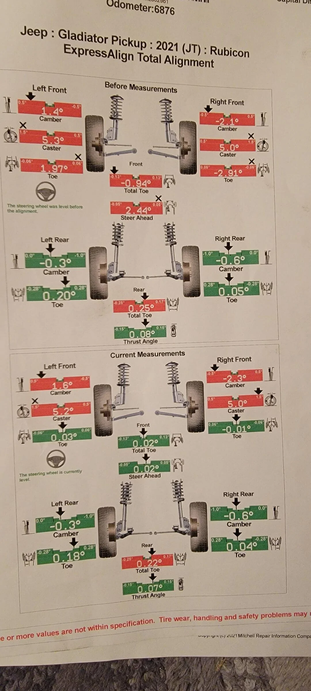

It was the Clayton Off-road Jeep Gladiator 2.5” Ride Right + Lift Kit originally but I also purchased LCA Front and Rear and Fox 2.0 Shocks . I had a different garage do another alignment but I’m still getting a vibration in the front. I think it’s coming from the driver’s side but I’m not sure. I attached a copy of the new alignment
