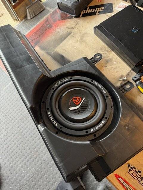

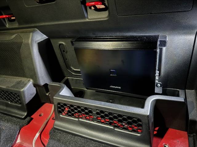

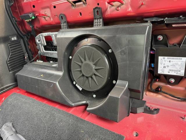

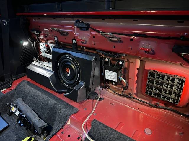

Does the audio control LC2i boost the low frequencies back that are tuned out by the factory amp? I figured you'd need an actual DSP to start with a neutered signal and get good lows?
Short answer, yes.
The LC2i, is a compact, two-channel processor with active input circuitry, which allows it to accept speaker-level signals of up to 400 watts per channel from factory-installed source units or amplifiers. It converts them to high-quality pre-amp signals that can then be directed to after-market processors and/or amplifiers. Users can enjoy maximum sound quality while maintaining the use of factory volume and steering wheel controls.
features
  • Two channels of Active speaker level inputs – Accept 400 watt signals per channel
  • Fixed and variable outputs with discrete level controls
  • AccuBASS® processing for correction of bass roll-off
  • GTOTM Signal Sensing
  • Input For Optional Remote Level Control
  • Compact design
Camaroboi13
Aug 22, 2022
1,810
2,901
SoCal
LEO - Life in Chino
Also, for those wondering, the LC2i can also bet setup to turn the amp on via its own remote power wire so that you don’t have to find a 12v ignition source for your remote. I don’t remember if that’s only on the LC2i Pro or if it’s on the standard one as well. You’ll have to do some research on that. I can’t remember which model I have, I purchased it back in 2017 for a different vehicle and used it for the JT

Interesting so I can probably use a JL audio LOC22
