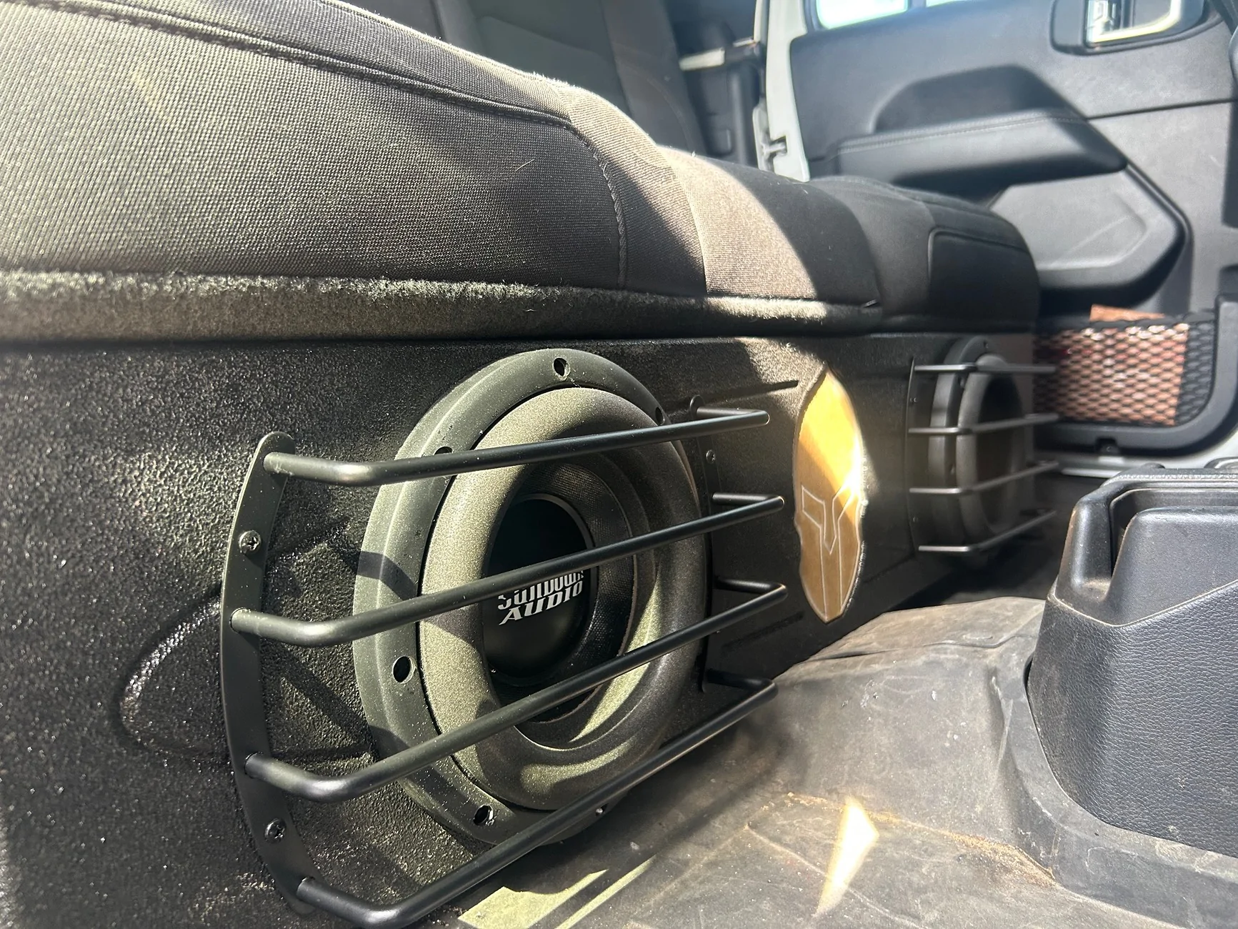

8”. 10” would fit if you can find 2.5” mounting depth. It’s a small enclosure for a 10” but could be doable with a custom mounting ring to raise it up. I used weatherstripping to raise this one about 3/8”.
So my 8” sub with 6.6” mounting depth ain’t fitting back there lol. One of these days I’ll get around to building a box, not today. Good job on keeping everything nice and tucked away.

@93civej1 yes, it’s very much possible. I have these 8s running on 1400rms and still have the factory Alpine hooked up.
Jeep Gladiator It can be done! (Alpine premium sub upgrade) IMG_9424
